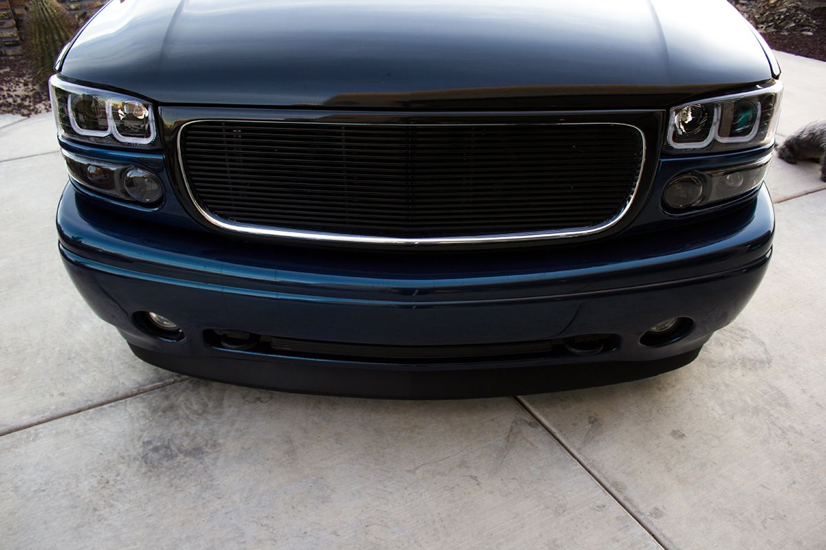

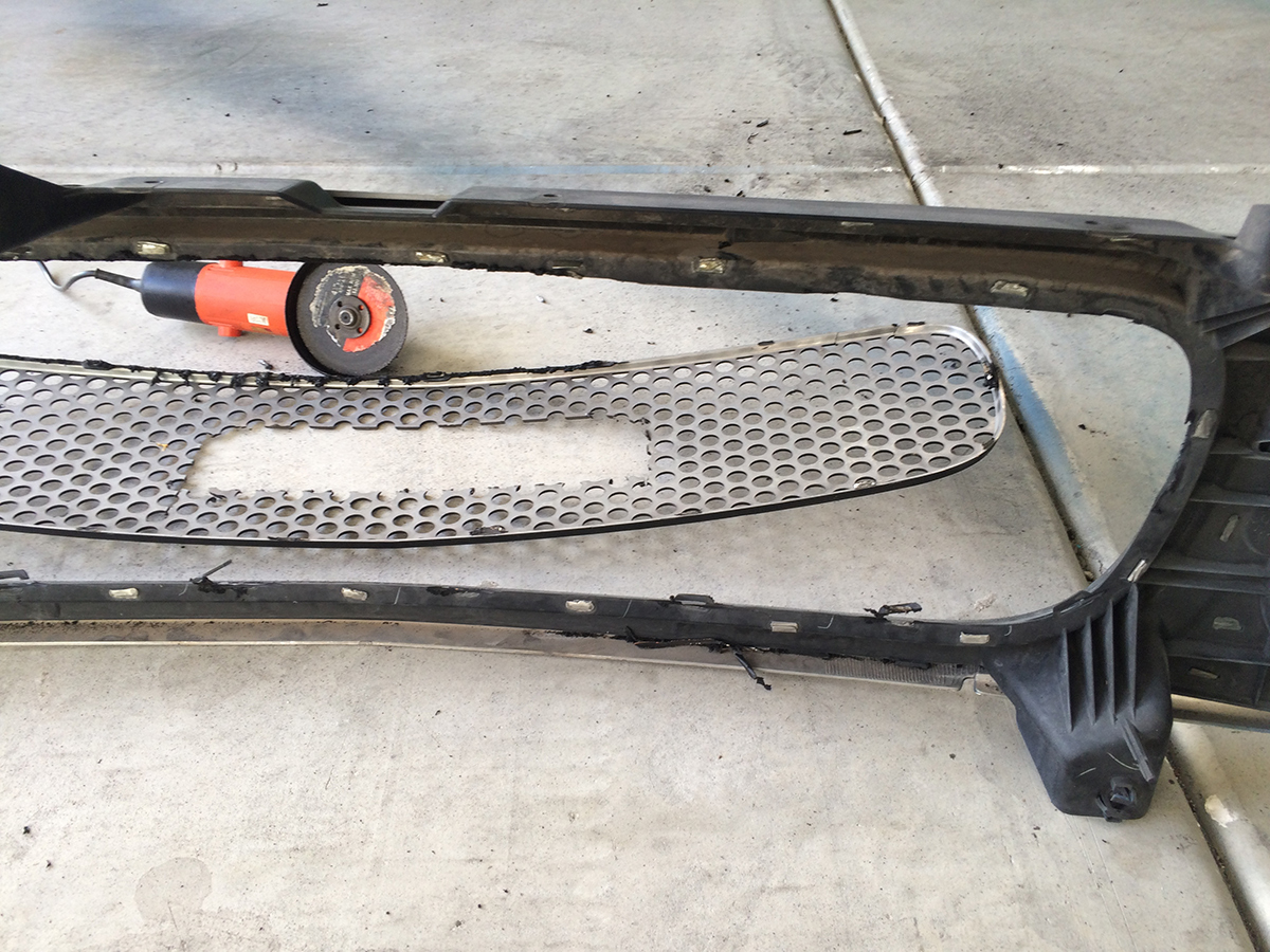

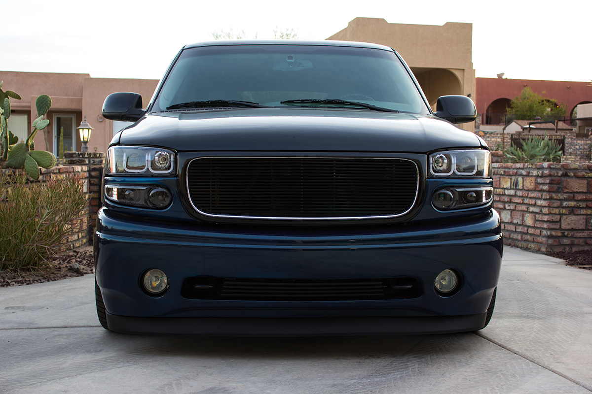

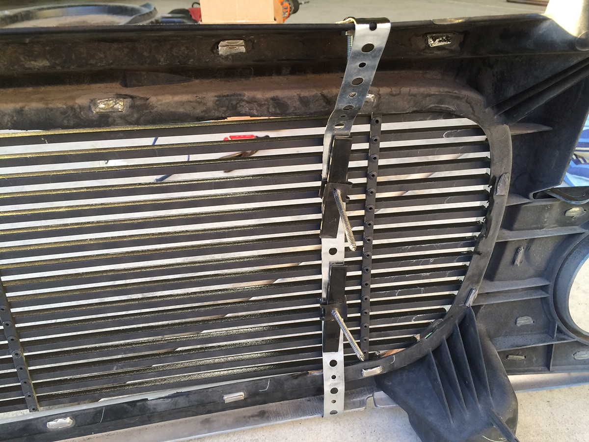

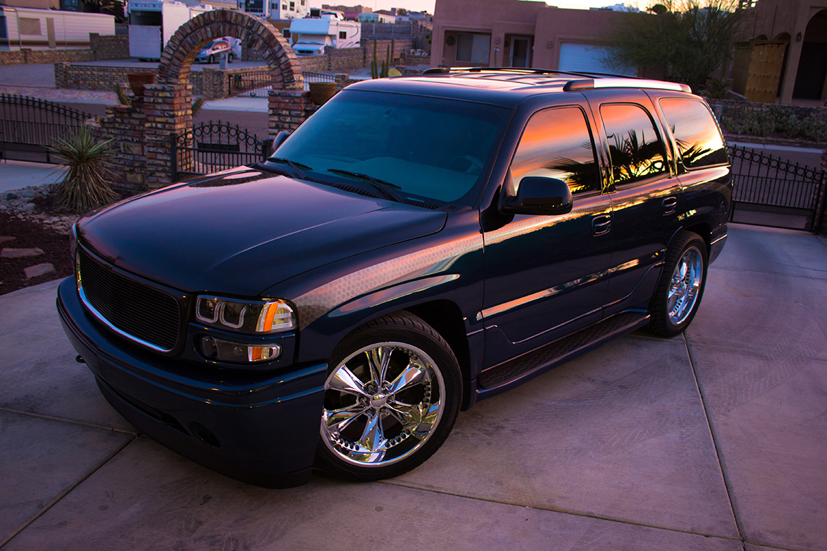

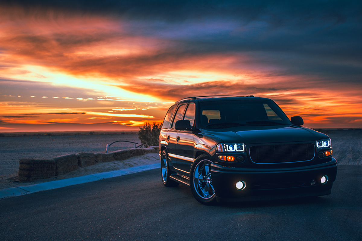

Billet Grille: Make a Overlay into an Insert

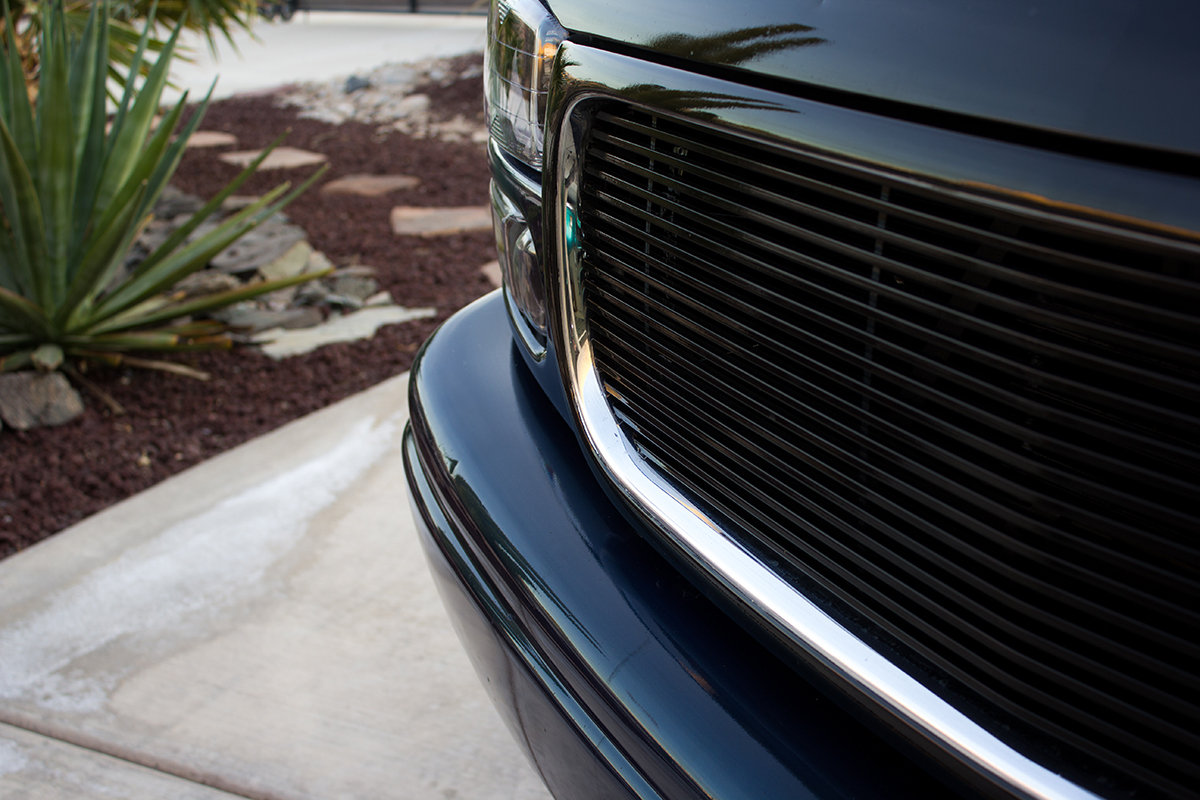

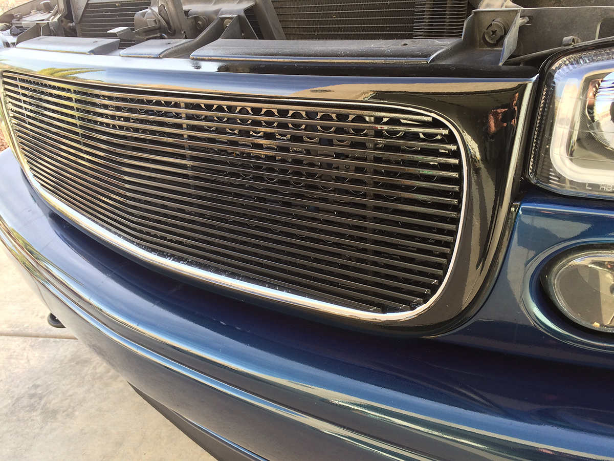

New Years Eve and i had about 3 hours before the sunset. hmm.
So the billet grille looks a lot better than the honeycomb to me, but after a few 12 packs of beer, i started getting frustrated with how flush it was with the front end and i could see the old honeycomb through the bars in certain light. I wanted it more set inside and show the chrome surround. You can tell by this pic.
But i knew i had to get pretty creative to make this happen. Whats the worst that can happen? ruin the whole front clip? haha
To remove the honeycomb, you dont have to cut the whole thing out. Just use a grinder and grind every one of those silver nubs off and the whole honeycomb piece will just push out

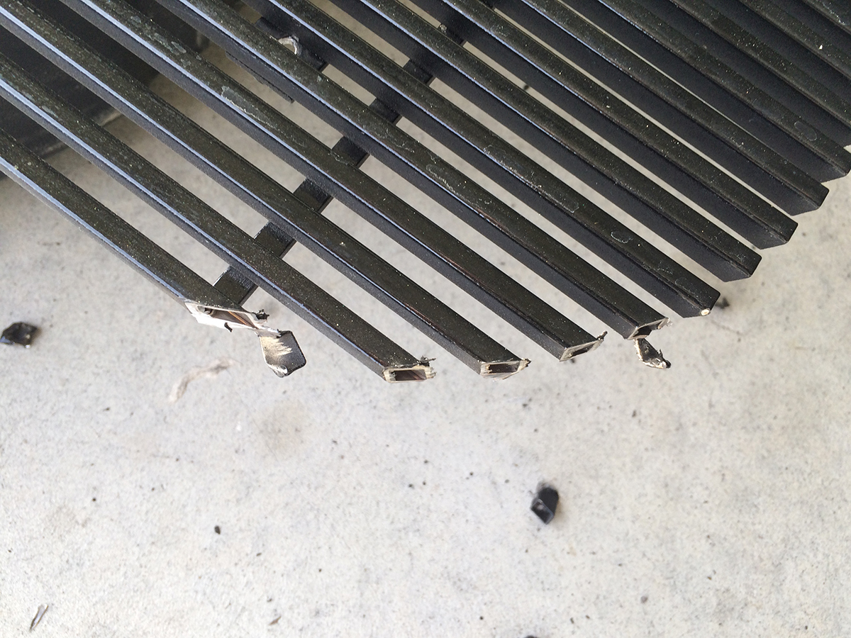

Also, the overlay is actually too wide to squeeze deep into the shell. So i took a piece of chalk and drew how much i wanted to cut off all the little bars to fit in nice and snug. I actually did this a couple times until i got it to fit just right.

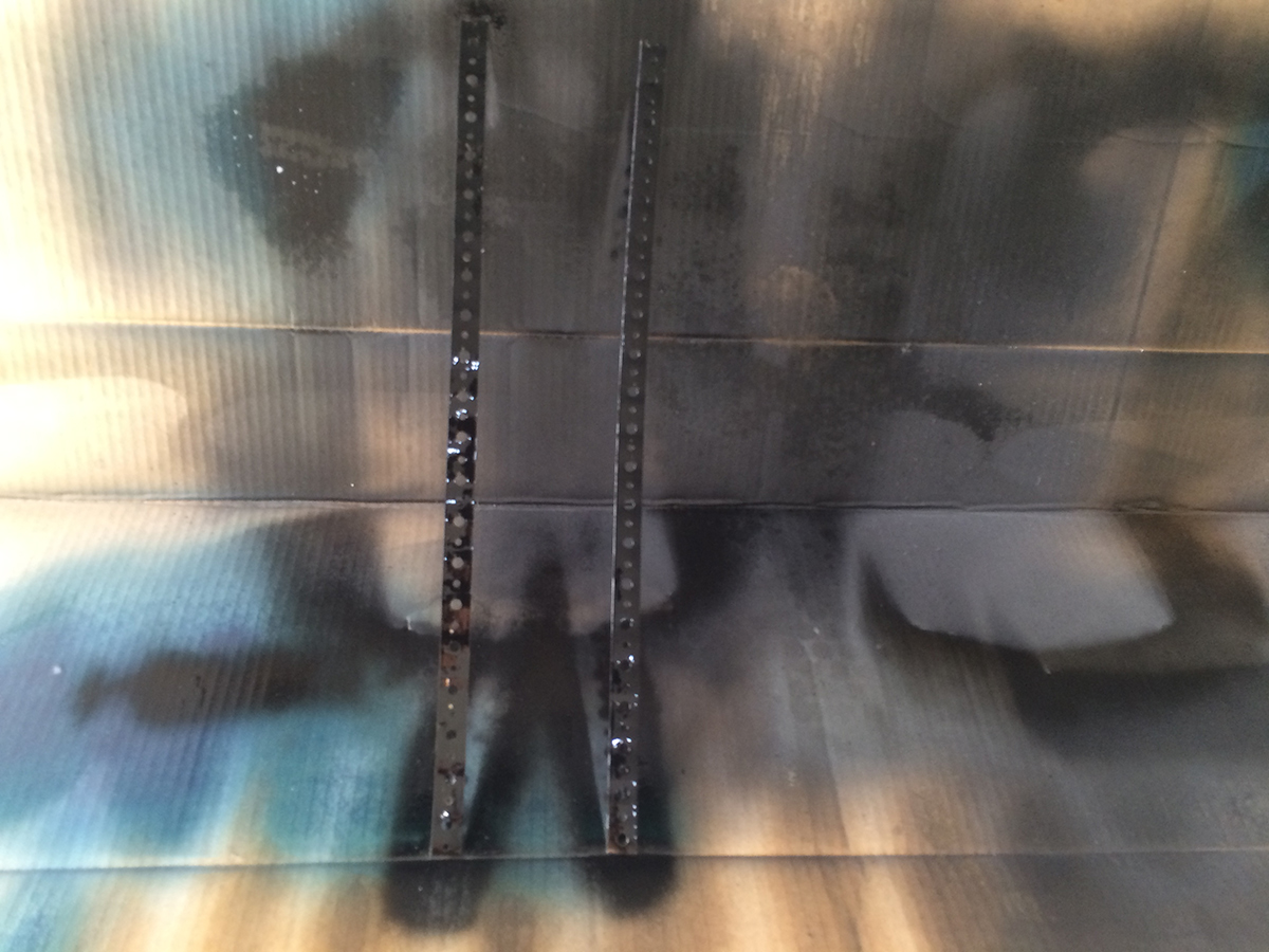

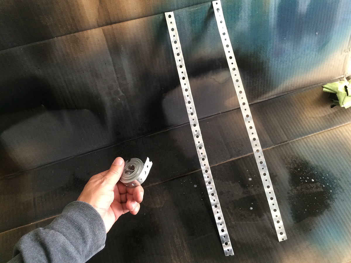

Almost there. But how the heck am i going to hold it in place? I had a roll of this heavy duty metal strap. Measured two pieces and then straightened them with a dead blow hammer.
Painted them black so you dont see them through the billet bars
I used the brackets that came with the grille, along with this metal strapping and then ran nuts and bolts on the top and bottom of the grille to hold it all nice and tight. Looks like crap from the back. But this is how i did it
Wa-Laa! Now we have an insert and it sits in there nice and deep. The chrome lip is more pronounced and no more honeycomb is visible through the bars.

I like the end result! It’s very clean and I like that little bit of chrome coming out around the edges of the billet! Looks great! Nice work!

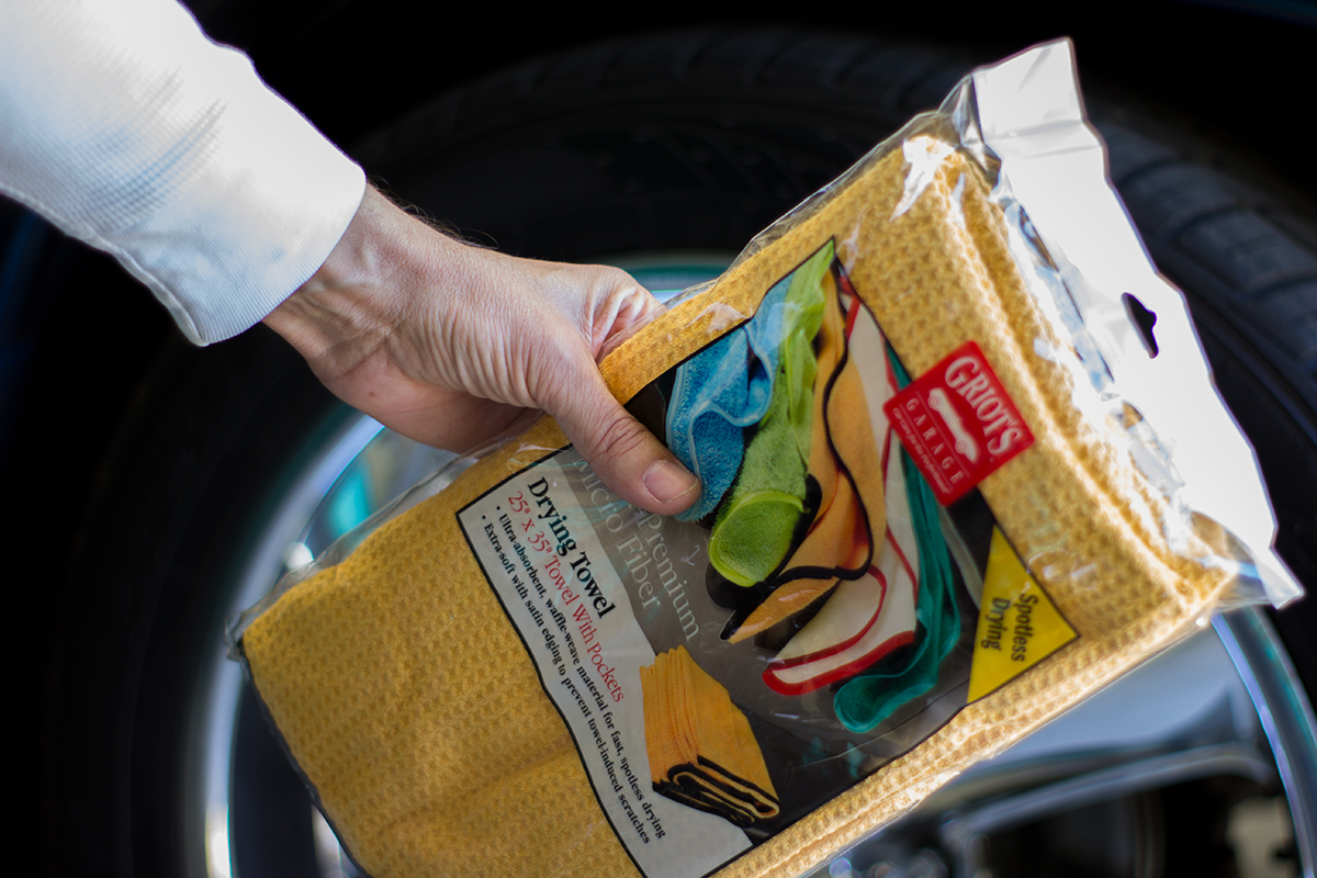

Bought another one of these.
My favorite chamois by far.
My last one got overspray on it from the paint job so i had to throw it away.
I guess everybody has their own preference on drying their vehicle. But i have tried almost everything and this Griot microfiber waffle does it the best.

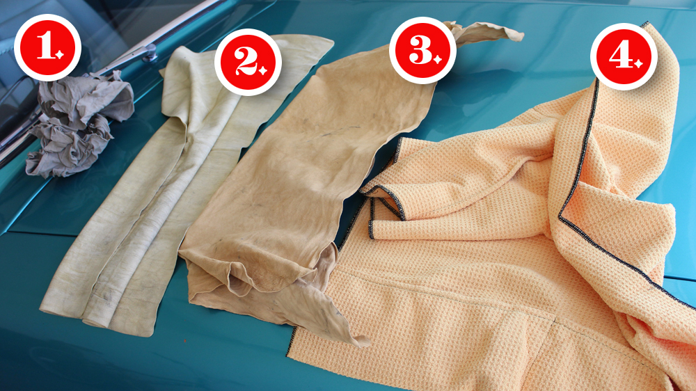

Let's have a Chamois Shootout
1.) My Old School Chamois
2.) The Absorber
3.) Tanner's Select 3.5 sq ft Sheepskin Chamois
4.) Griot's Garage Microfiber Drying Cloth
As much as i wash my cars i always wish i could dry them faster and more efficiently. I have tried many different things over the years. Seems they all have a downfall.
#1 - (unknown brand)
i got this at a flea market in like 1997. It's real sheepskin and has ALWAYS been my "go-to" chamois. But it has become riddled with rips and tears and now starting to leave a little bit of a haze. She has served her time and i wouldnt know where to get the same one.
#2 - "The Absorber"
It does what it says and really soaks up the heavy water left on your car. But once you try to get the car completely dry with it, seems to leave a thin layer of water streaks.
#3 - Tanner's Select Sheepskin Chamois
bought this one the other day (sheepskin) thinking it would be a new replacement for my old school. Not the case. Doesn't soak as well as the absorber and still leaves water streaks
#4 - Griot's Garage Microfiber Drying Cloth
i read a lot of reviews and as much as i love my Griot's orbital i tried this one. I didnt think microfiber could ever be as effective as a chamois. But holz sh!z. This is my favorite. You can dry whole car without even ringing it out once. Left no residue or water streaks at all.
*** Winner: Griot's Garage Microfiber Drying Cloth ***
Another thing i used to use was a leaf blower to get the bulk of heavy water off the top flat surfaces.
Feel free to voice whatever you use that might be better

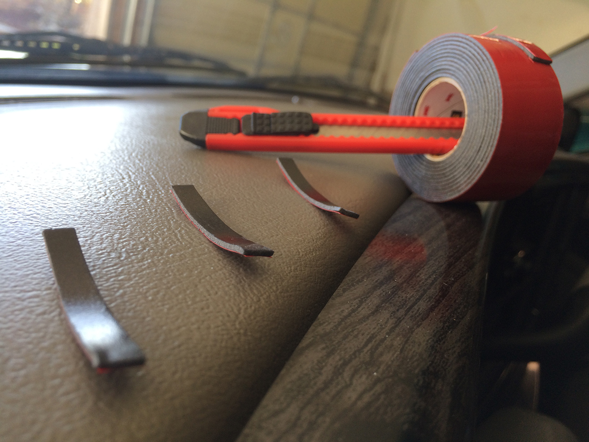

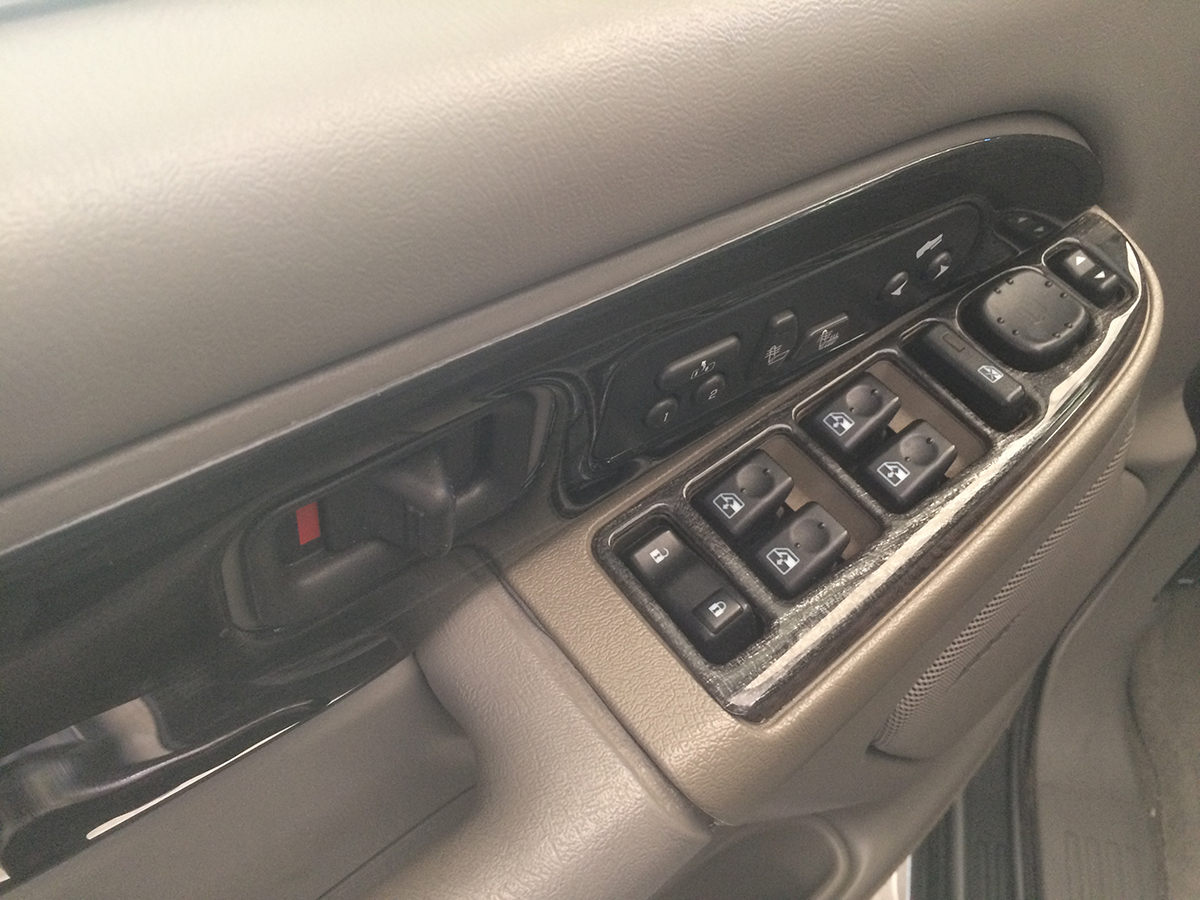

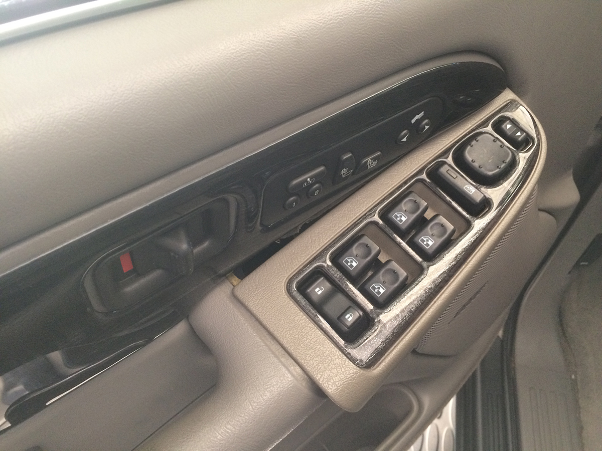

Whoever owned this Denali in its past did some major hacking on these door panels. When you shut the drivers door it has a bad loose noise and this piece has slowly worked its way out. It started coming out like this every time i shut the door. The heavy plastic guts that once held it in dont even exist.
So i got some extreme 3M heavy duty double tape (claims it holds up to like 65lbs) to hold it in place.
I found one on eBay but they wanted like $40 for that little piece of plastic. Screw that. Not to mention i think the problem is the door panel and all the plastic that they cut out and hacked. Anyways, it has been holding for a couple days now. Temporary wack fix

I have the same issue. There's a tab that's connected to the inner front of the door armrest that the bezel(what the window switches are in)hooks into. They break, then that bezel just swings in the breeze. I got so frustrated with mine I used silicone. Works great until you gotta get back in there.
yup. exactly! hopefully i wont have to take it off until i do a stereo upgrade :)
