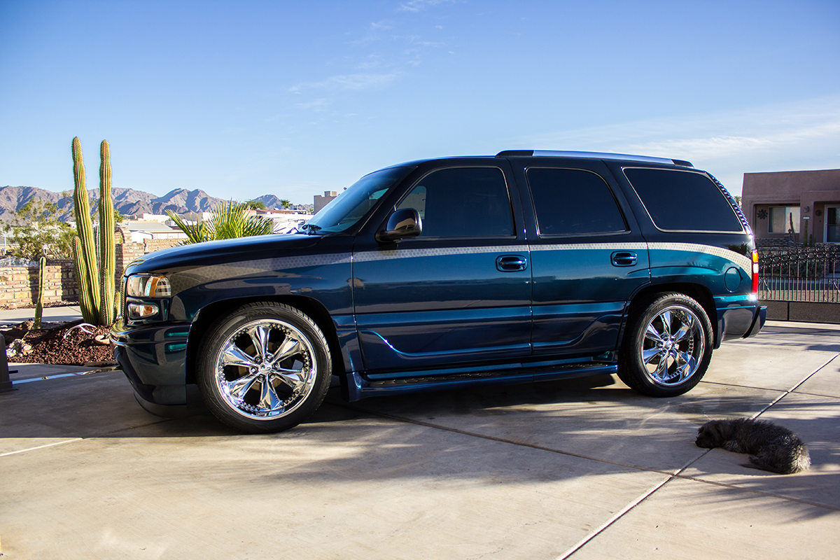

thanks Chase. i'm really happy with it. That blue dances all over the color spectrum in the sun.

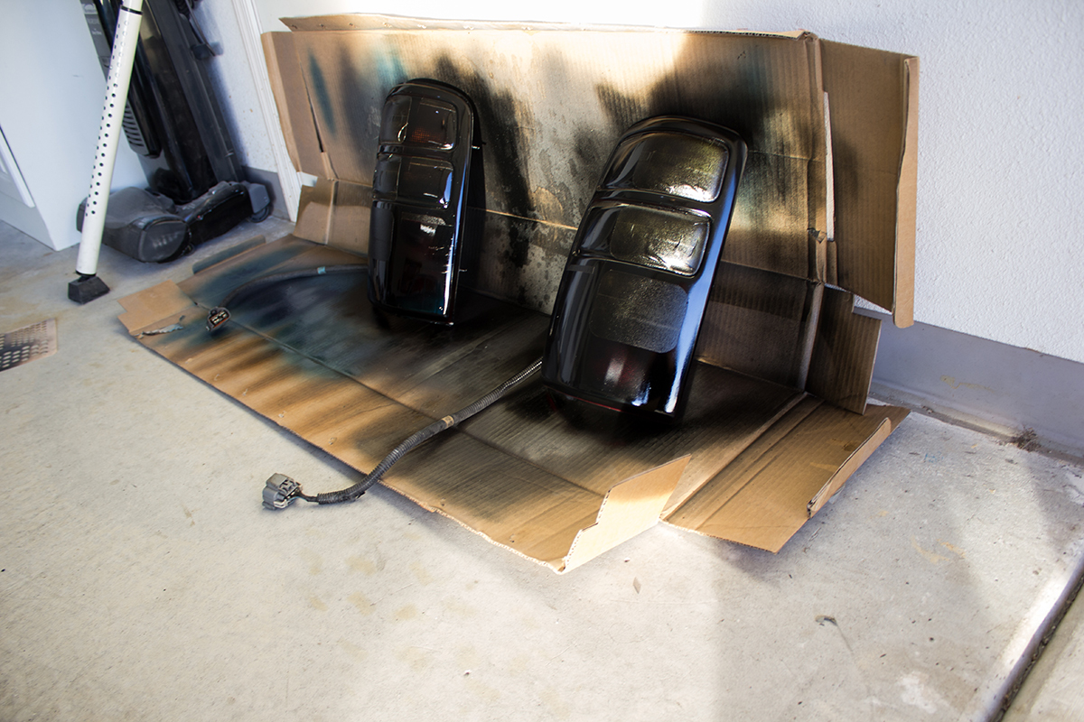

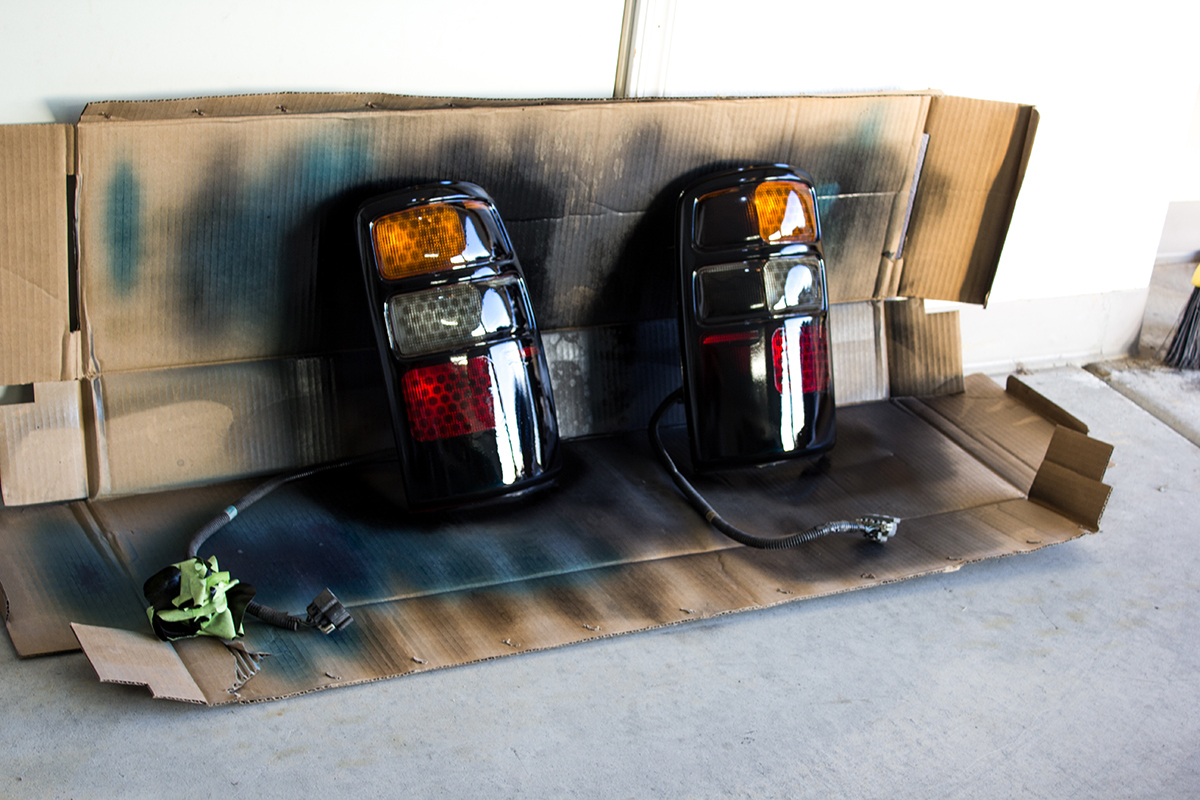

Customize the ugly OEM Tails
I mean there is only so much you can do to polish a turd. But like i said, i havent found any aftermarket tails that i like and i have searched everywhere. All i can do is make these look uglier in a worst case scenario. So let's see what we can do.

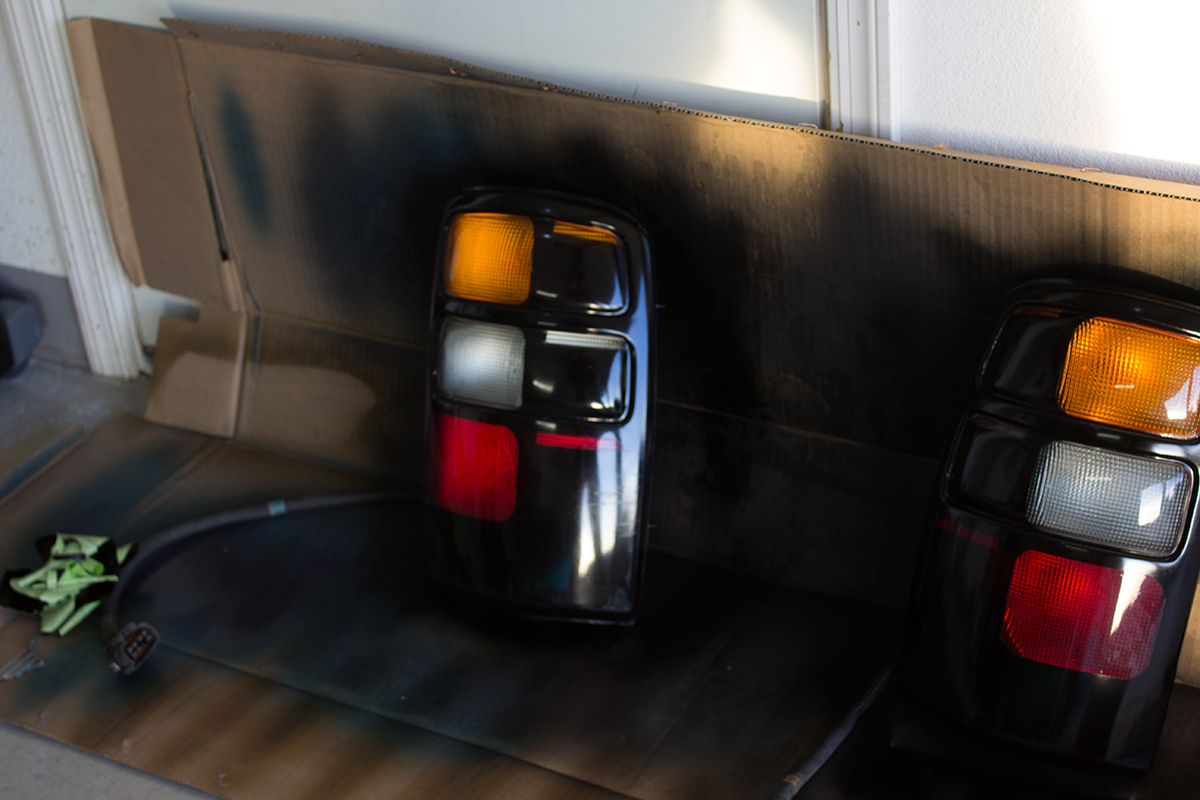

Cleaned em up, scuffed em and laid out an idea with tape and an exacto and some measuring.
one consistent coat of black. only one so in the sun we can still see the reflectors slightly
pull the tape
Pulled out the honeycomb stencil and used a small spread just to add a little more personality to them.
and. 3 coats of clear.
Not bad.
Better for sure.

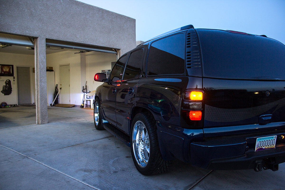

but now that Third Brake Light on top sticks out like a sore thumb!. ugh :doublepuke:
This is just with the truck running. No brakes but blinker on

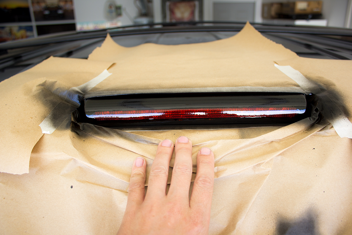

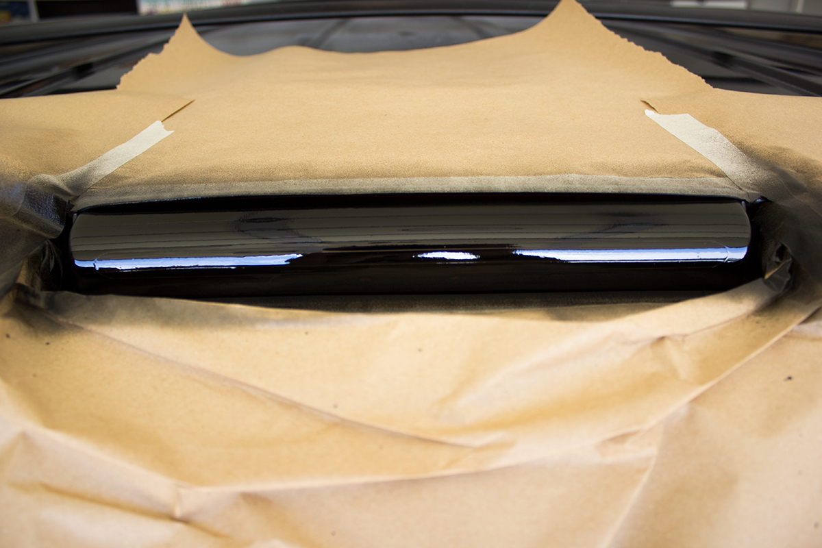

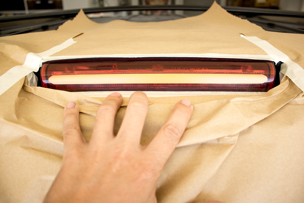

Woke up with that 3rd brake light greeting my eyeballs. Figured i would bang that out real quick.
Used pinstripe tape and made a nice clean narrow shape down the center line of the LED's
Blacked out the rest
Peeled the tape then 2 coats of clear

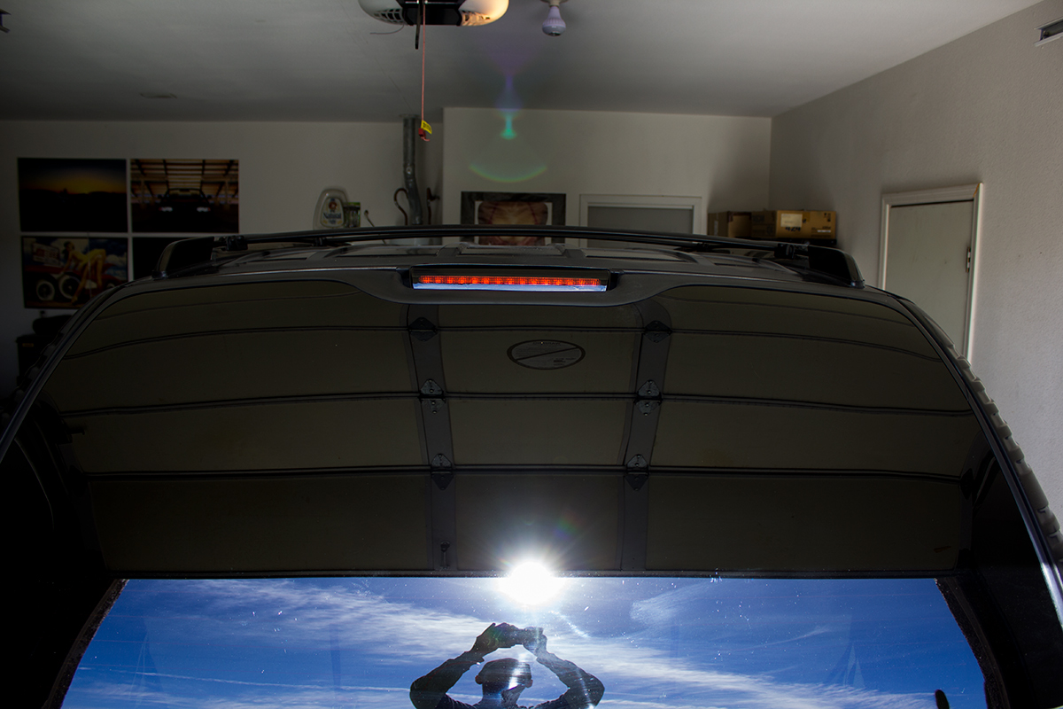

ahhh. much better. simple and clean
