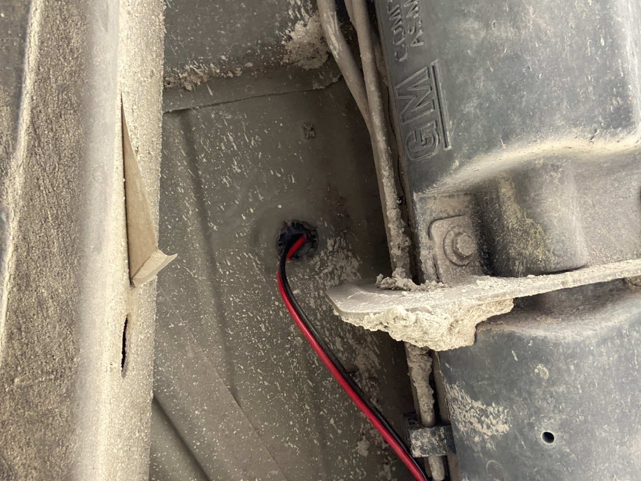

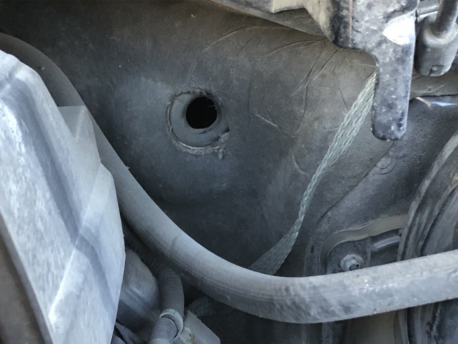

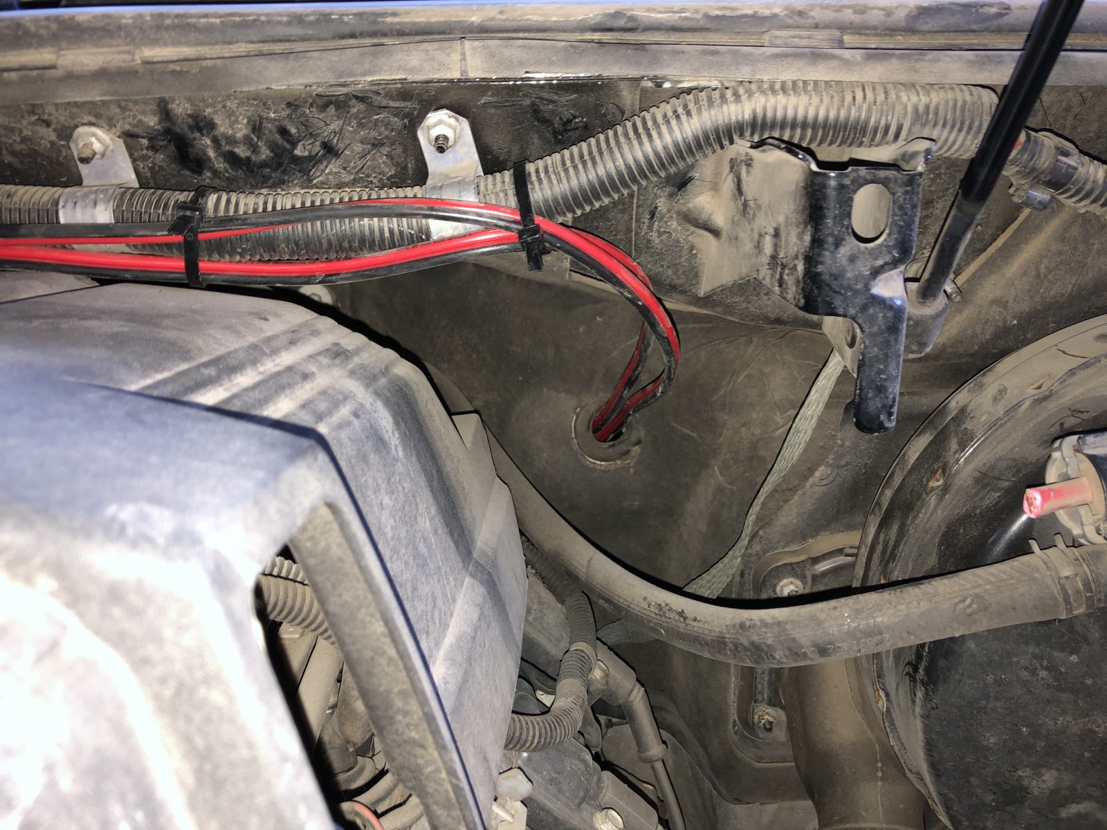

Oh that’s easy. First buy a PPV where the decommissioning guy savages all the extra wiring. Then reuse the empty 1” grommet. It’s amazing how much will eventually get passed through it.

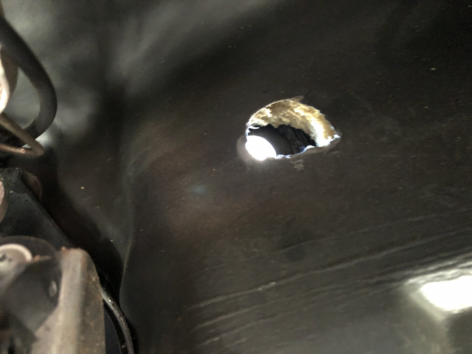

I spent hours last night searching for the perfect spot to get through the firewall. I have decided it will be on the passenger side where the extra battery mount is. pics coming soon.

For thethirdtwin, I found a grommet in the passenger side floor to go through for my ham radio power cable. it’s about a 1” plug.
