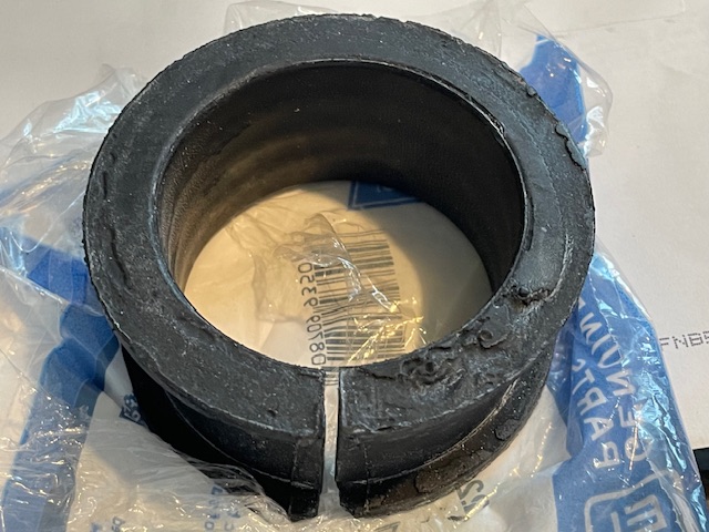

I have a pretty noticeable clunk when making certain tight turns (faster U-turns etc)
I have found play at the passenger side steering rack bushing.. Can make it clunk by hand.
Purchased a GM replacement bushing,
Country of Origin = USA!?
it's a split rubber piece that looks like it was made in India..
How do I install it?

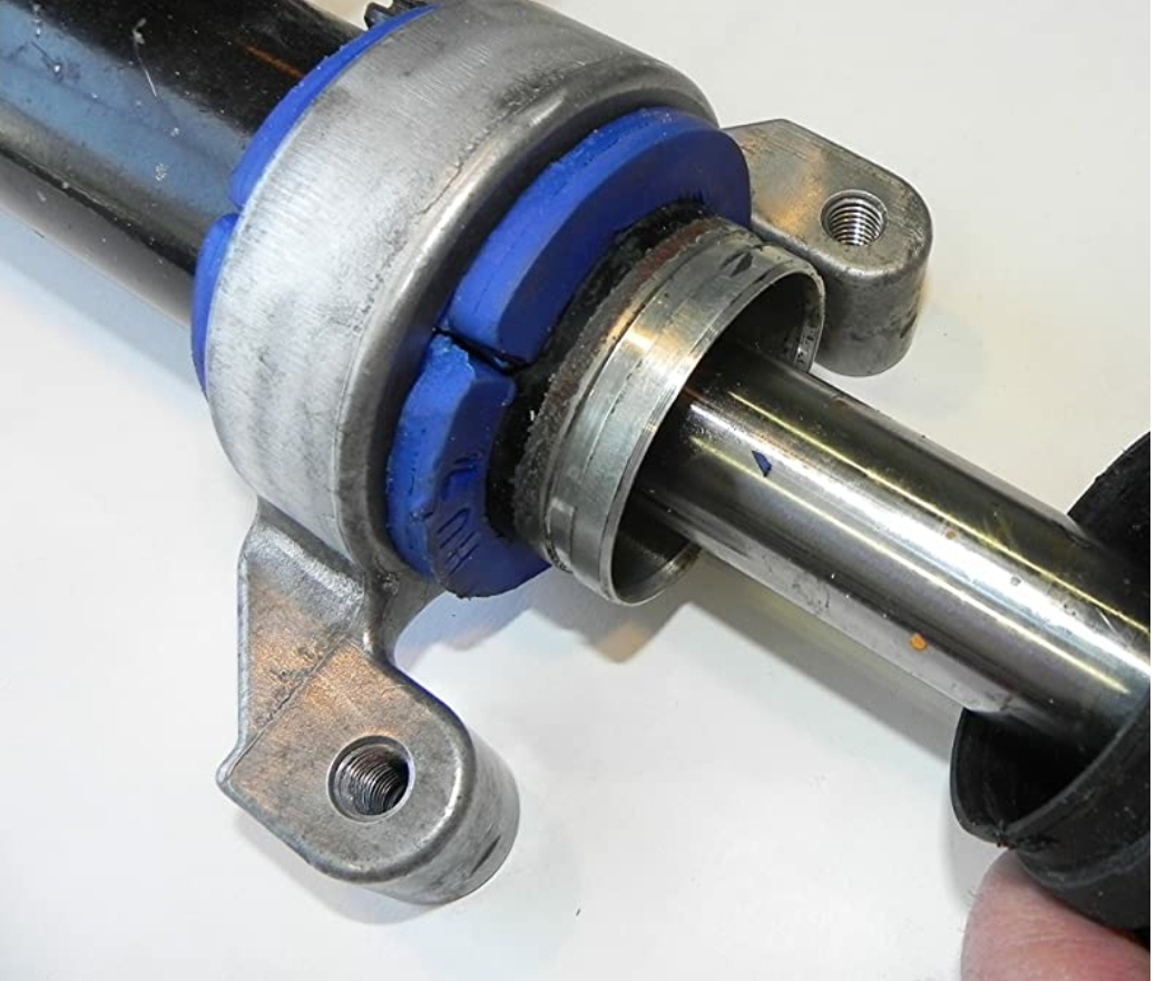

I replaced mine with a poly bushing. It was a fight getting the poly bushing back onto the rack, hopefully the rubber is a little more forgiving.
You just unbolt the 2 bolts that hold the bracket and bushing in place and slide it towards wheel. You will have to slide the accordian boot over but you don't have to remove it completely, unless you want to.

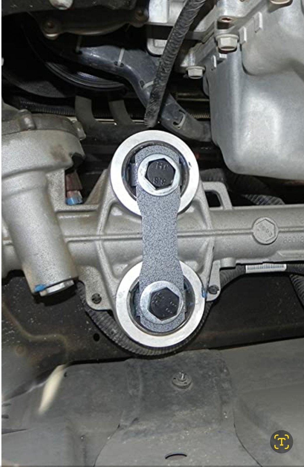

I also installed a bracket into the bushings on the opposite end that are supposed to stiffen everything up.
They come as a kit on Amazon if you are interested.
Fits GMC Sierra Yukon Cadillac Escalade 2007-14 Chevrolet Silverado Tahoe Steering Rack Bushing Set Polyurethane 19330568 https://a.co/d/fcNsolv

The Junglewebsite has those same pics, and it looks like it fits, but thebjne review with photos said the poly bushing was too thick to fit into the collar.
What technique did you use to drive the bushing home?
Those are indeed the same pics as on the site. I forgot to get pics because as mentioned it was a struggle to get it on without removing the rack.
I lubed it and used a ratchet strap to help coerce it back onto the rack. Definitely a tight fit, but that is what you want, right?
To get it inside the bracket you have to kind of fold one end inside, toward the open center, and overlap the other end to reduce the overall diameter, slide it inside the bracket then uncoil it, if that makes sense.

Just replaced with a factory one today..
Looking at the old and new, you can't tell any difference..
The rack end slid through pretty easily with not a whole lot of tension/resistance.
Unfortunately I STILL have an occasional clunk.. probably balljoint.. only happens when full lock left turn and braking.. sometimes..
And I noticed a littler seepage from the rack...
And oilpan is wetter than it ever has been (rear main or oilpan I'm thinking)
1 step forward, 3 steps back!

Perfect timing. I’ve had my ricochet.com kit since ‘20. Sold the ‘08 YXL Denali before I had a chance to install it. The 09 Escalator :D is getting a complete front end refresh in Jan with a new rack for its 190k Mi birthday.
Just pulled this out of the rear cargo storage box and threw it in with the new rack box for the Caddy. Almost forgot it was back there. Should be wax on, wax off to add it to the new rack before the rack swap.
