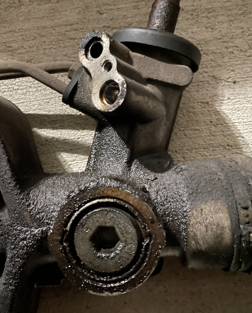

Last week I noticed a few drips of power steering fluid hanging from the drivers side bellows that cover the inner tie rod. I wiped them away hoping they wouldn't come back, but they did. At this point it's not leaking enough to drop the power steering fluid level significantly, but that time won't be far off. I'm certain that the leak is coming from the rack and not above it as I went over the area with a fine toothed comb in the form of an inspection mirror. And, with 223K on the clock, it's probably time.
A new rack is prohibitively expensive for an aging rig, with a reman unit running about half price. Fel-Pro sells a rebuild kit for less than $50. Have any of you rebuilt one of these racks on the bench with success? I would of course install new inner and outer tie rods, and bellows as well.

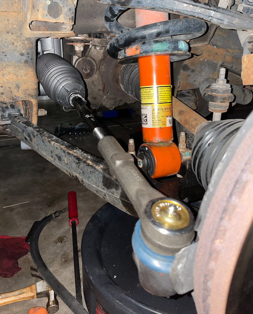

Just an update with some pics from the work. Still have a few things to finish and wrap up the job, but I have an appointment at Firestone on Wednesday morning to get it aligned, so I better get it done stat! Still haven't torn into the old rack yet.

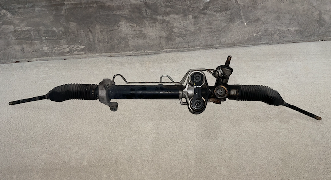

Did you happen to take any more pictures of the reman gear other than the one posted above? The boot looks to be factory-ish in that picture. One of the things I've always hated about the aftermarket reman gears is they usually come with a crappy rubber boot that doesn't "slide" on the inner tie-rod when adjusted the alignment so it twists up and you have to take the clamp off to fix it. The only thing that bothers me is they show it fits pickups and SUVs but GM has two different part numbers for pickups and SUVs.
Geotrash
Geotrash
Dave
Feb 16, 2018
7,845
20,403
Richmond, VA
I'm sorry, I didn't :-( It's definitely a factory part that's been rebuilt.
The boots actually behaved as I hoped. They were snug on the rods but allowed enough slippage for me to install and adjust the tie rod ends.
