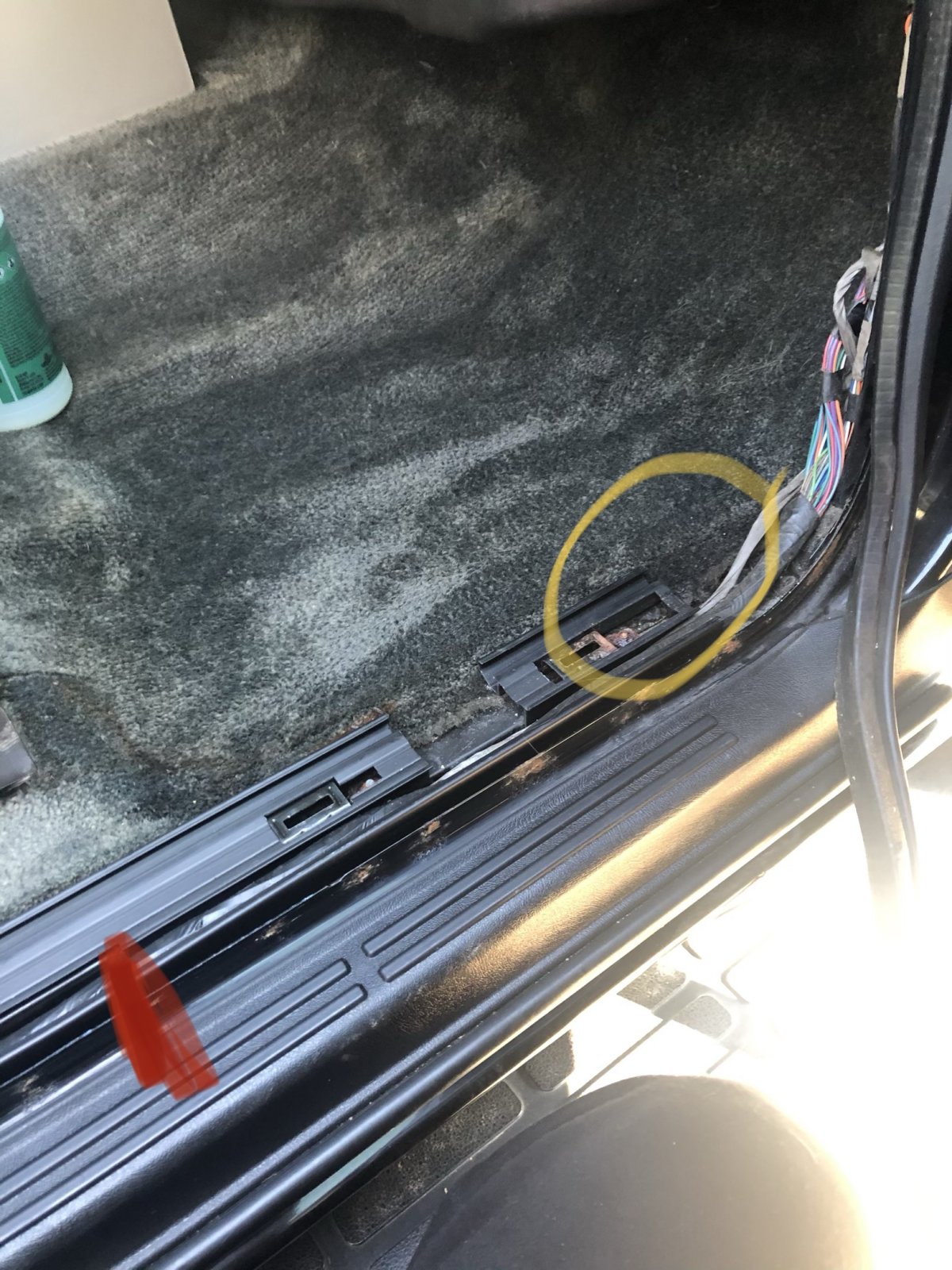

01 tahoe has sunroof with 146k my passenger floor seems like it’s always wet. I pulled stuff off and looked. It seemed like it was running down the bottom seal. In the photo the red line seems to be where it starts and the yellow is the wettest. Any have any ideas other then the seal itself?

Did they run the satellite antenna wire through the gasket somewhere up higher?

Yea they ran it through the piece that’s screwed in by 2 star screws I believe. It’s basically the end of the of the door seal I can take a picture tomorrow and post it
