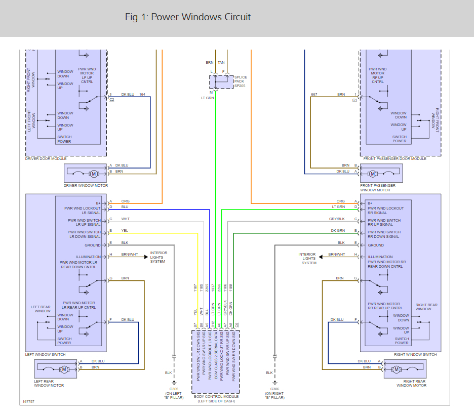

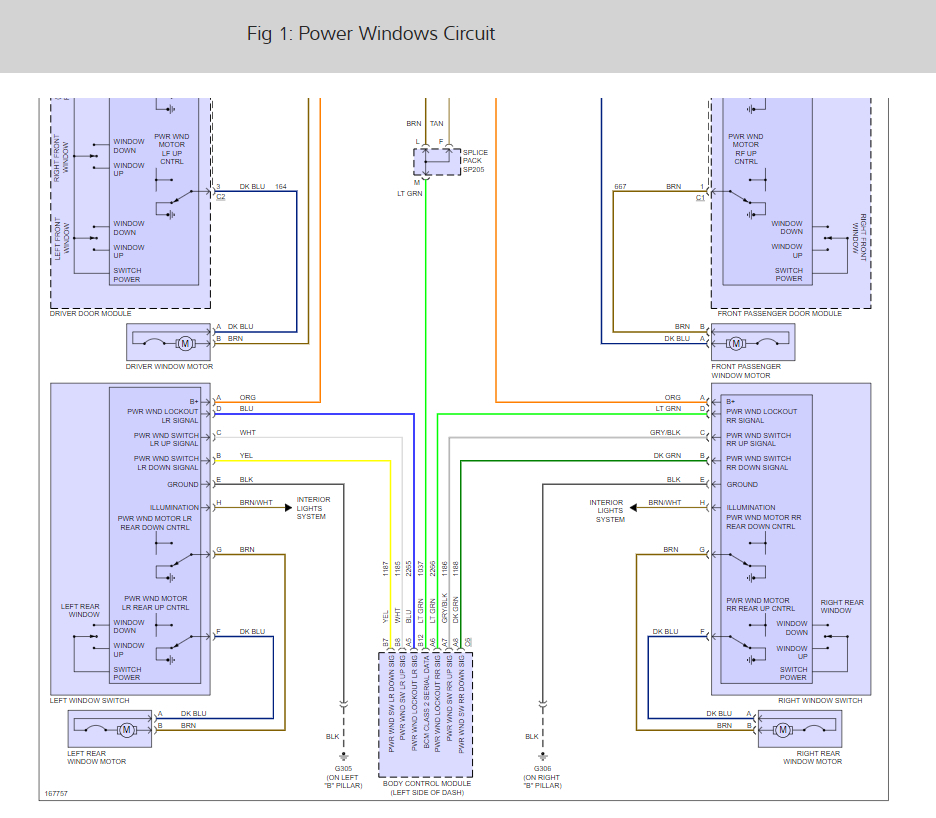

My mistake- was the door lock relays I had in my mind. Maybe this will help some.
