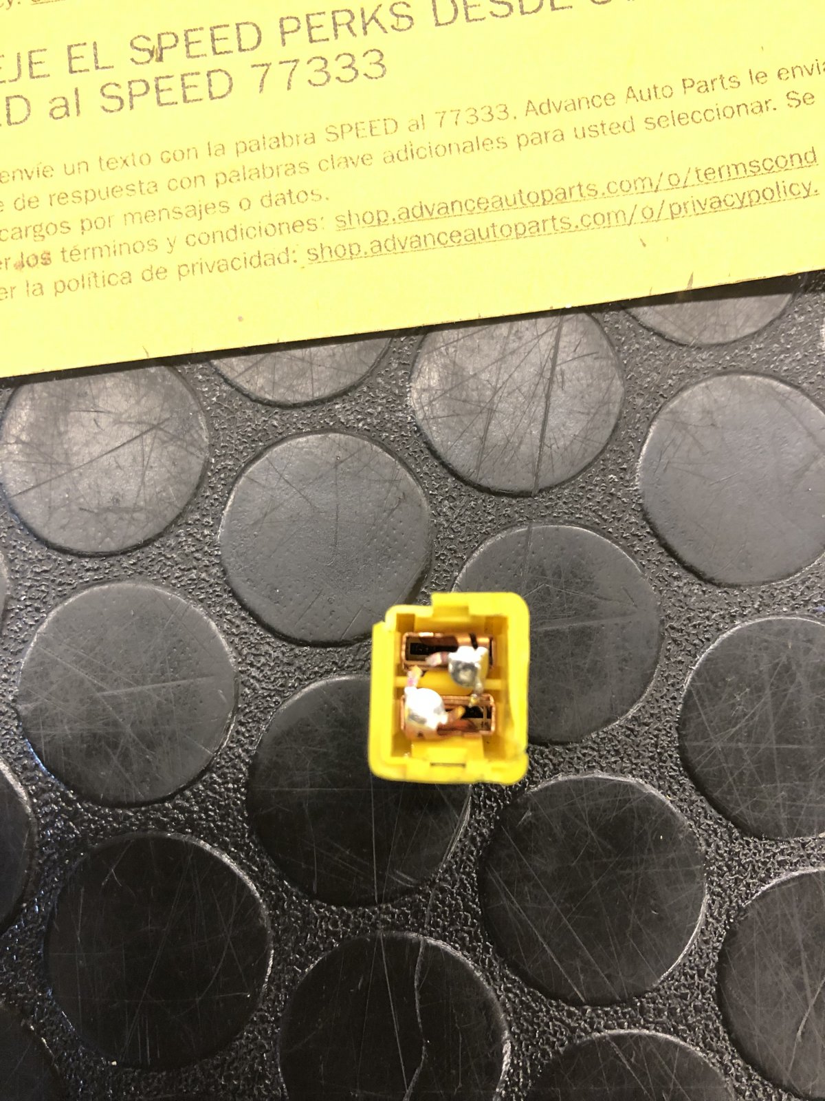

Ok so I looked around and found a fuse that was blown, I replaced it, and now I’m seats can move, and I can roll up my passenger rear window, but the passenger front still got nothing. Is there a fuse for this window or something ?
