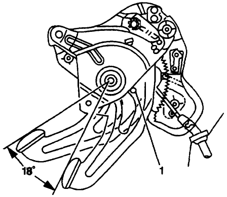

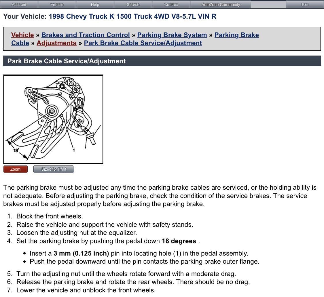

Not sure if this will help, but maybe it will...
