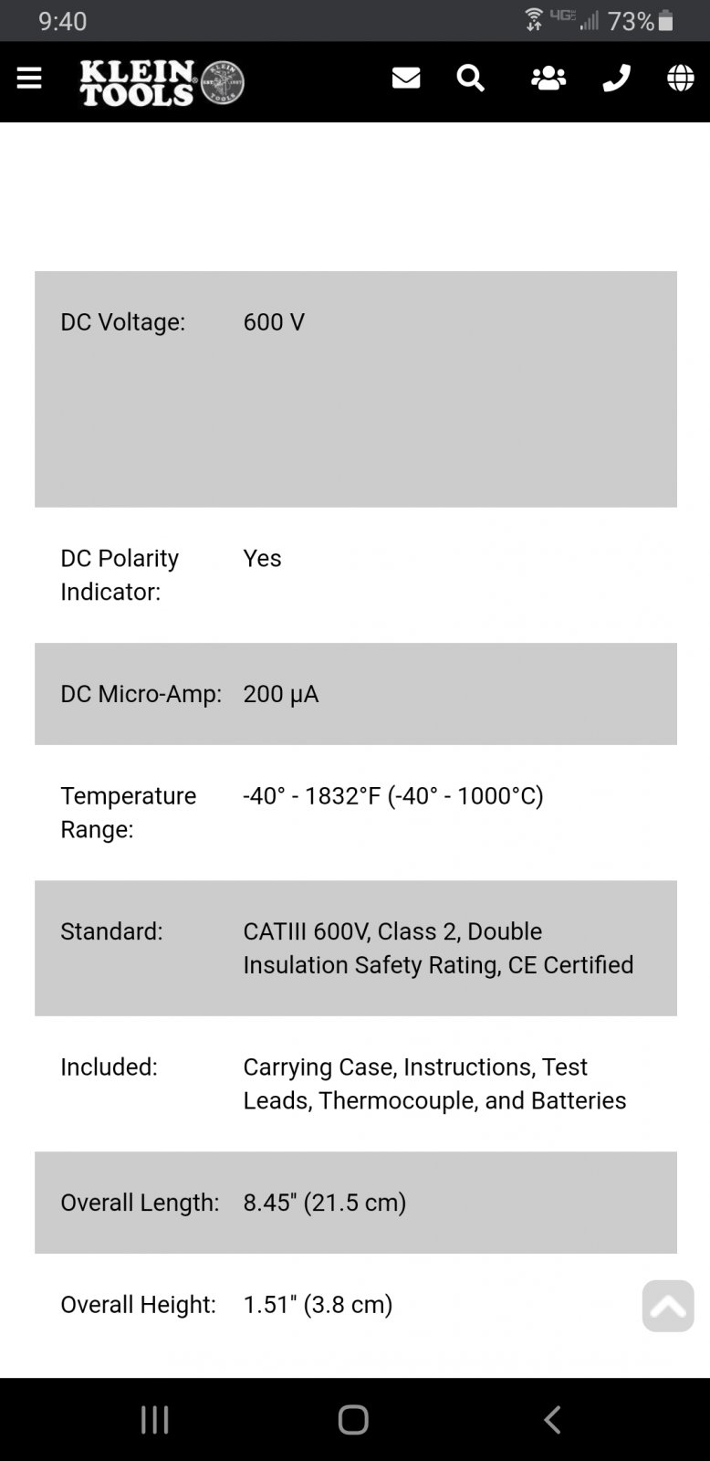

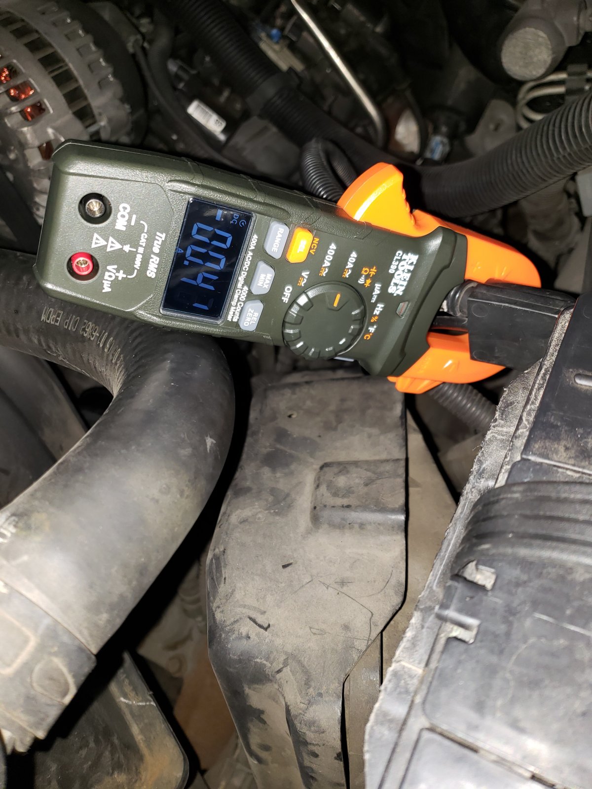

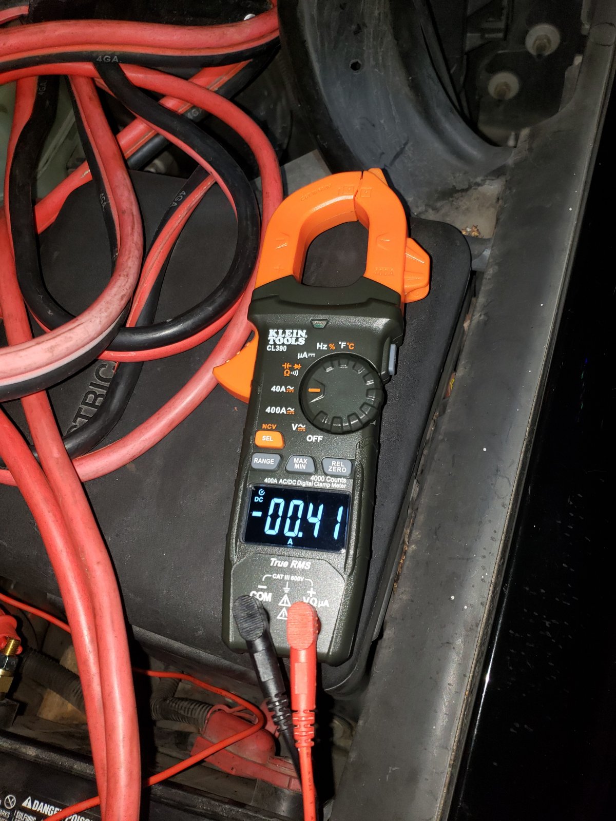

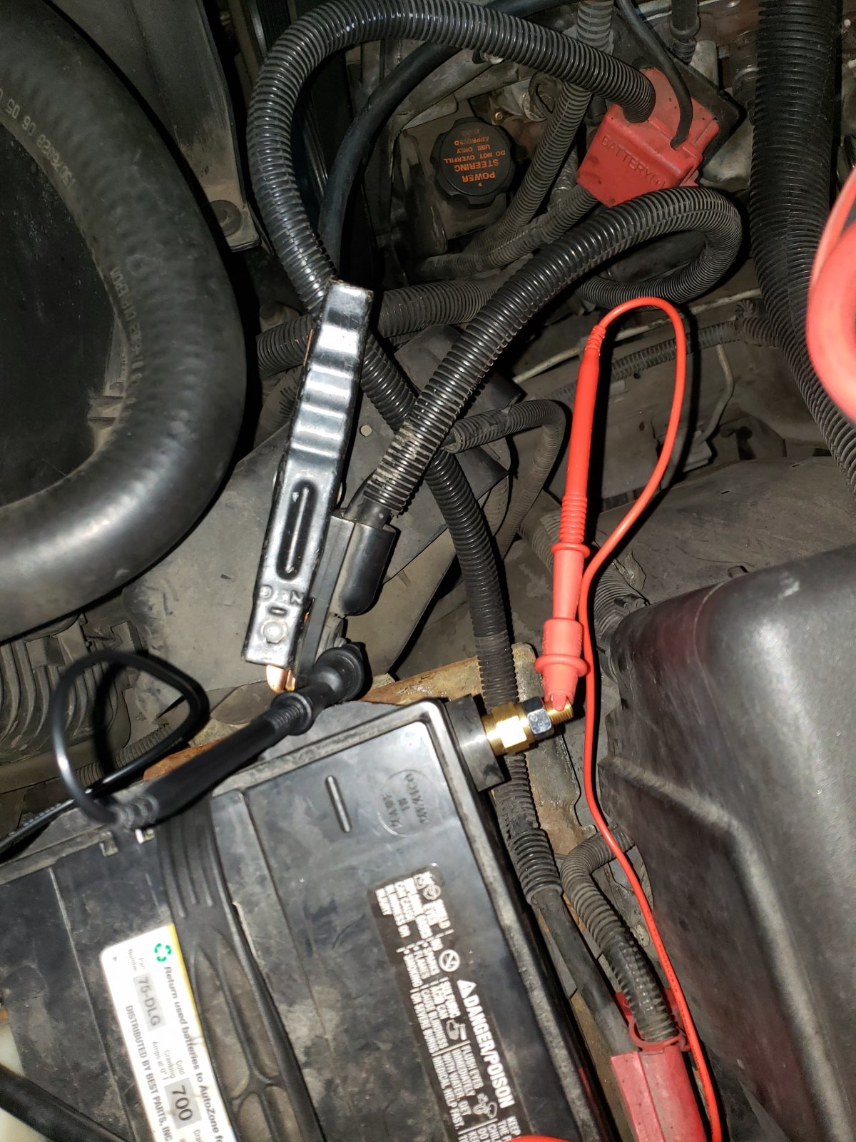

it was working fine but at times i kept getting a lot of fluctuating readings around the cables before i put them through the clamp. I ended up removing the negative battery post and connected the meter inline instead to get more accuracy
Mickey, I'm curious to know what you think about the Klein you bought. Wondering how it worked out for low DC current measurements with the clamp.
