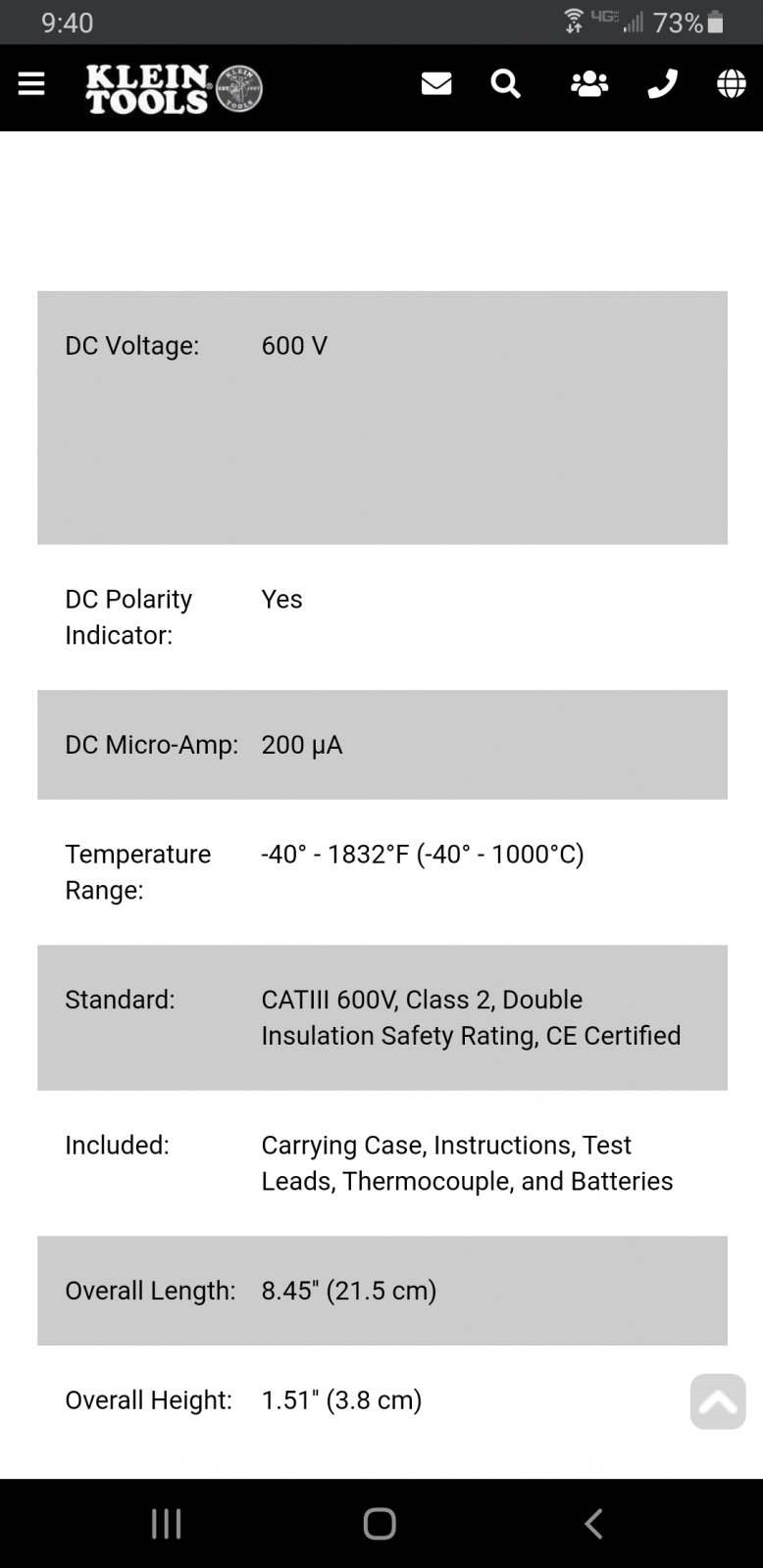

Thanks, i ordered a true rms klein cl390 for $75 on amazon. If i read the description correctly, it will read down to 200 microamps

I may be wrong but I don't think the clamp will read that low. The test leads will, but the meter will need to be in-circuit. I don't see where the specs show the amp clamp values.
Measures both AC/DC current and NCVT via the clamp and AC/DC voltage, DC micro-Amp current, resistance, continuity, frequency, duty-cycle, capacitance and tests diodes via the test leads, and temperature with thermocouple.
One comment: the "...25A RDO AMP fuse is consistently pulling 1.0 mV which translates to 218 mA..." A 25a Mini Fuse, if that's what you have, reads 1.0mv across it, the current would be 424ma, if I'm reading the chart correctly.

You sir are correct. i was looking at the 15A fuse for some reason. i called klein tools. They told me the clamp will accurately read as low as 100 milliamps. Anything under is no good
