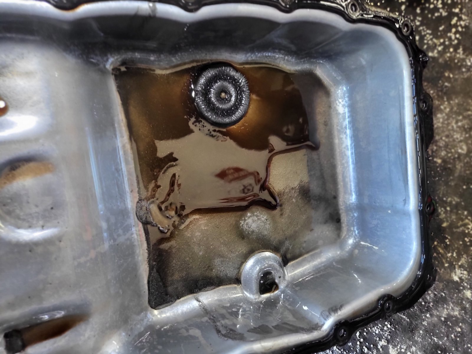

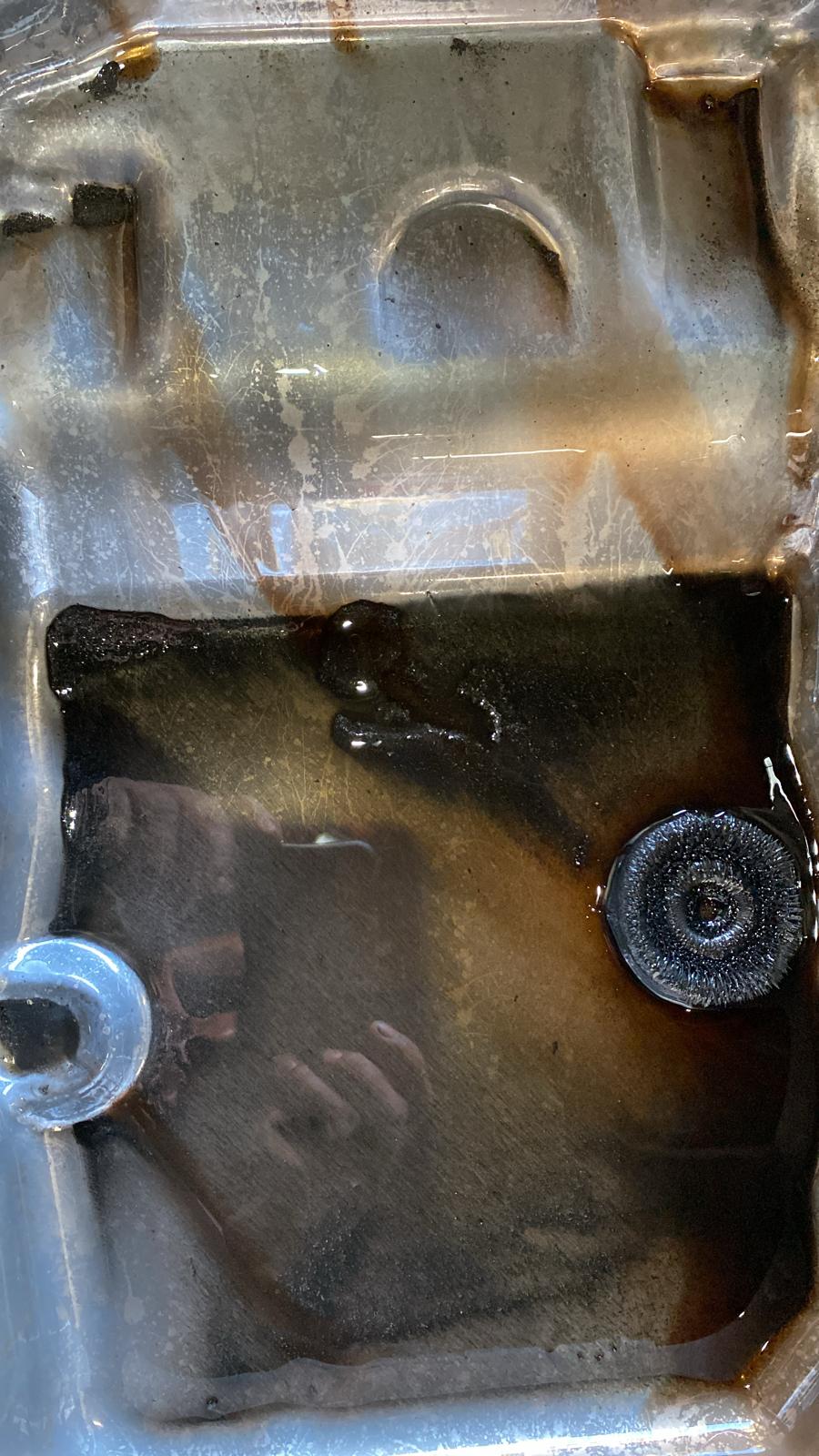

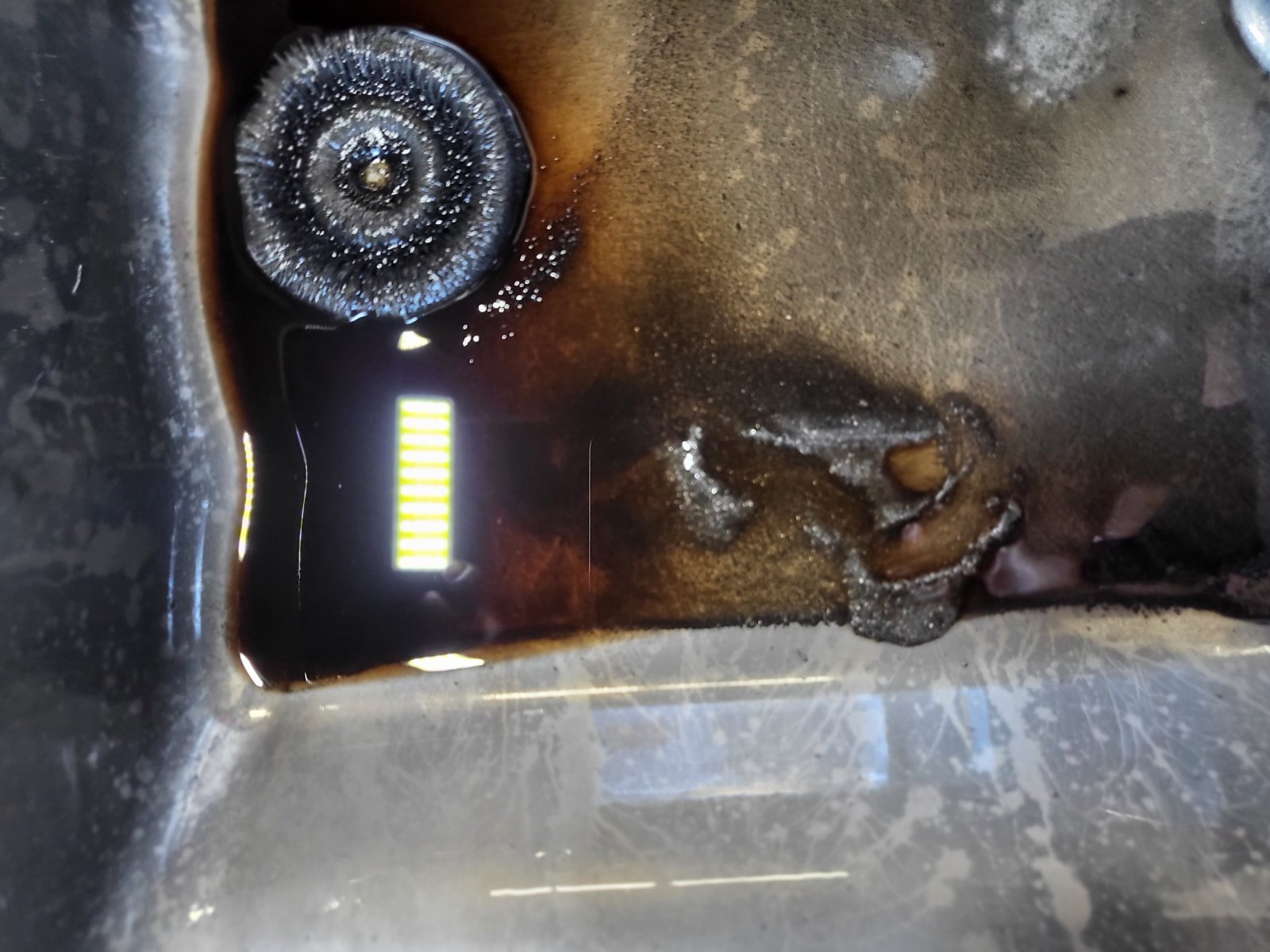

So this was the outcome a lot of metal shavings I went ahead and changed the transmission it runs good now
