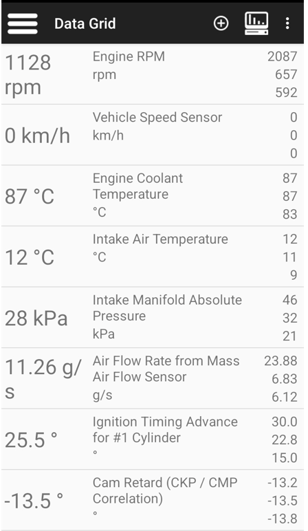

@exp500 i got it, bought the gm pid. I'm dumb cause I can't find anything that shows me cam retard or anything like it. Can you (or anyone?) tell me where to find it/set it up in dash command?

Ok I Found it. So it says -13.4 (at 1000rpm). What should it say?

Distributor not correctly set. +- 1degree at1000 rpm. requires scanner. Many cheap bluetooths will do this, name varies with app,Cam Retard Offset is one name . Many posts here.
Reply here if you cannot find it or need help.
+/- 1° at 1K rpm.

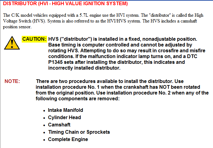

I talked to the guy who just replaced the distributor and mentioned all this and he said there is no adjustment for it. And then I find this. The 5.7L engine is what came in this truck, so I think this may actually apply? I honestly don't even know how to tell, but I think this is what I have. Can anyone tell me how to verify?

Are you sure you are reading CMP Offset? I made a mistake using DashCommand where I was actually reading “Timing” with numbers close to yours. I finally got the GM PID loaded and I had to rotate my distributor counter clockwise until it was contacting my upper intake, and I was able to dial it in to -.3’ at 1000rpm.
This is what I got
You can verify, by disconnecting your battery. Pulling #1 spark plug out. Pulling your distributor cap off and out of the way. Getting a socket and a large ratchet, and rotate your engine harmonic balancer until the timing notch aligns Top Dead Center on the compression stroke, your distributor finger should be aligned to the triangle like picture. Then you need to fine tune adjust distributor with truck running, by leaving your distributor hold down bolt just loose enough, you can carefully rotate distributor in fine increments.

Plus the mechanic said there is no adjustment for this distributor, just like in the screenshot above (which is actually from Mitchell OnDemand) where it says the distributor is installed in a fixed, nonadjustable position for HVS (which I may or may not have??). So, of course, I'm utterly confused...
