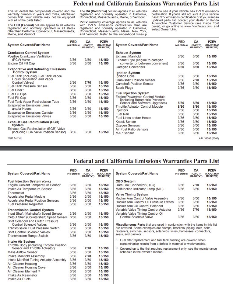

The standard Federal emissions warranty is 8 years or 80,000 miles and California emission standards are longer. This would be covered under emissions warranty.
not much is covered beyond manufacture warranty (ca. get's a few more mileage allowance) basically it's cat's and a select few things, evap is not covered in this persons case under federal or ca. unless he is in ca and it turned out to be a vapor valve and not a evap valve
