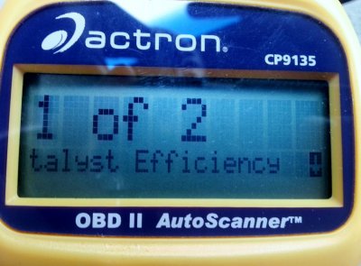

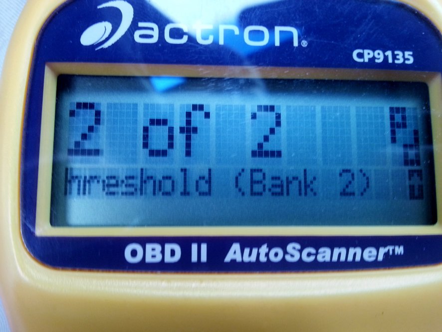

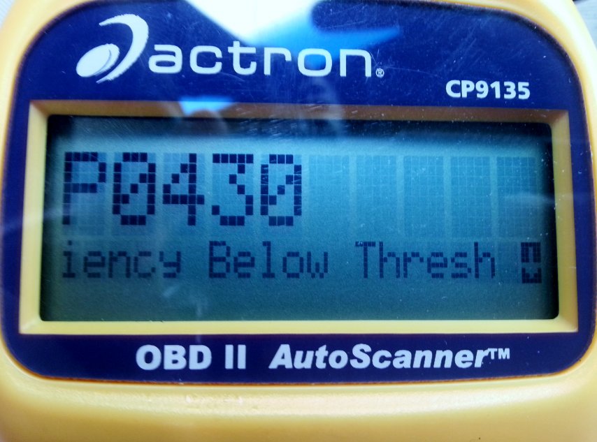

My '97 picked up a P0430 code a month or so ago. I didn't think much of it and erased the code. A week ago, the SES light came back on. I pulled the codes this afternoon and it was the same P0430 twice.
In the past week, my fuel mileage has fell off (1/2 tank of gas in 60 miles). The truck still runs fine, as it always has. I replaced all four O2 sensors (Bosch) at 202,741 miles and performed a complete tune-up and fuel filter change at 218,444 miles.
I'm thinking that with 222,*** miles and the original catalytic converters that maybe it's time to replace them with new units?

4mpg sound a bit impossible without a major fuel leak. i would not use bosch sensors again. delphi or delco only. if you were to put a new delphi sensor post converter for bank 2 and the code came back then yes replace them both. if you can tho first see someone at at a shop who can read the waveform output of all four sensors at the same time. if the post sensors closely mimic the ones in front then the converters are likely inert. i don't think you scanner can even show at least one.
