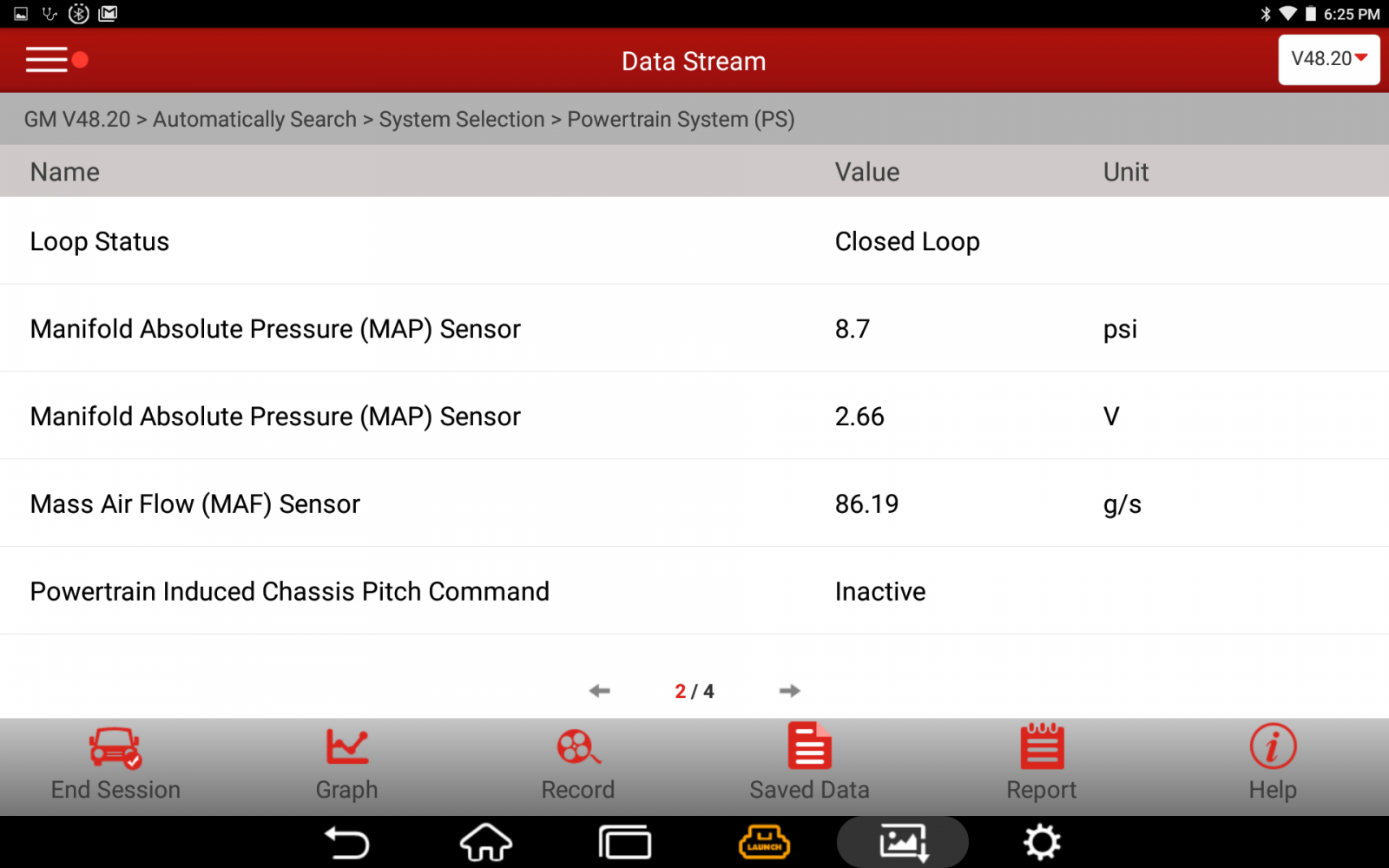

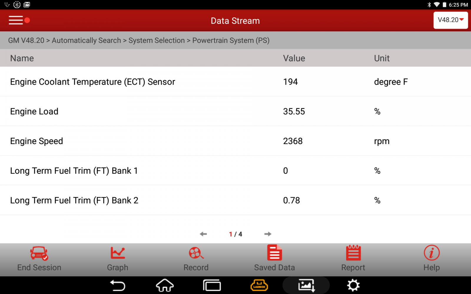

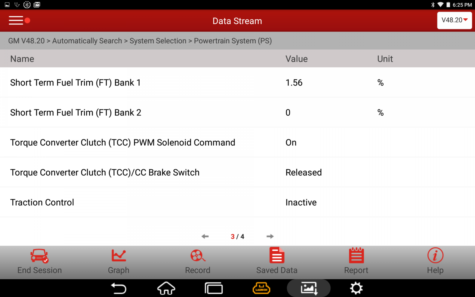

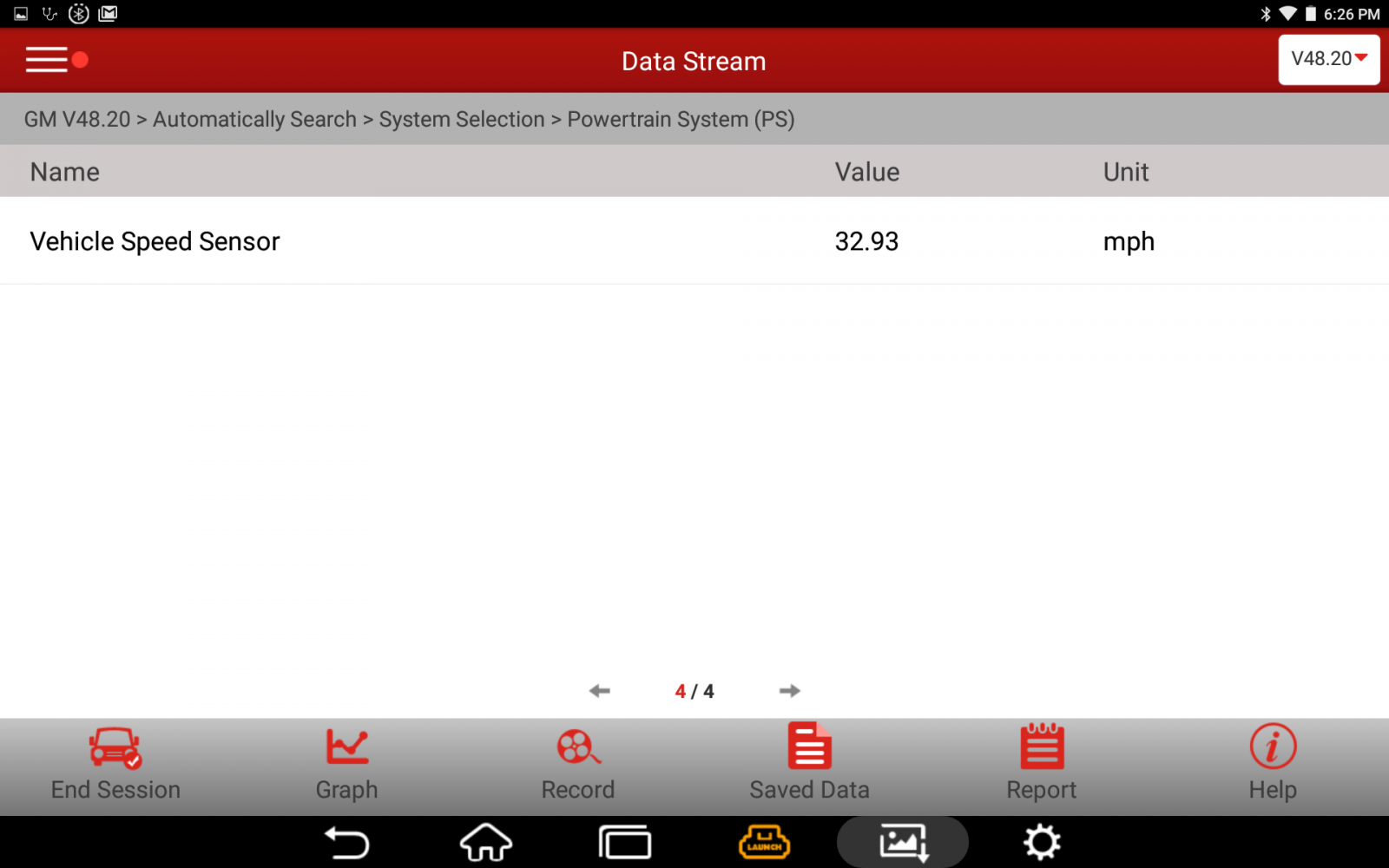

I have a 2002 Chevy Tahoe LT 4WD 5.3L/4L60E that keeps giving a P0101 code. I have replaced the MAF sensor, MAP sensor, checked all air intake piping, smoke checked the intake system with no leaks showing, back pressure tested the catalytic converters, new air filter. I'm lost on what it could be. I've also tried a couple different MAF sensors to be safe. Does anybody have any insight on what I could be missing?
Do you have a scan tool that shows you live data for the MAF and MAP? Might show you if they are dropping out. Might have a bad wire harness or ground wire. Just something I’d check if it were my vehicle.
I have attached the freeze frame data for the P0101. I drove it around a little bit today and it never did mess up of course so I was unable to get live data at the time it occurred. I will keep test driving it every day after work. I know as soon as I go to drive it 35 miles home it will mess up... Let me know if anything in the attachments look off to you!
Donal
Mar 30, 2021
261
376
Americus Georgia
I do not have empirial data, but I would check and clean the throttle body valve and passage. A relearn for the throttle body may be helpful. The Psia seems lower than what I expect. But many engine conditions influence performance. I most always do the add a temp ground thing.
