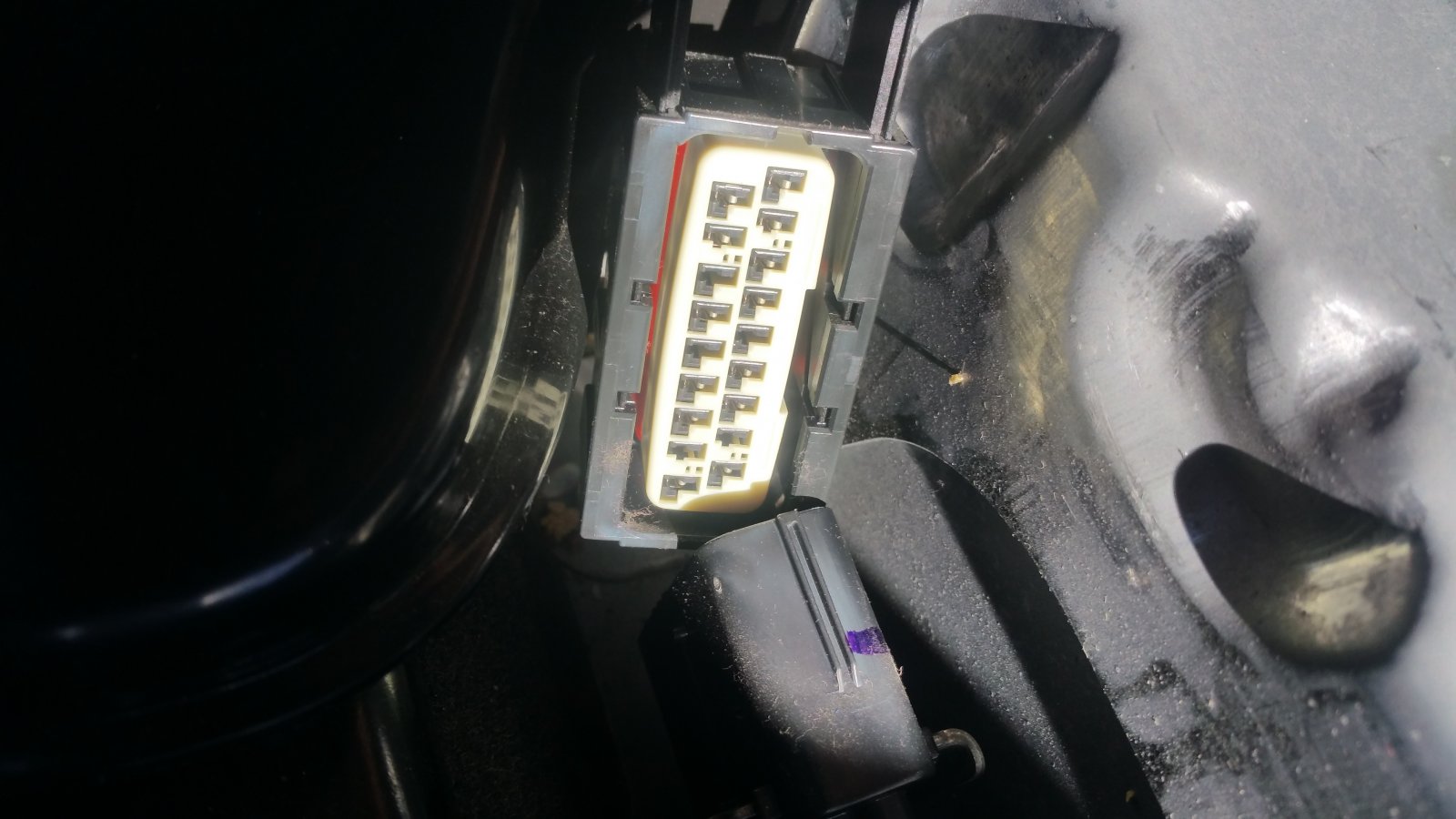

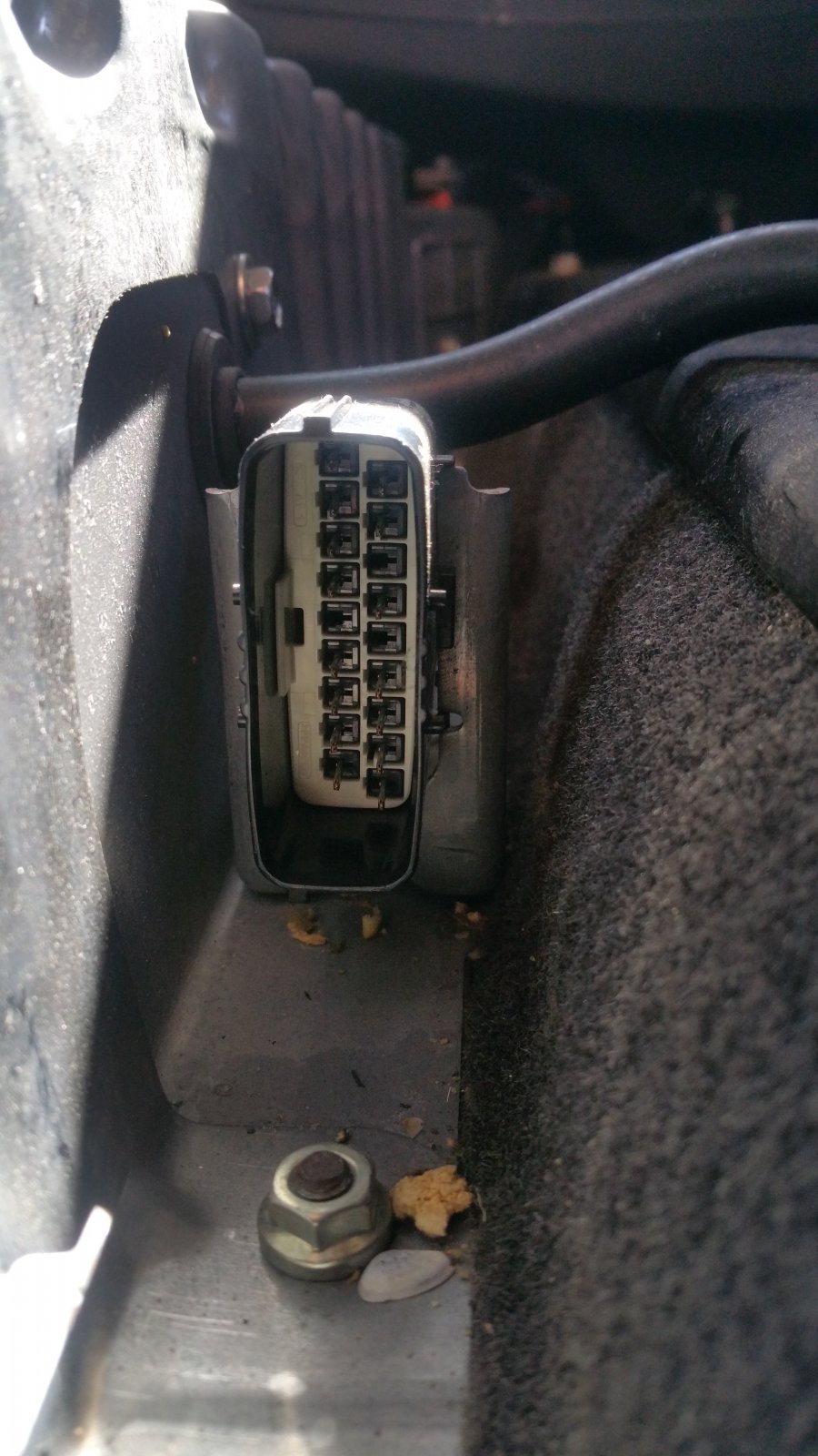

A simple thing you can do is unplug all your connectors and spray them with Deoxit or other type of contact cleaner. Could be oxidation on contacts or not, but a good thing to do anyway.
even if it appears 'clean' it still can have oxidation mciro film it's working with 5vDC so even small resistance changes can cause issues
BG1988
Nov 14, 2018
3,007
1,371
clean each with electrical cleaner or 91% iso (ISO and distilled water check the label before buying should only be the two ingredients )
*DISCONNECT THE BATTERY* so you don't accidentally short things out
this appears clean but even a slight micro film is causing an issue .. for me..
a cheap tooth brush did the job just be gentle but firm so they don't get bent
