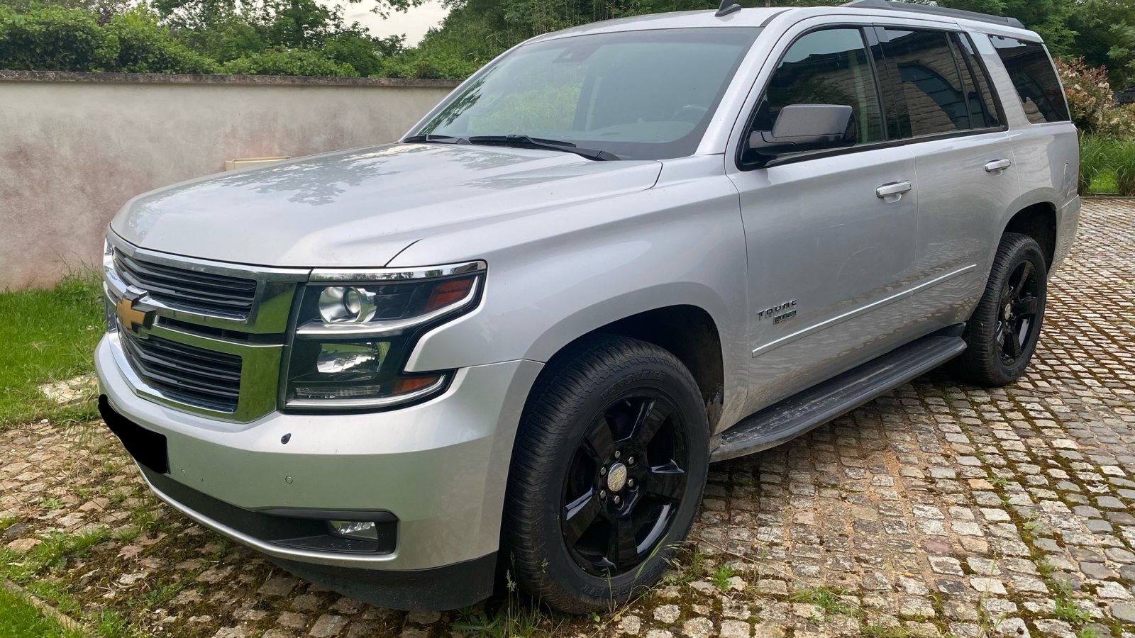

Pics of the truck, please.

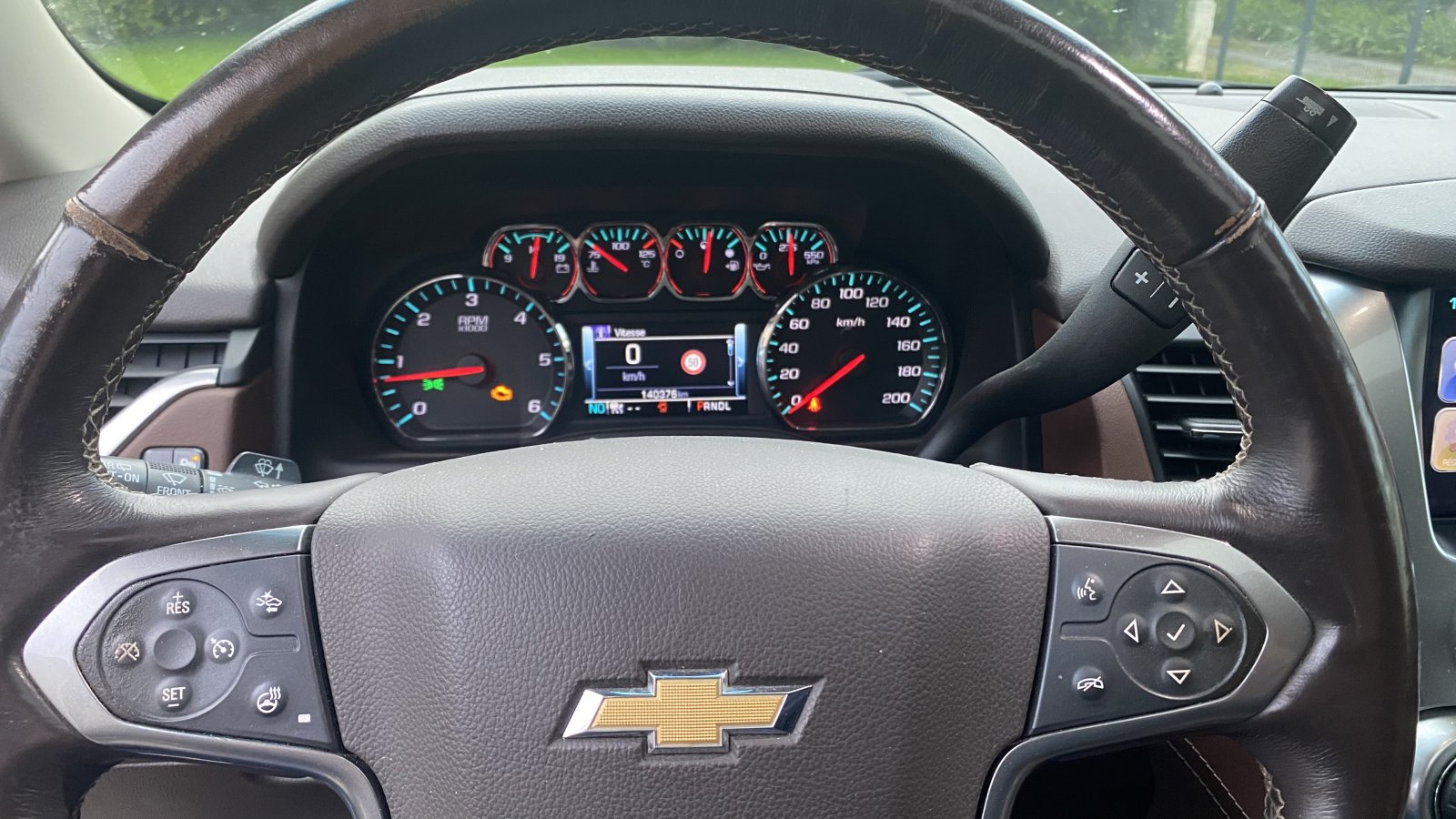

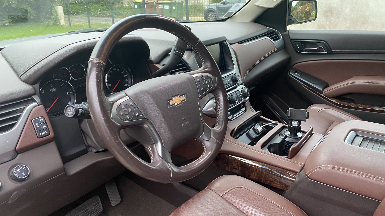

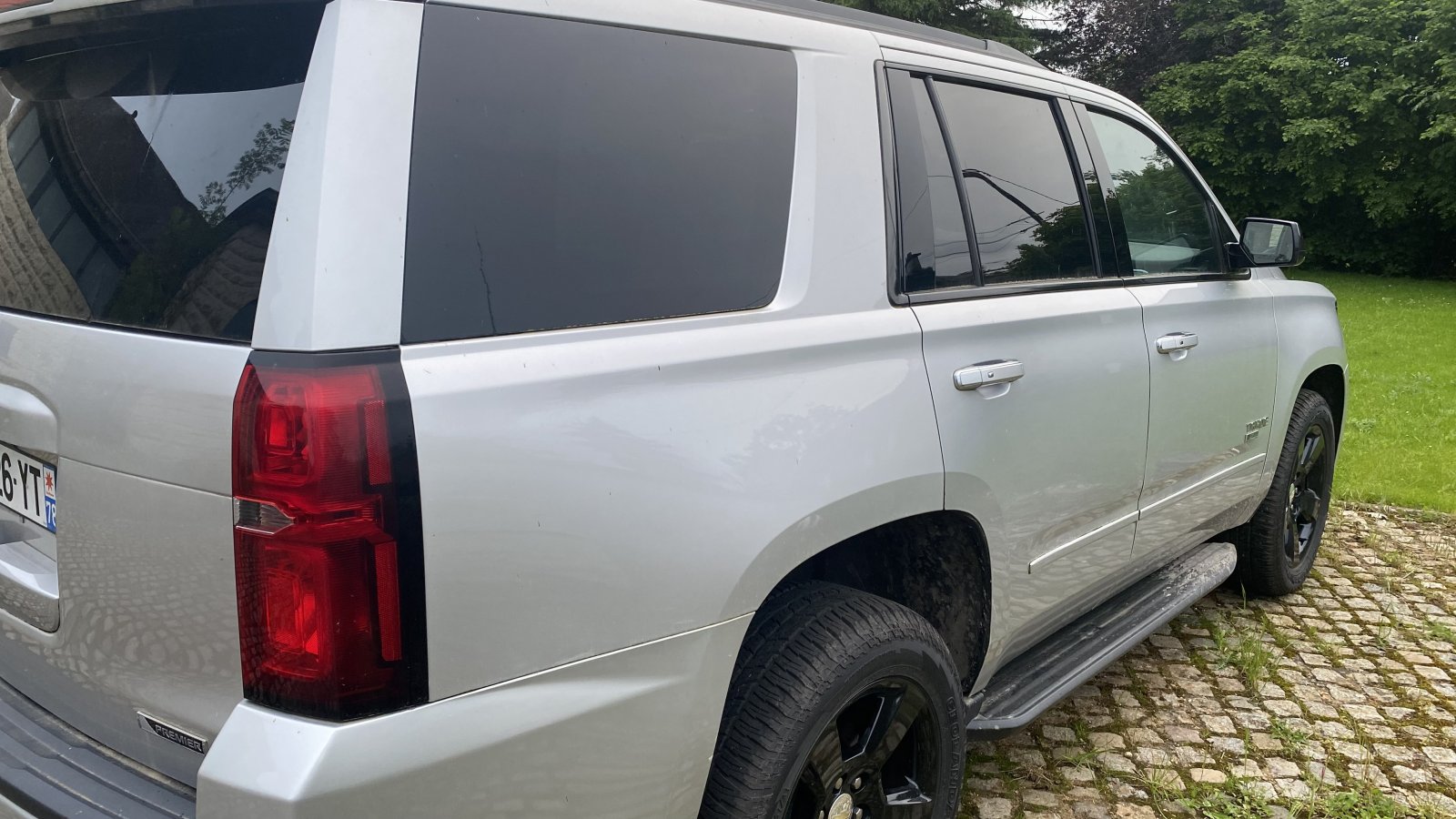

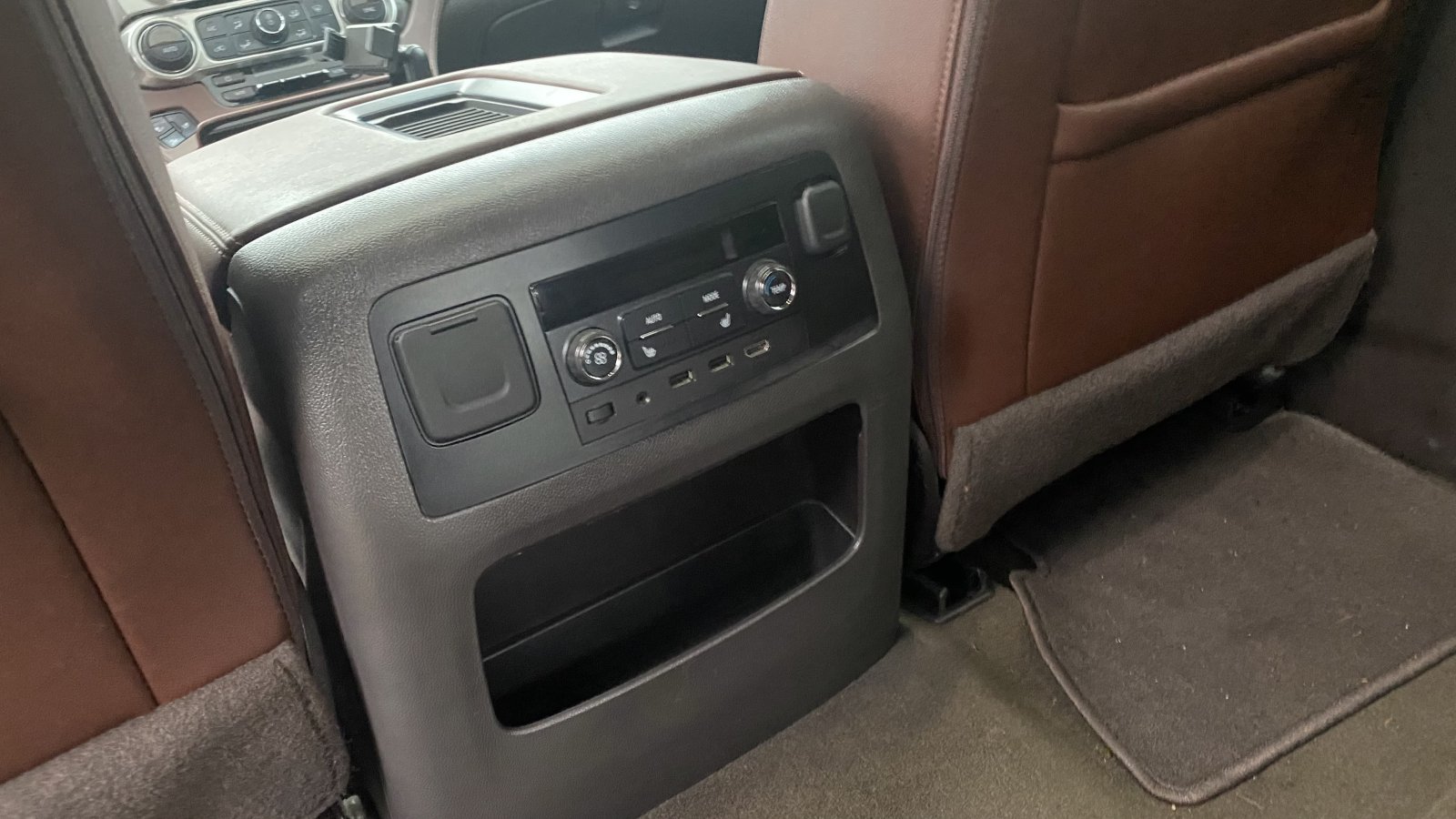

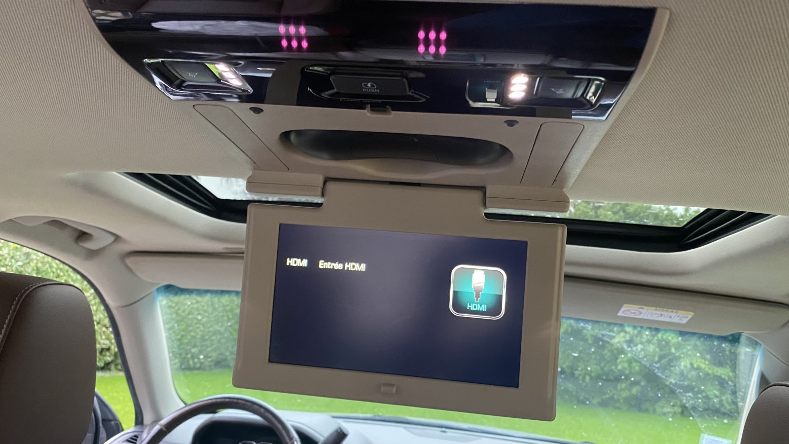

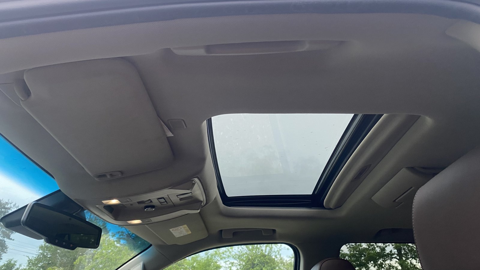

The pics of the car…(my baby)
