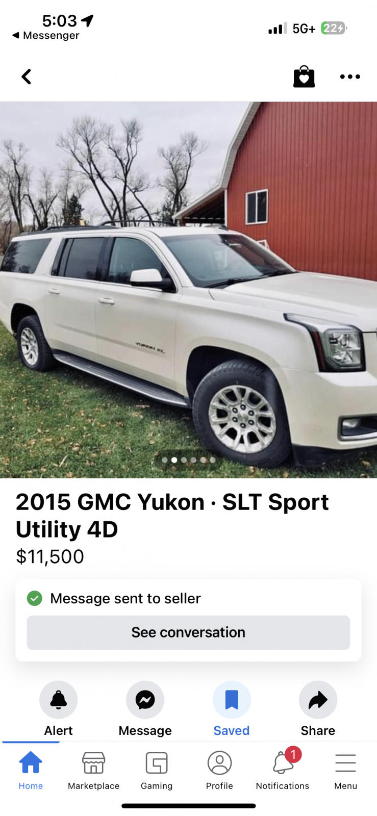

Found the 2015 Yukon XL SLT on Facebook with 200k miles and a blown transmission. Tires were bald, rims pitted but the inside was very clean. Paint was clean other than the front and back bumpers were a little dinged up. Talked the seller down from $11500 to $9500

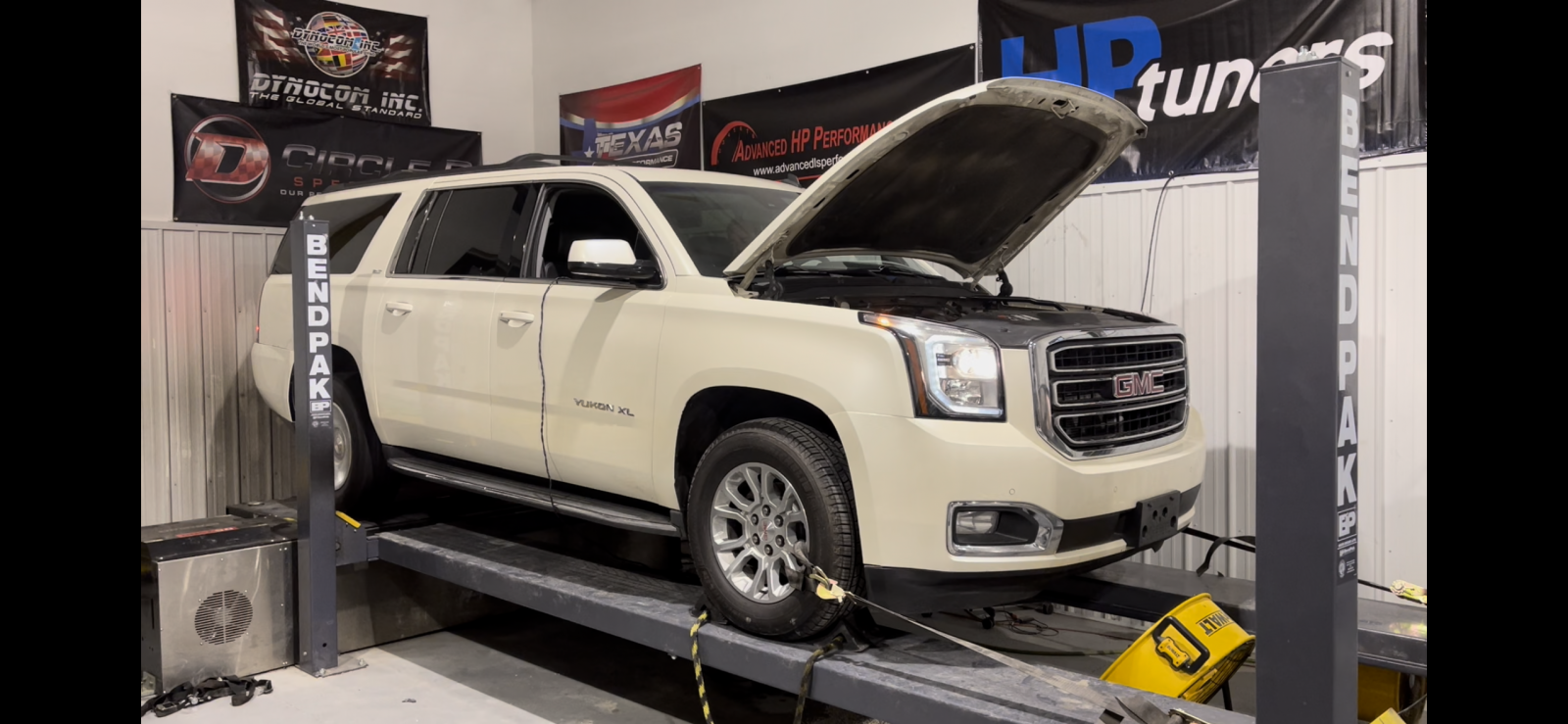

I took the vehicle to Advanced HP in Layton Utah. At the time I wasn’t planning to do any kind of an overland build I just knew I wanted good reliable power. Able to tow with ease and not too loud.
Because of Parts back orders and machine shop delays it ended up taking almost 6 months.
The engine was a 5.3 and in hopes of keeping decent gas mileage we decided to stick with that. The motor was in OK condition when they tore apart but we wanted it built for boost.
It was rebuilt with forged parts and low compression pistons.
.020 overbore.
The ported heads were purchased from Texas speed.
Titanium valves and lifters
Custom grind stage 2 Cam designed by Advanced HP.
Hi flow oil pump
Texas speed long tube headers
And high flow cats. Initially I was hoping to maintain some dignity in the neighborhood so I left the Stock muffler on it even though the builder thought I was crazy.
Transmission is a stage three Circle D rated for 750 hp. Billet torque converter with a +500 stall.
They finished it off with a pro charger DX-1 With the larger intercooler.
The radiator and transmission cooler are from Mishimoto.
Final Dyno numbers came in at 549 HP and 560 torque.
I was hoping for more, the Tuner told me he was going to order a smaller Pulley, a ported intake manifold and insisted that I put a better muffler on it.
But he wanted me to break it in. He did say the tune was fairly conservative and would allow me to still use 91 octane even in lower elevations.
All the parts have finally come in but I am waiting for him to fit me in to finish installing them and do another Dyno tuning. He feels pretty confident that we can safely get to 650+ at the back wheels and still run pump gas even at lower elevations. The lowest elevation in my area is 4500 feet.

Sounds like that was a nice find for <$10K. It's hard to find deals like that.
Yeah I felt like it was a bargain. The body and interior were surprisingly clean. Seemed like whoever owned it took good care of it. I bought it from the second owner who had bought it a month before and the transmission went out and he couldn’t afford to fix it so he dumped it.
