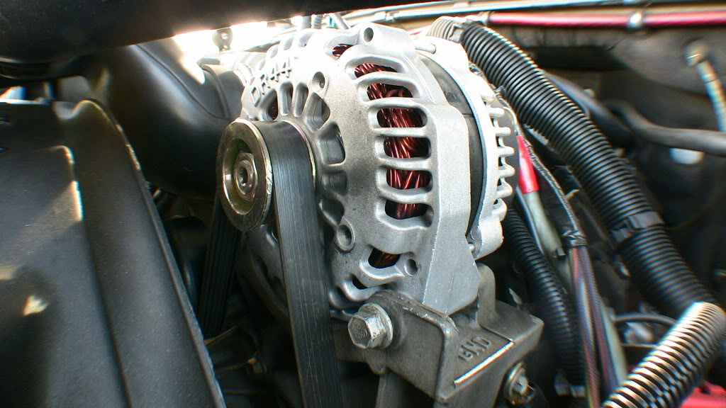

The916
DC Power 270sp :D

thehoe92
how are you cables hooked to that alternator? i guess im meaning do you run like a zero gauge from the alt to a rear battery?

thehoe92
I ran my 0 gauge with a ring terminal from my alt to my 2nd battery instead of coming off the 1st battery. I have a battery isolator but was told but a associate who does audio/video installation for a living to just run it from the alt. Atleast it wouldnt be pulling from the first battery and comin straight off the alt. Makes more sense to me....

thehoe92
You can either do that or just do the big 3 and run 0 gauge from the alt to front batt, then you have your 0 gauge run from the front batt to the rear

The916
the blue you see coming off the back of the alternator goes to the front battery and then from the front battery to the back is a run of positive and a run of negative
the alt bracket also has 2 runs of ground.. 1 going to the front battery and one going to the frame of the car
all in 1/0
I would HIGHLY recommend NEVER running a battery isolator
it killed my Kinetik in the back because it could never charge it all the way
the front battery read 12.6v while the post going to the back battery read 10.8v
you really shouldn't be playing your high wattage system with the car off anyways.. no point considering most amps do rated power at 14.4v or higher
