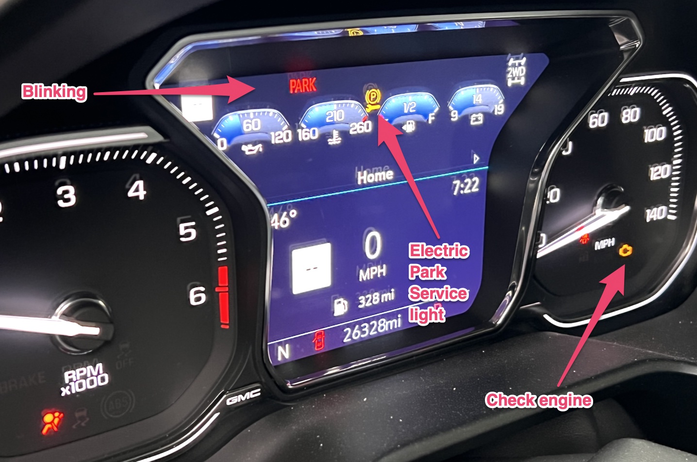

A couple days ago I received an OTA update for my 2021 Yukon Denali. The next day I did a quick start to move the truck into the driveway. It didn't start the first try, had to give it a second push which never has happened. I later got a service now diagnostic email about the airbag system needing immediate service. The day after that, the truck would not start at all and I was getting a low battery alert on the dash along with a bunch of other error messages.
I had AAA come out and jump the car, it was able to start (needed more than the 1200 amp portable jumper he had) and I thought I was good to go. I get in the truck and I can't get it out of park any longer, like the emergency brake is locked. I can shift to D and N but it doesn't go anywhere. The parking light is flashing and now the check engine light is on.
I'm waiting for roadside assistance for a tow to the dealer now, but was curious if this sounded familiar to anyone?
I'm speculating that the battery was drained mid update and something got corrupted during the software update. Everything was completely fine before the update.

one interesting update is road assistance came to tow the car to the dealer and he was able to get it the parking brake off by disconnecting the battery for 5 minutes to get the computer system to reboot. After that I was able to drive it to the dealer. He also did me a solid and followed me just in case.

UPDATE: the dealer inspected and cleared all the engine codes. They're best guess is my battery has been slow failing for a while. It only will take half the charge it's supposed to. They replaced the battery and everything seems to be good to go again, no errors/issues.
So perhaps it was too low to complete the OTA update, stalled halfway through and got the system in a bad state which caused the other issues.
