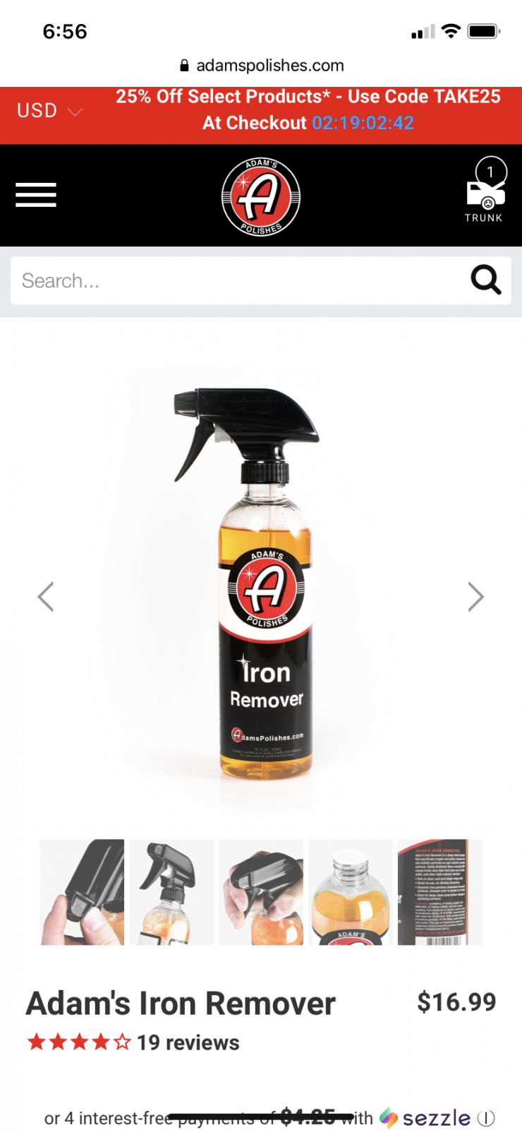

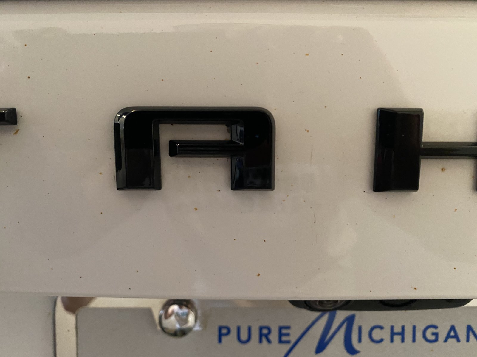

I have a lot of orange dots all over my white paint. My mom had this before on her white equinox and dealer said I think rust and road dirt gets trapped. It’s very hard to remove was wondering if anyone had an easy solution. I saw an iron remover on Adam’s polish didn’t know if that would work? Sorry if this needs to be in exterior...

I’ve tried a version of that from CarPro on Amazon and it does work. It smells terrible so use it out of sunlight in a ventilated area. If you wax your car you’ll want to apply a fresh coat to the areas you used that on.
Clay bar also works to get it off but will require a little more effort. If you don’t have a lot of that stuff I’d go that route to avoid the smell and mess.
I’ve also used mild polishing compounds before too which work to get it removed. Clay bar is my preferred choice as it can be used to remove other stuff that gets stuck on paint/clear coat.
I live in iowa and have gotten that crap on my last 3 white vehicles after the winter season. Not a fan of it at all. :)

Clay bar is the ticket. We live on a farm and had a white golf TDI and the fly poop would wreak havoc on the paint. The only thing that would take it off was clay bar. White vehicles no longer an option for us...

As others stated, clay bar is the answer. I saw this all the time as a detailer at a Honda dealership. The explanation I was given is that it happened while the cars sat at a rail yard during transport and that it was the rust dust from the trains.

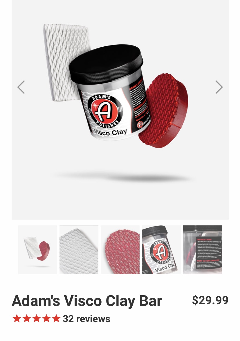

Ok I’ll go for a clay bar, I don’t know a lot about car exterior care and products, definitely a beginner but learn a lot on here from you guys! I found this, had a good explanation on their site. Going to order and give it a go

It wasn’t there when we picked it up, got it last May. I think was over the winter, road dust. This guy explained it really well.

You’ll want some sort of liquid solution to use with it. Normally I use Meguire’s quick detailer along with their clay bar which I think is about the same price. You can pick that up anywhere that sells car cleaning products (Walmart, target, advanced auto, etc).

Carpro IronX spray is what I use. Clay May do it but won’t get into letters and crannies….when you spray it on the rust flecks run like blood down the side. I do it once a year on my wife white Jag, then wax afterward. Do it outside as the stuff smells terrible, but I assure you it does the job…
I got a foam gun coming and a clay mitt from Adam’s. Wash first then use the mitt with a detail spray. Probably try next Sunday the weather might be ok, was 80 today in Michigan and 27 Tuesday wtf!

As said before - iron remover will get most of it out. Clay bar will pull everything off the paint. Since it's that bad - dawn dish soap it - that will pull any grease or wax. Then hit it with the iron remover - wash and rinse very well with car soap - you want it extremely clean before clay bar. Clay bar w/ something slick - mequires quick detail spray or wax will be fine. After this you have a perfectly clean paint for wax, sealant, etc.

Clay bar. It's actually tiny metal filings that attach to the paint and start to rust. Worked in an industrial area near RR tracks and all the cars in our parking lot had it.

Believe it or not, rubbing a wet vitamin C tablet (from the local drug store) might do the trick. It removes rust stains like magic from vinyl around my pool.

Are you using a touch free car wash?
Service manager at my Chevy Dealer where I did business for 30 years, until I decided I needed a GMC instead of a Chevy, swore that touch car washes actually prevented this, so I took his word for it. 2 White Tahoes and 3 White suburbans I owned, and never had this issue since using a car wash with brushes (except for around the emblems, where the brushes didn't scrub the paint well). Net, he siad it is from brake dust, railroad dust, etc...any small iron particles in the air that settle on your clear coat...Winter here in MN was a sure thing to do it too...enrolled in a car wash club at a good quality car wash with rotating brushes, eliminated a LOT of it.

I actually used a touchless wash on my black Silverado once a week cuz was 2 blocks from my office and super cheap. Couldn’t notice orange spots on a black vehicle tho. I always stayed away from brush auto washes cuz was told causes scratches and it did scratch my wife’s black equinox she had before.
I just spent like $200 on Adam’s polishes lol. Still watching videos, but as of now I’m gona power rinse, iron remover, foam gun wash, visco clay w/spray wax and then butter wax. I think that’s the steps that need to be done...? Let’s see if the wife will give me enough time to do that lol...it is her car!

You may think your vehicle doesn’t have these rust flecks….no matter the color…. but one spray of ironX on the sides will show you otherwise.
White just shows it more….

Those that say that clay bar will do it are right - I've used clay bar on my white Camaro for years to handle it - yearly. BUT! I just tried the Carpro IronX for the first time just a week ago, and HOLY COW. It made the clay bar process SOOO much easier. As stated before, cool car, out of the sun. It's a gamechanger.
