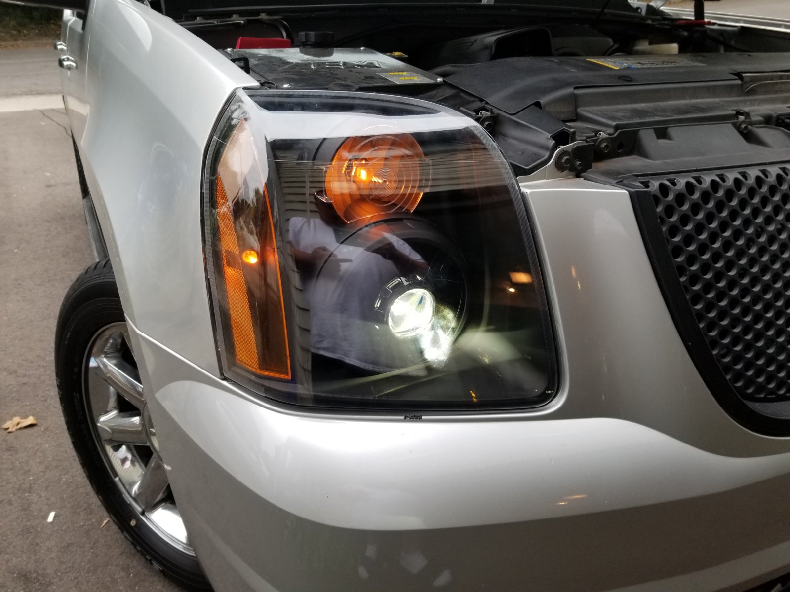

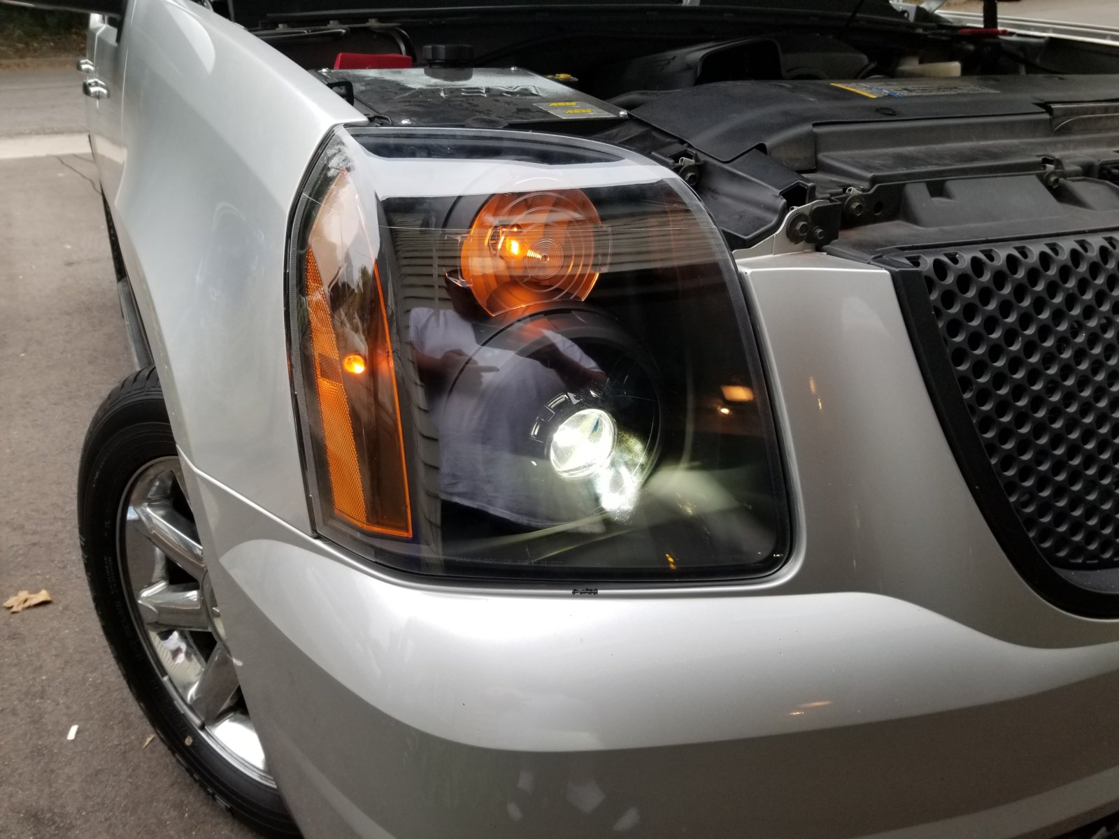

RETROFIT. Ignore the fat asian dude....he is of no concern.
Also, like double.......said. LED Signal bulbs with resistors complete it nicely. The factory road lighting is horrid. Even the fogs are better than some, but not great. TRS/MORIMOTO sells actual Plug and play LED fog light for 07-14 Yukon/Tahoe with the round foglights.
I wont lie. I expected a bit better lighting from the fogs. They are good, but I wish they were brighter. The possibilities of getting better lighting depends on your budget and time. Good luck.
I'm still going to keep looking for fogs, I replaced mine, and they are bright when looking at them, but the light is scattered everywhere(it lights up trees), fogs need a focused beam...
Check out the Morimoto LED Fogs for our bodystyle. Google and youtube will be your best friend here. Many reviews and for $200-$220 and replaces the whole fog light.
