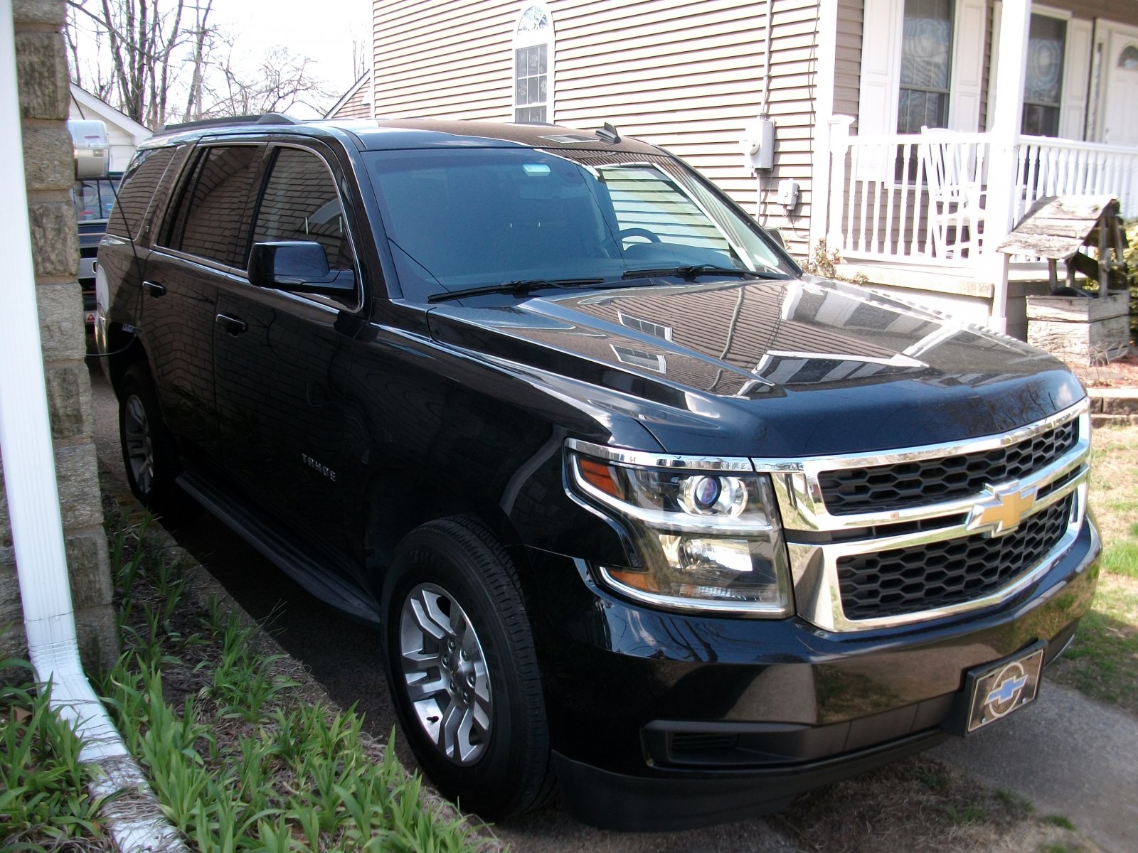

Well as some of you know, I have a 2015 Tahoe LT 4 WD and I have a ZW7 option. Now I have searched for the corresponding front and rear shocks, and frankly I'm now as confused as well. Each vendor I ask, comes with a new, different designation. ZW7 is gone and nobody at GM parts direct now's has any idea of what replaces it.

Well as some of you know, I have a 2015 Tahoe LT 4 WD and I have a ZW7 option. Now I have searched for the corresponding front and rear shocks, and frankly I'm now as confused as well. Each vendor I ask, comes with a new, different designation. ZW7 is gone and nobody at GM parts direct now's has any idea of what replaces it.View attachment 234297
Post a picture of your RPO sheet when you get a chance.
