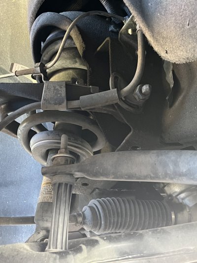

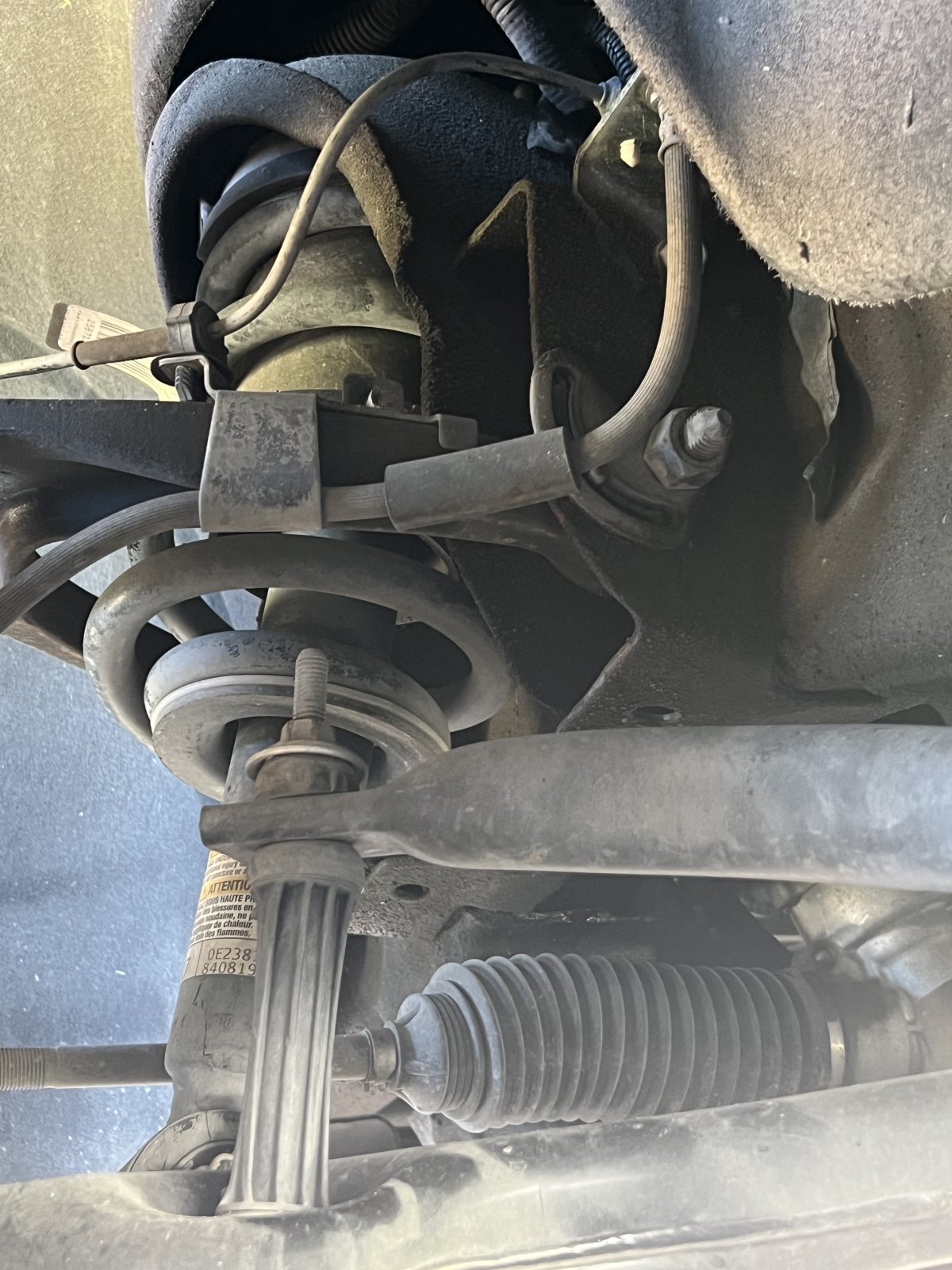

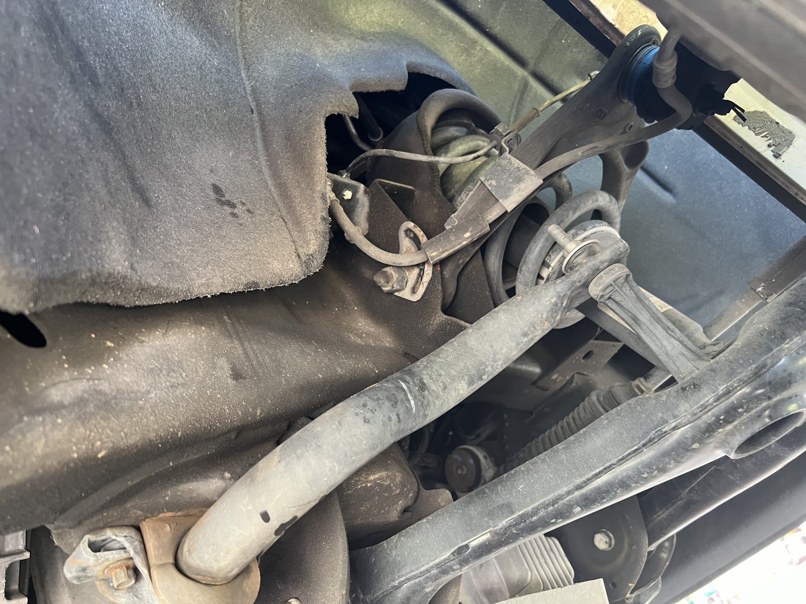

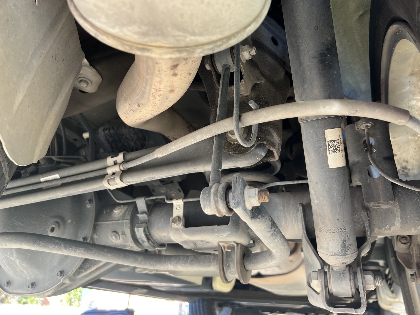

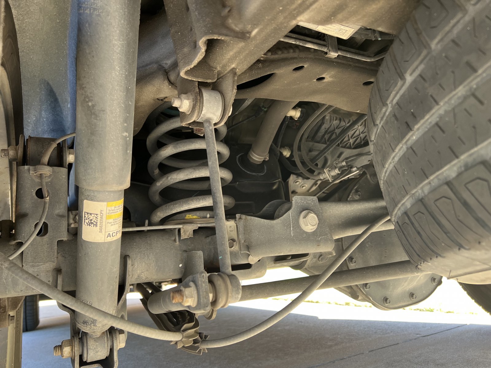

Here are some pics of the suspension. Hope these are helpful to anyone who might be willing to offer some guidance.

Your 275/65x18 tire has enough sidewall to provide some cushioning on the road, and I'm not sure how a higher profile tire, like a 70 profile tire, would fit without rubbing.
From what I can see, the shocks are not leaking oil, and that is good. One of your end links to the front sway bar has a rubber isolator that looks about shot, so I'd look at getting new end links for the front sway bar.

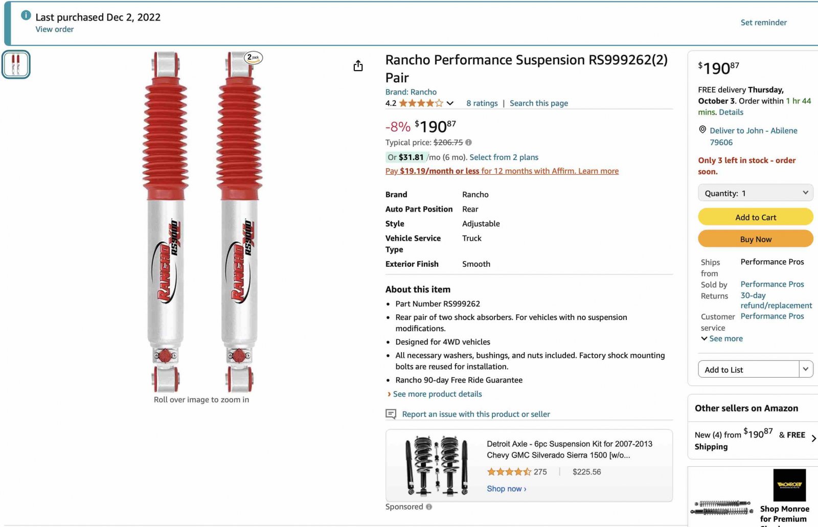

When I purchased my XL SLT it had 18" tires and original {looked original} shocks. I bought some 20" Wheels/Tires {Pirelli Scorpions} & put new Rancho 9000's on the rear, much better ride and quieter tires. Getting ready to do the front shocks...
