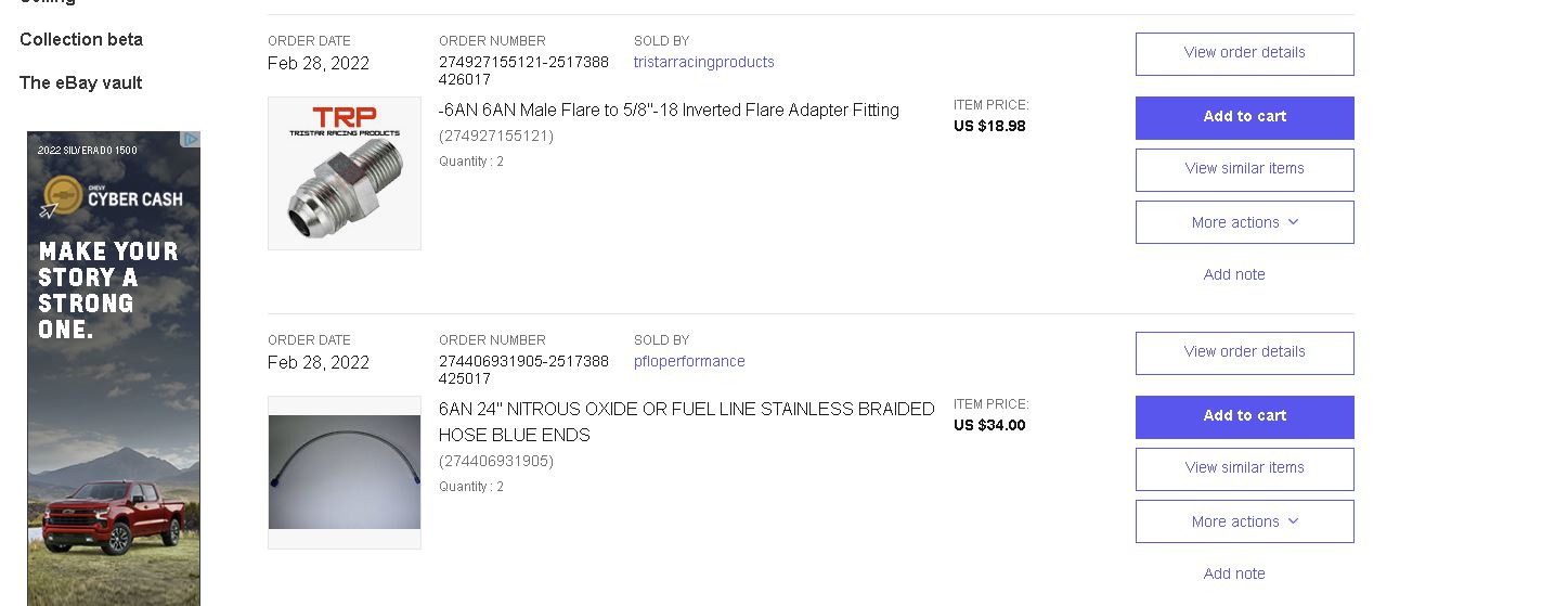

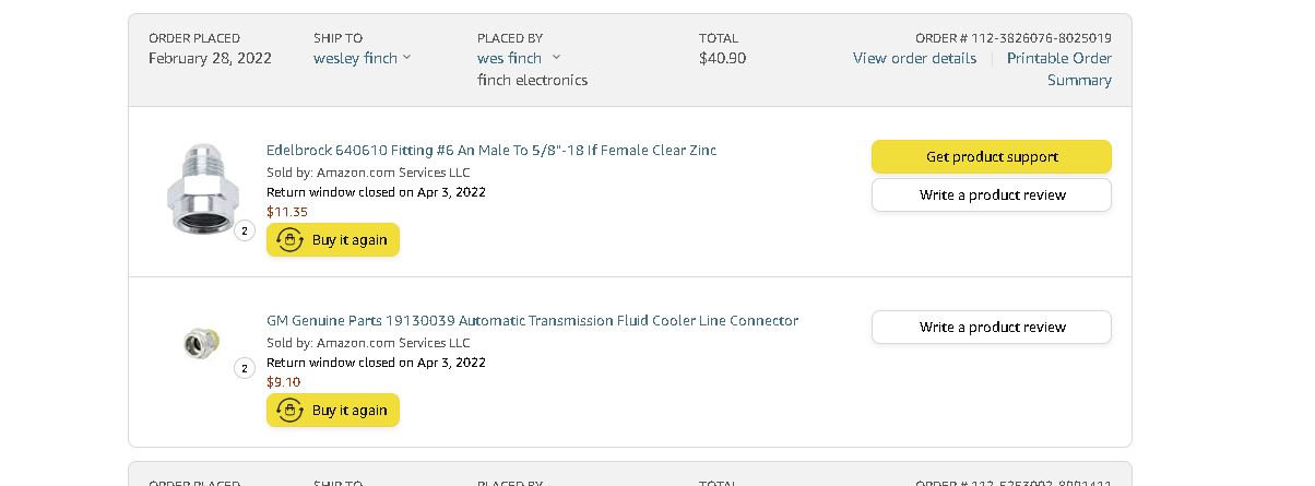

if you are using the trucool then these are the adapters and lines you need 2 of each
BTW the an lines referenced below hold like 1200 psi far and beyond external trans line pressure
first pic is amazon, 2nd pic ebay

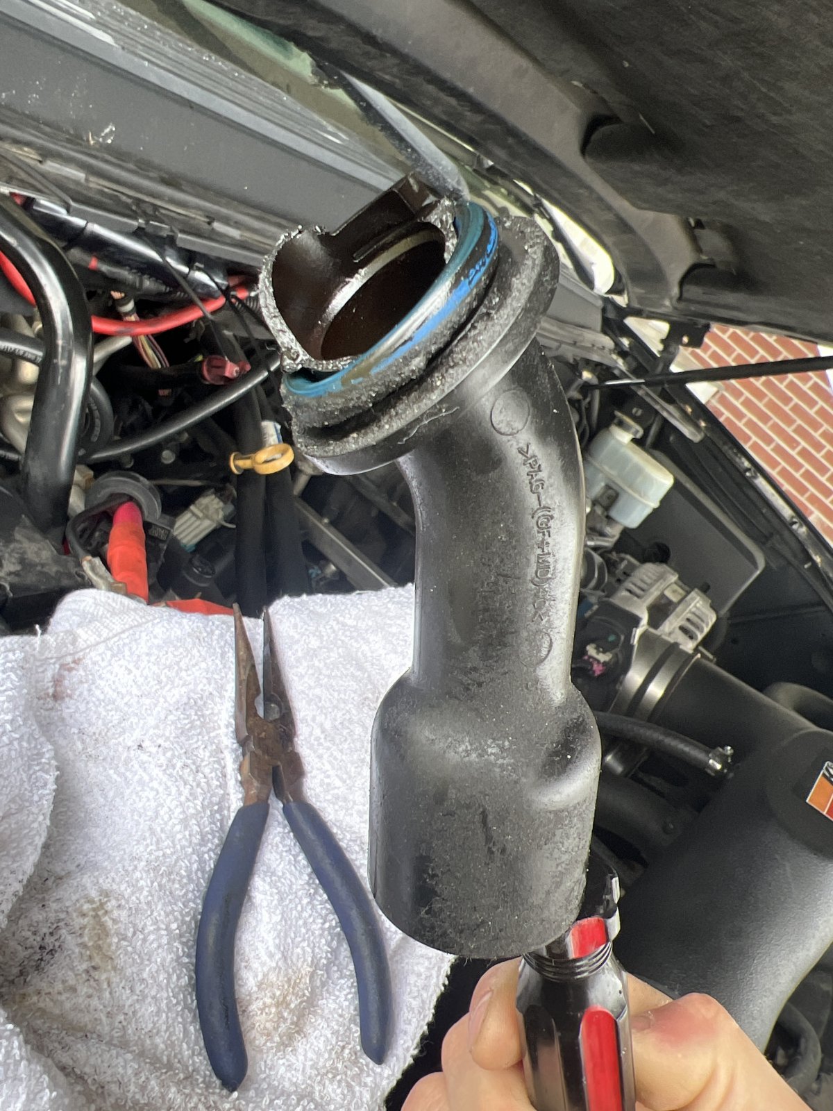

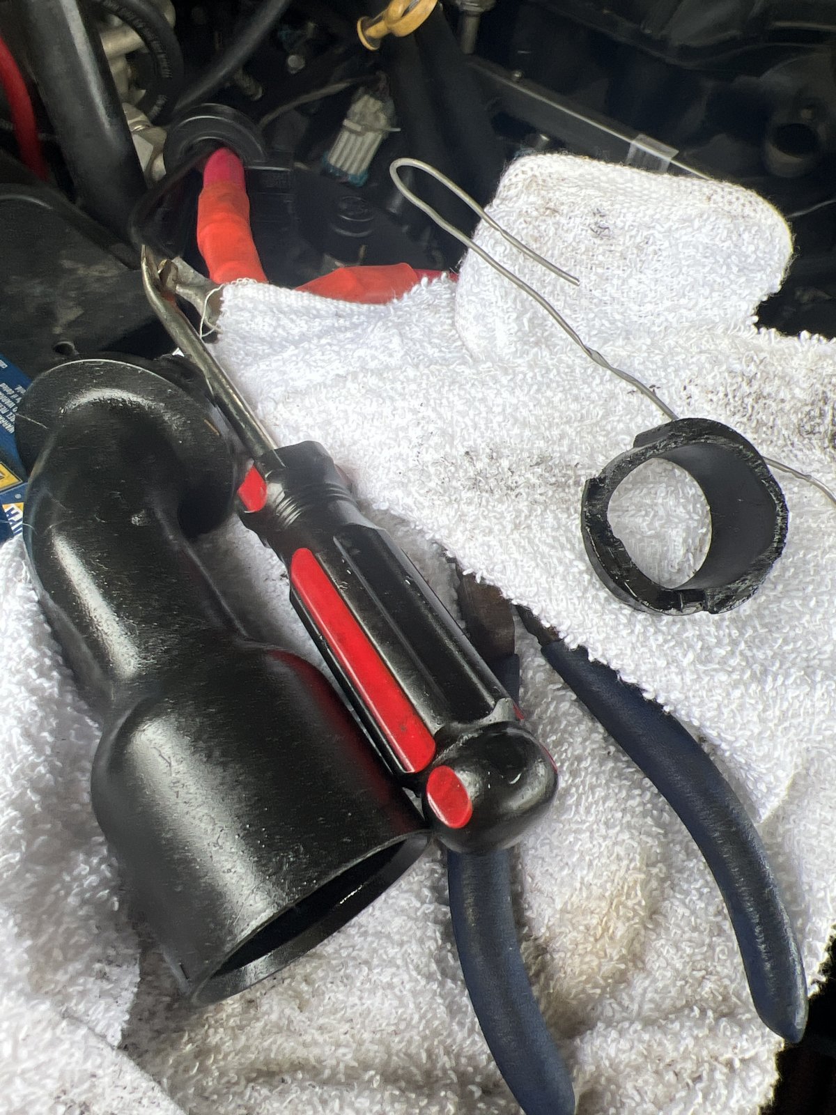

Guess what’s inside the valve cover now!

View attachment 394094Guess what’s inside the valve cover now!
If I diddnt have bad luck I wouldn’t have any luck at all!
Not a big deal to pull the cover off to remove the debris. Just throw that PITFA POS extension neck in the trash. The oil cap will fit nice and snug directly to the VC. You'll just need to use a funnel to fill now that's all.
Yea I know I just diddnt want to pull the valve cover but more then likely will have to
It happened yesterday
I left today and won’t be back until Sunday night And I go to work wensday
You can look in there with a flashlight and use one of those gripper tools to get anything out of there. Broken piece shouldn't have gone far unless the engine was running.

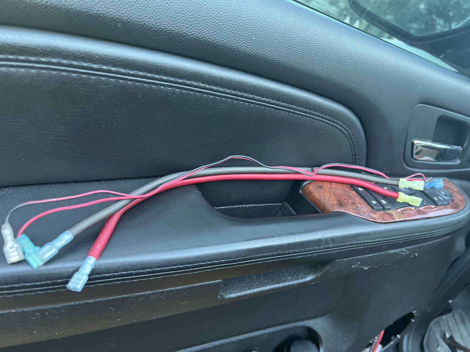

New speaker wire in the doors pre gaming for the highs amp
Beside it is the stock wire
Pretty over kill but screw it
