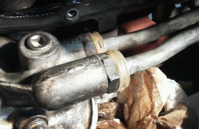

I had removed the filter adaptor from the block but not the lines. See that for proper cleaning this will be needed. Figures the tool needed is not on hand. A metric wrench with a pretty slim profile/thickness. There are what appears to be milar/plastic bushings on the oil lines right at the connection point that interfere with a wrench of normal thickness. Kind of look like a quick disconect fitting actually. Simular bushings on the tranny lines where they connect to the tranny.
Ok, time to find a wrench....

HardKnox
Mar 13, 2013
A shot of the lines and connectors....The more I look at these connectors the more they look like a disconnet point. More than likely a specialty tool. Kind of to late to call NAPA or the dealership today. I did run to the parts store and picked up what looked like it might work, and the clerk seemed pretty confidant but it does not work. Basicly a split circle disconnect tool for fuel lines and such.
I have taken a couple better pictures but imagine if anyone recognises this part they dont need a better picture :)
I have plenty of cleaning and prep work I can do for now.
