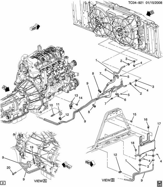

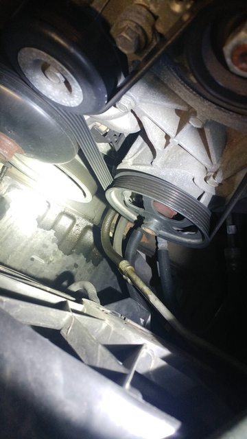

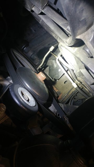

Hey guys!
Popped the hood today and noticed a few lines seeping. I just want to double check with you PPV vets before I go ahead and order parts.
Correct me if I'm wrong... but the lines going into the radiator on the drivers side is for the oil cooler, and the lines going into the radiator going into the passenger side is for the trans cooler.

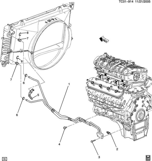

With that being said. Since this is a PPV I believe I need lines for the HD trans cooler right? I have pulled up the following part numbers:
Trans Cooler Line: ACDELCO 25999420
Oil Cooler: ACDELCO 20828695
Is there anything else I'm overlooking?
Thank you!

You are correct.
I replaced my oil lines a few weeks ago. My lines were seeping pretty bad.

You're good to go :)
This is what I used = ACDelco GM Original Equipment 20828695 Engine Oil Cooler Hose Assembly
I did not drain my oil.
I had just changed my oil before changing the lines. Why, don't ask :) I just unhooked them and pulled them off. Just be prepared for some oil to drain, not really that bad. I did unhook the top to help them drain.
