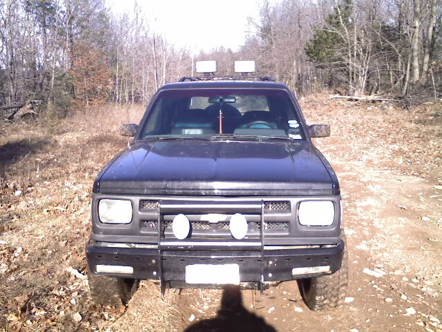

Got some lights for new bumper. There not wired yet, I'll do that this weekend. (Procomp 100 Series 55 Watt 4x6.)
I want some badass lights for the light guard, any suggestions? Nothing to pricey but I want it to look mean and bright.

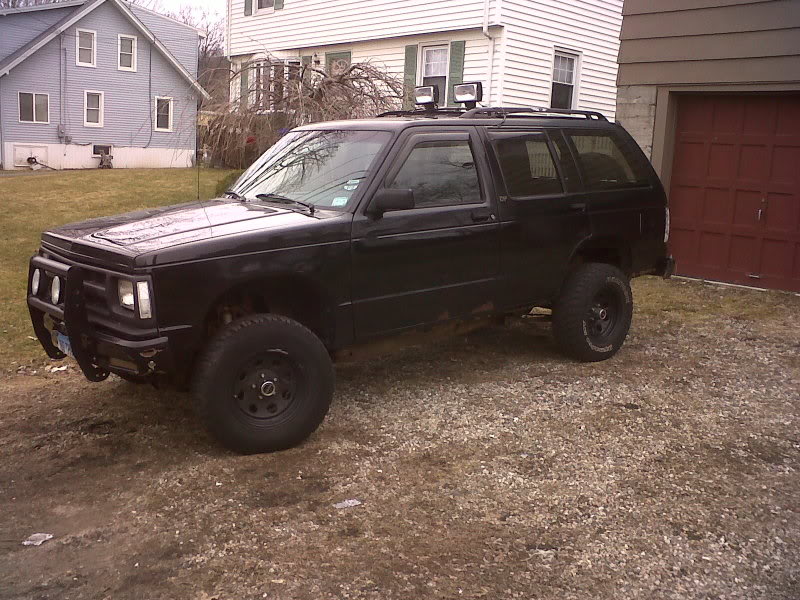

I know you could just tap into the parking light circuit and they would probably work without any issues considering they are only 55watt. Now on to some bright lights, I have a pair of Bosch-profi 210 "I think because i pulled them out of the trash" but they are 6" tall and 9" wide they use an H3 halogen bulb "$8 each at autozone" but these are freaking bright, my friend has toughs glasses that turn black in the sunlight. Well he was standing about 2 feet in front of my truck and i turned them on and his glasses tinted, this was at 10:00pm so there wasn't any sunlight. Best of all they are waterproof! Heres a link to what they look like, and a pic of how they look on my truck.

Thanks for the input guys, hopefully I'll do it tomorrow morning, I could really use some extra driving lights, BTW Thats a sweet ride Drifter666 no joke, its mean lookin.
