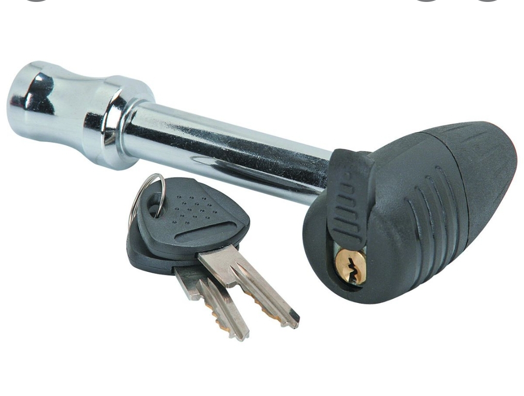

I use a Convert-a-ball cushioned ball mount and a locking pin that has the lock at a right angle

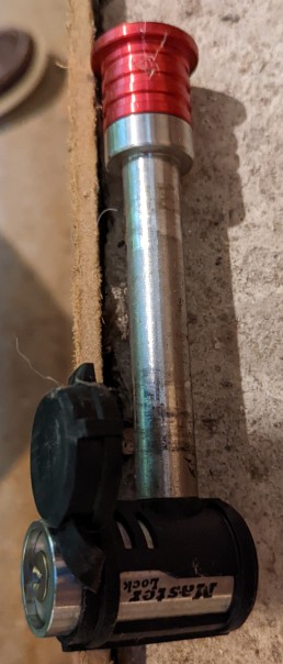

Been there, done that. I even had to cut one off to get it out, as there was not enough clearance to get the key in.
This Master lock works great, without having to mess around with or relocate anything.
