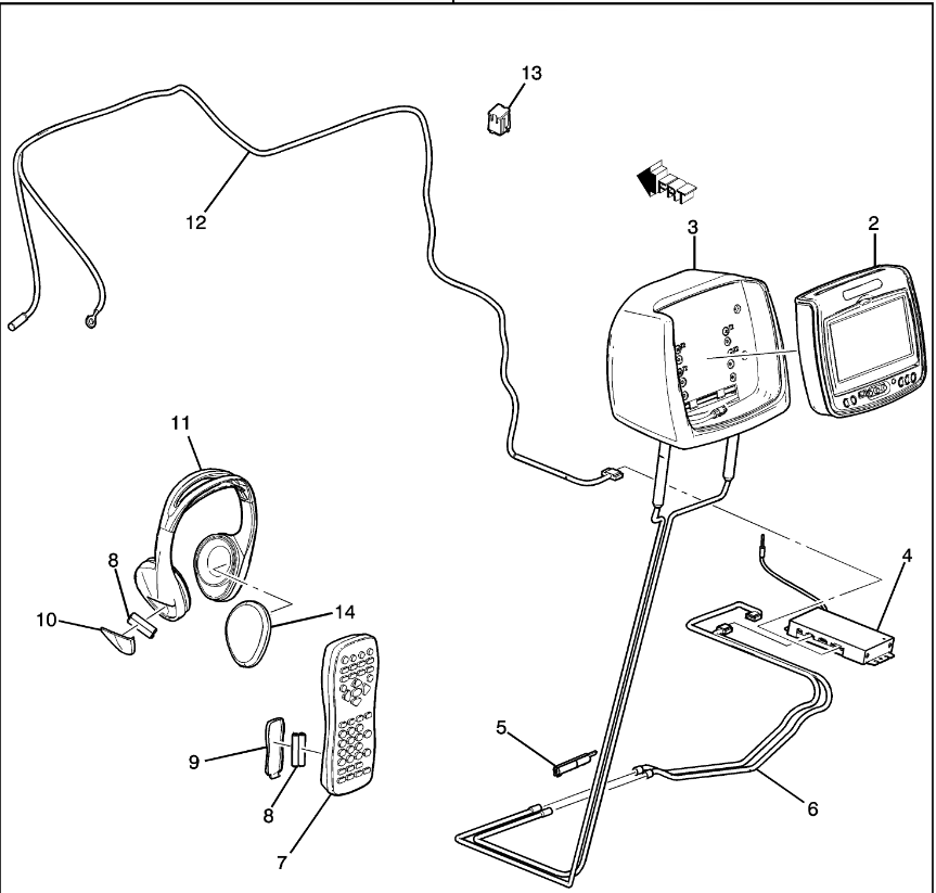

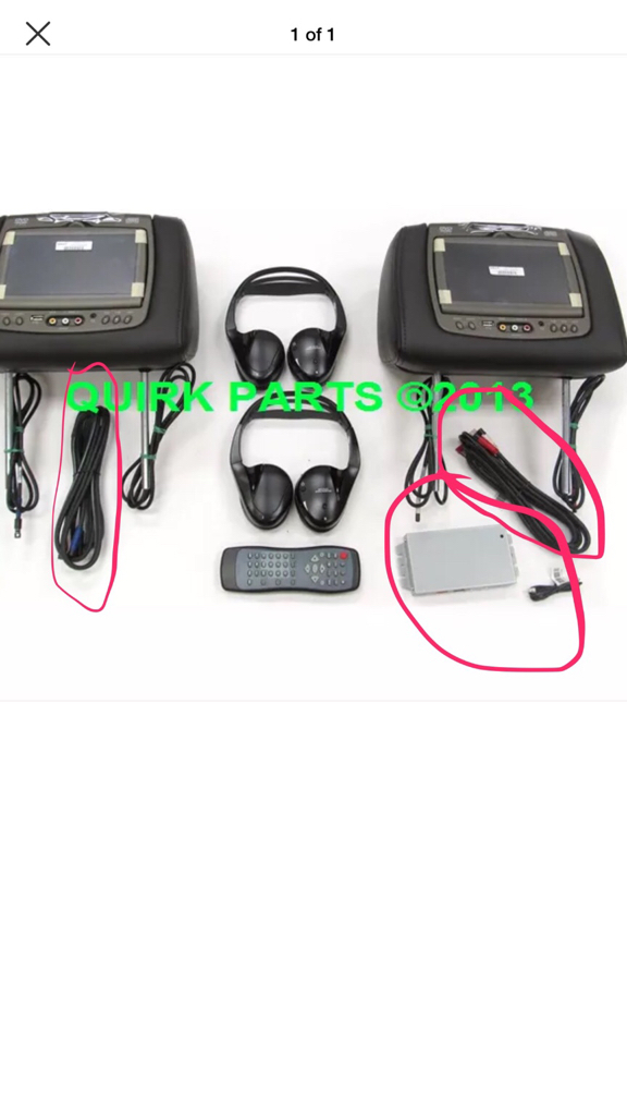

hi guys - does anyone know the part numbers for the items marked in red in the pic? so the wiring and the module. the guy im buying the headrest has the headrest, remote and headphones, thats it.
thanks in advance
08grey
Jun 17, 2012
4,596
725
Don't do it. Even though you can find anything those are gonna be a hard find. That's the connection cable to the brain. It distributes the power and video signal. The remote also talks to that box through the tv.

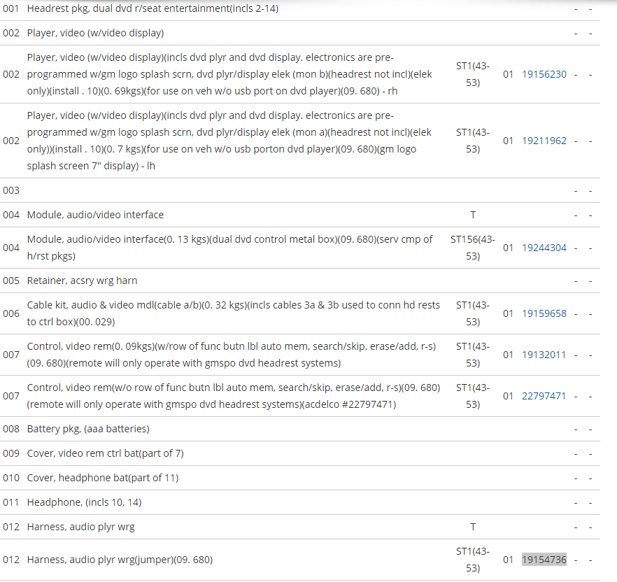

adding some info on the invison headrest part #s for anyone looking for them in the future
