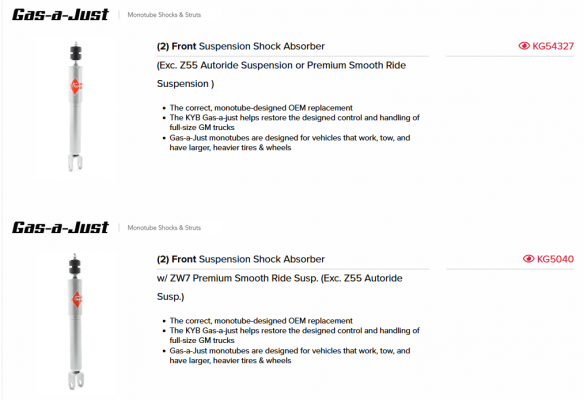

I don't see a GM front shock listed for RWD ("C"). I can recommend a good aftermarket front shock, the KYB Gas-A-Just version. Here's a snip from the KYB catalog (my Premium Smooth Ride suspension got the KG5040s):

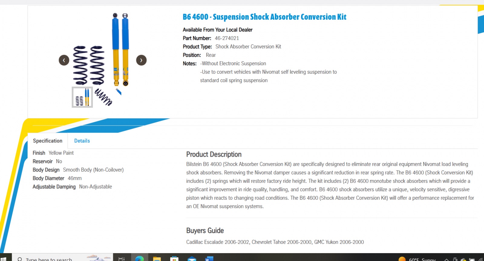

In order for you to safely use standard rear shocks (instead of self-leveling Nivomats) the rear coil springs will need to be changed to a stiffer spring.

You have the same suspension as I do on my 2001 4WD 5.3. After some research I installed Bilstein B6-4600 front, seems like can’t go wrong with this choice. There are plenty of other good shocks but to maintain stock lift, most enthusiasts would be really happy with Bilstein, unless they hate the baby blue /lemon yellow color. The spec for my front shocks are Bilstein model B6-4600, part number 24-065009.

Bilstein makes a kit for the rear, below.
