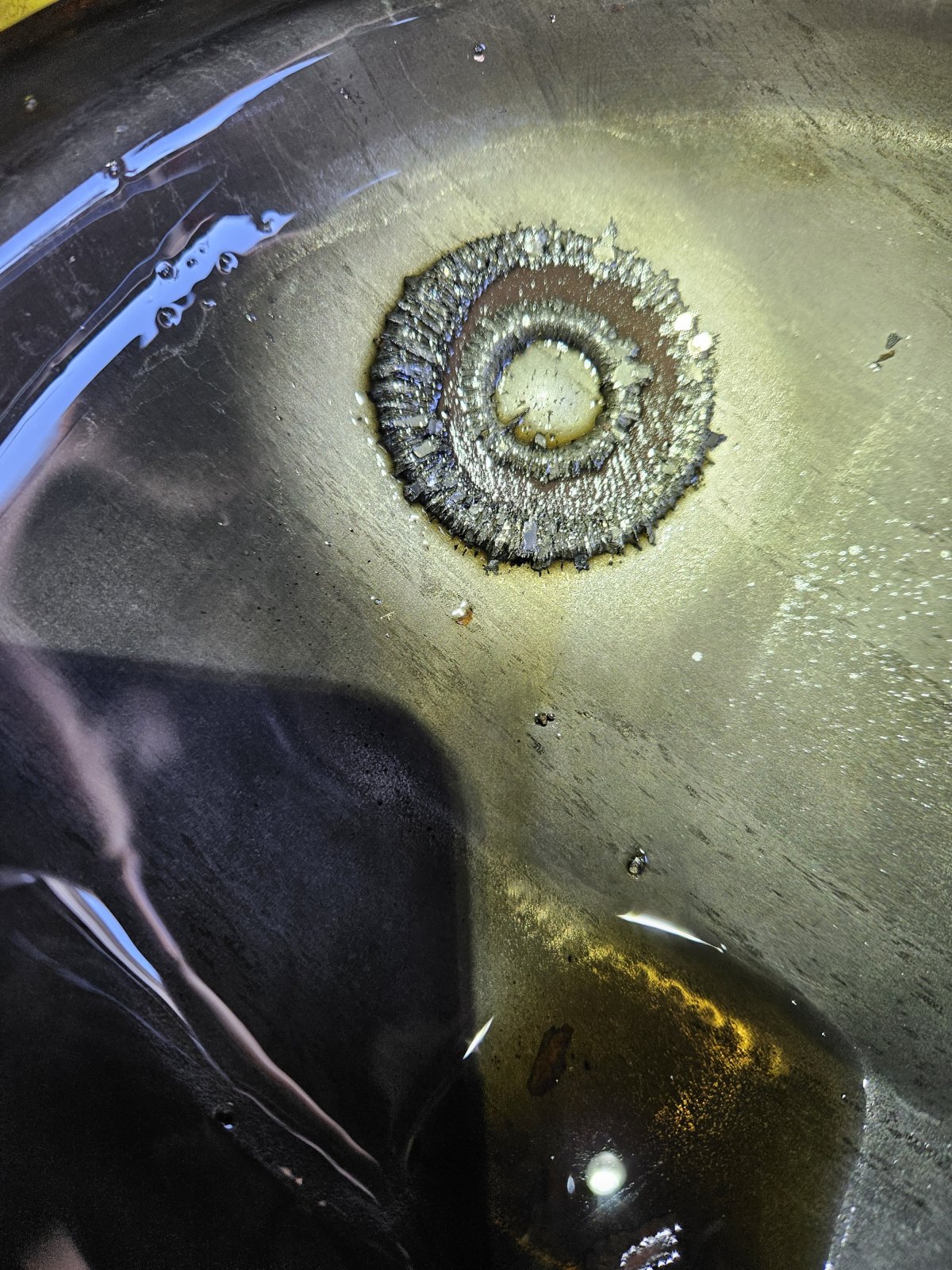

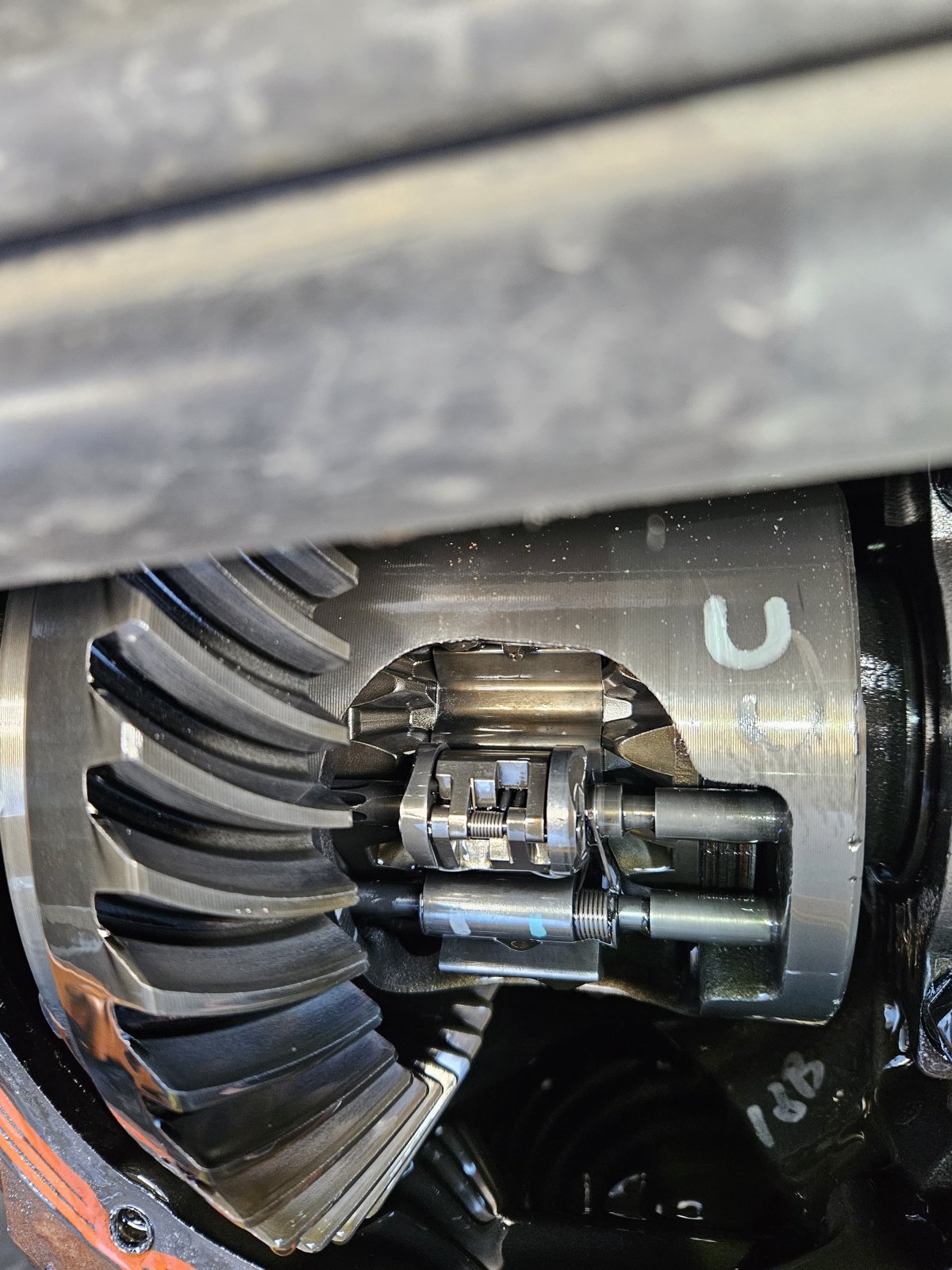

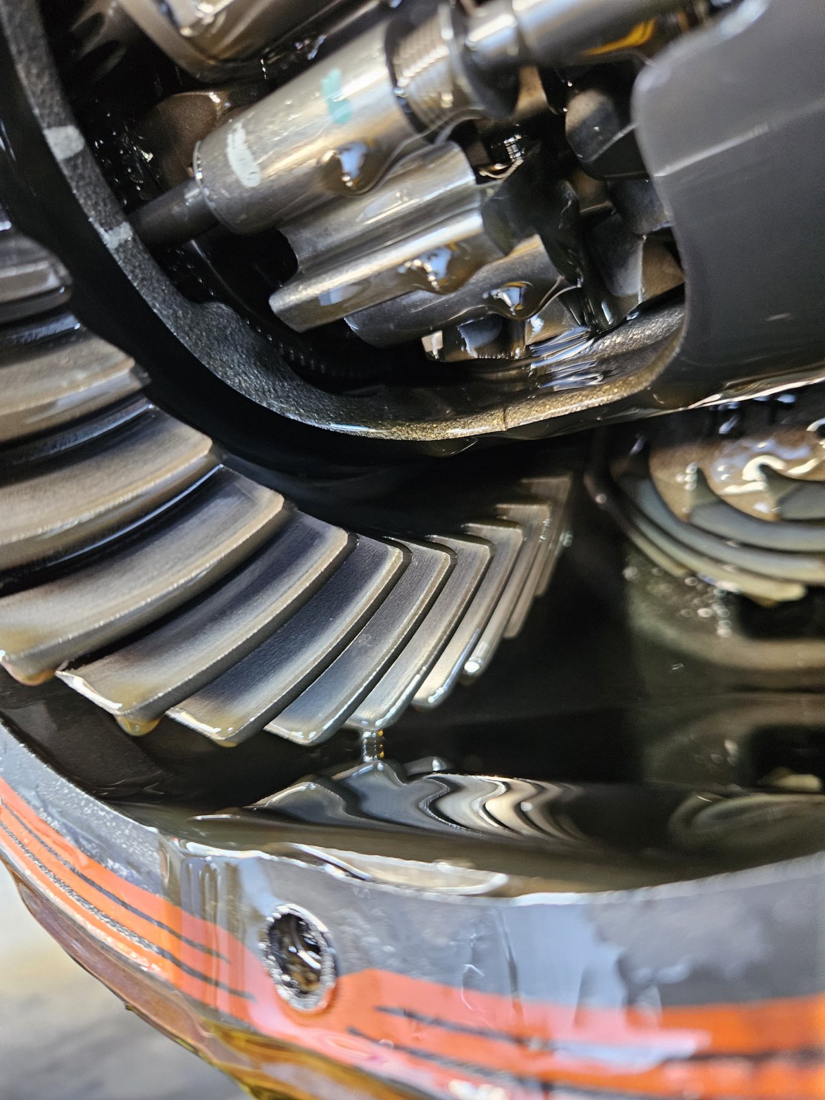

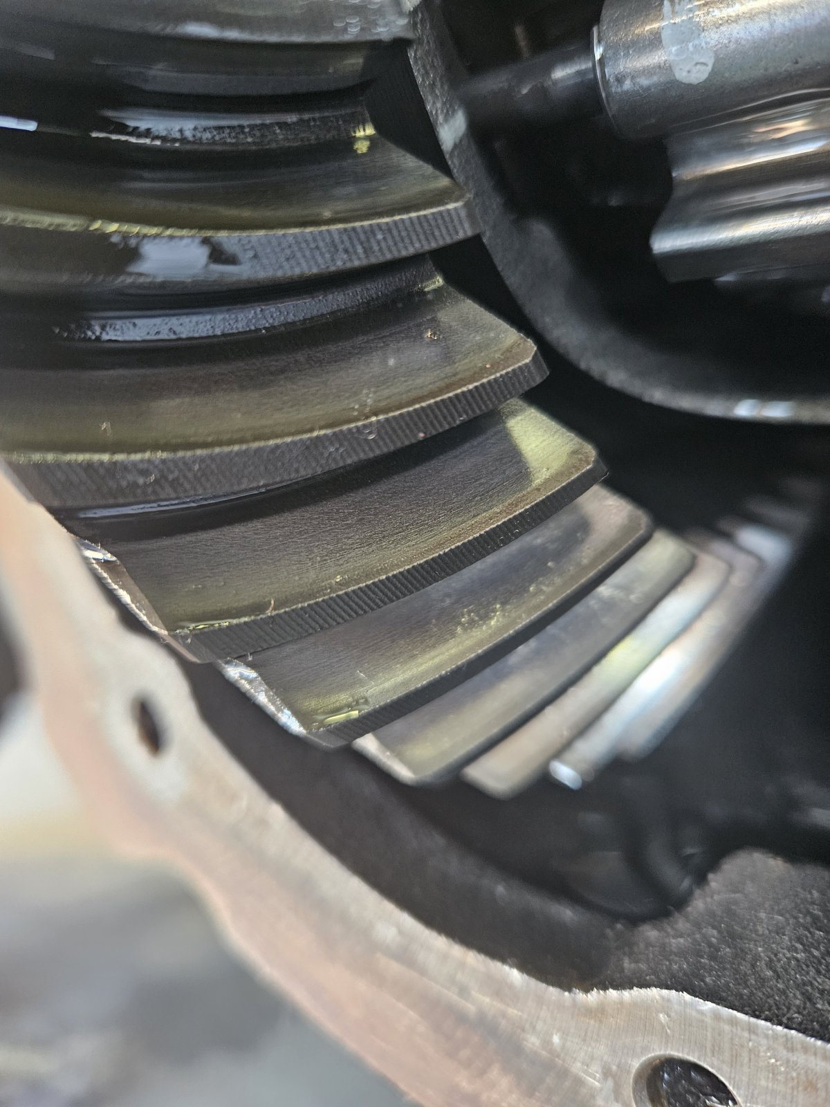

Serviced the rear diff and didn't notice anything abnormal. Refilled with RP 75W-90. Still have the noise. I'm getting the tires rotated and balanced today just to rule that out.

Shop diagnosed today and says it's definitely ring/pinion wear and needs to be replaced.
