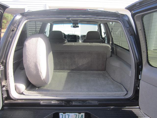

Anybody know of a tutorial on how to remove the rear interior side panel? I have a large ding in the quarter panel and the dentless guy needs that stuff removed and I wanted to do it so that there is no rush to pull it out and break whatever plastic clips holding it in. Thanks.

You gotta remove the rear trim pieces one screw each, then at the bottom rear of the panel there’s a clip holding the panel just pry up on it then you pull that whole panel out pay attention ro the front part of the panel by the passenger seat belt
