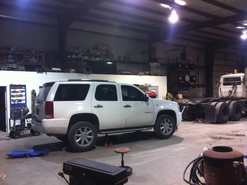

Annoying squeak from the rear while moving. Thought for sure it was a brake or ebrake problem. It was not. My buddy said rear drive shaft and he was right. Sprayed some pb blaster and it went quiet for a few days. Now it is back so I guess I need to replace ujoint. Do most people just replace the whole driveshaft?
Thanks
bmwme
Jan 28, 2011
179
So not that anyone else cares ;) but I replaced my ujoint today. I can confirm the PO statement about the tight fit. I didn't want to modify the DS yoke so I just ground down one of the clips so I could get it in without too much preload. It is tight but hopefully it will give me many years.
There was one cap that was completely seized to the trunion. No bearings left inside. What a pain that was. Annoying squeak is gone though!
