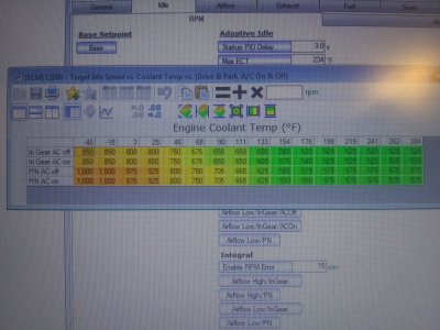

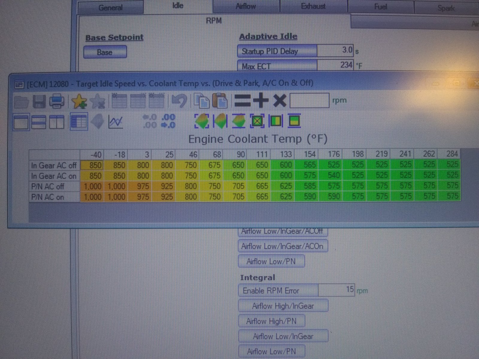

ya normal operation is between 500-600, they may have made it 500 on purpose, unless it is having trouble staying running then you should be fine with it like that. If it ever starts to die on you idling or won't idle correctly then you may need to clean the throttle body, maf, iac, new air filter. throwing in some injector cleaner on a regular basis helps too.

I'll check oneof my 03+ tunes later but I think the DBW is about 50-75 rpms more
