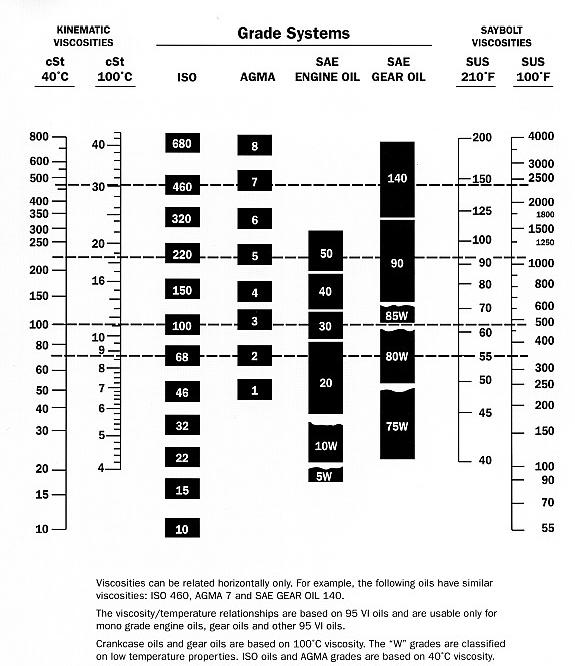

I'd run some STP (thick type oil additive until you find the problem though
Smulvey585
Jul 31, 2024
I just changed to 15-50 Mobil 1
It’s warm weather now.
The startup psi=52
The warm running is + 30 psi
No more ticking in startup
I have a 6.2. 2014 98,000 miles with the AFM intact.
