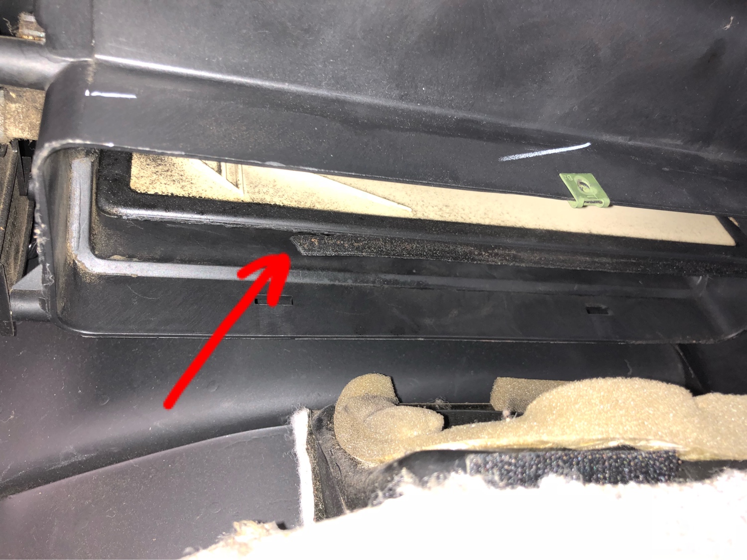

There is a damper at the floor ducts that rotates depending on the vent selection (floor, panel, defrost). As the seal wears, some air will leak by into the floor duct. This shot is looking up from the floor with the floor outlet housing removed in my 98. I’d guess that it’s the same for a 95. The seal is torn in mine, but I doubt that it was ever intended to be 100% airtight to begin with.
To access, remove the screw on the floor vent and wiggle it loose. It has two clips in the back.

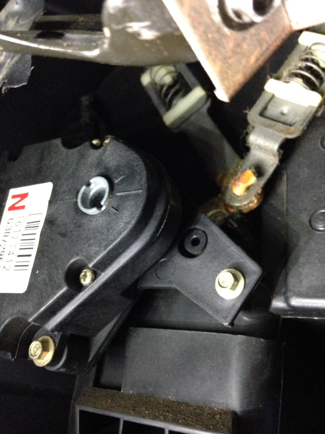

Yeah that doesn’t make much sense. It shouldn’t matter if the compressor is engaged or not, so I wonder if there’s something going on in the head unit that is making the actuator adjust when the a/c button is pressed.
To test, watch the silver dial on the mode actuator by the gas pedal and press the a/c button. If it begins to rotate and the linkages adjust, then I’d say it’s something in the control panel.

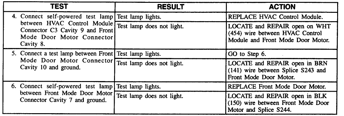

Starting to sound like a bad panel. A quick check could rule it out by testing the mode actuator by the gas pedal.
This for a 98, but it may be close enough to a 95 to help, particularly when looking for the signal from the control panel to the white wire at the actuator connector. I believe 95 may have used a different connector at the panel.
Thanks again for the detailed info. I actually went ahead and ordered the part yesterday. I'm planning on putting it in this week, will report back. All symptoms point to a bad control unit.
