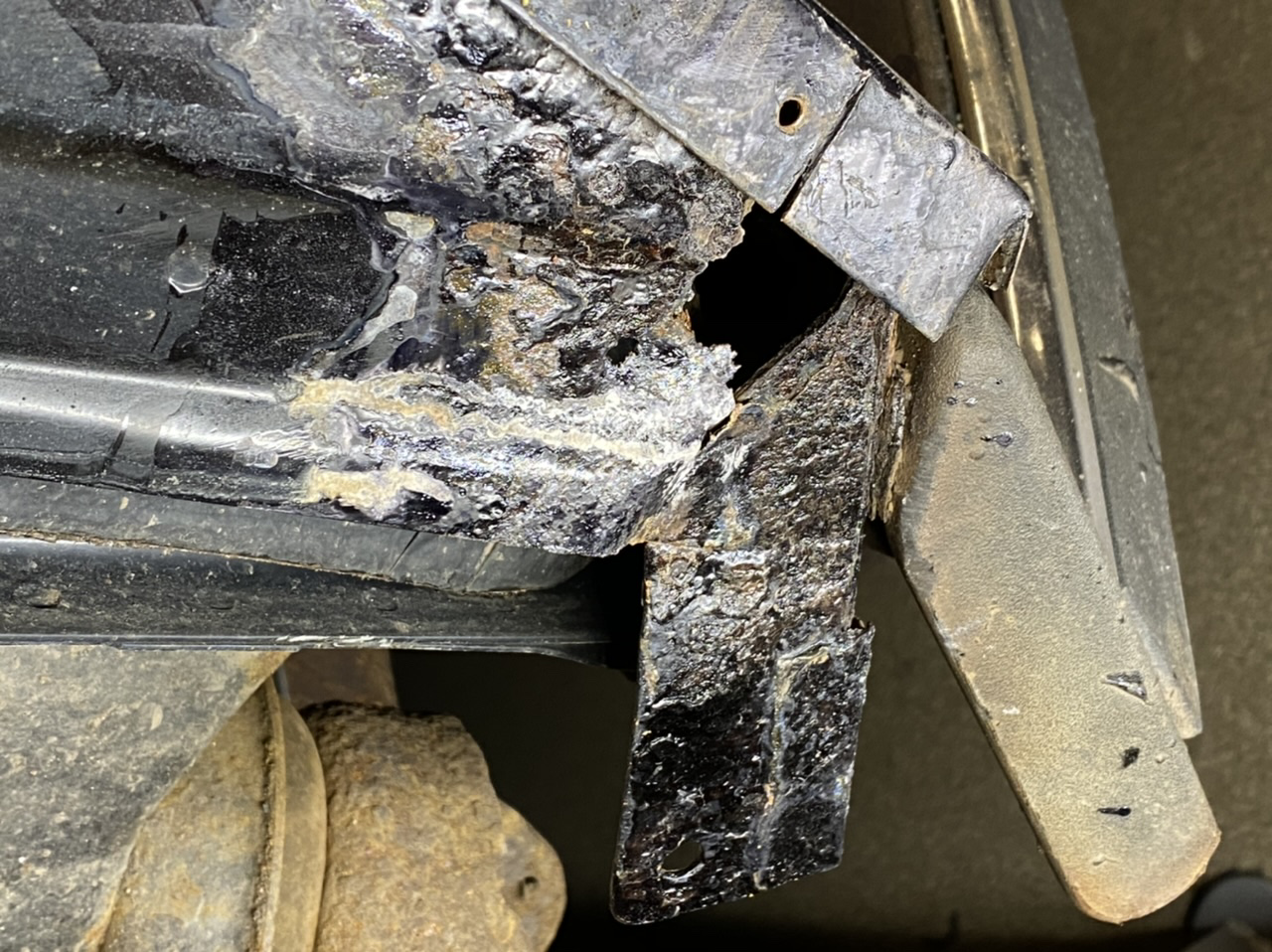

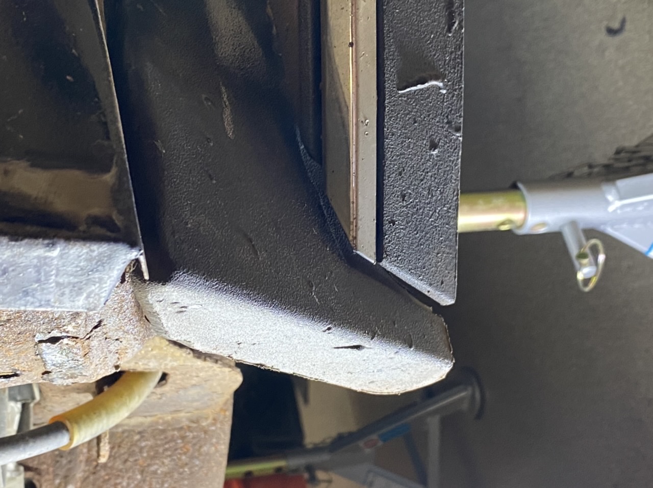

Decided to do the NorCal fender mod found here...
https://norcaltruck.com/2007-5-2013-chevy-gm-large-fender-mod
Rust was my friend for this mod as no cutting was needed! o_O
Before:
I simply pulled the bottom out first and then pounded it back to the pinch weld (will be getting new fenders sometime and didn’t want to waste too much time cutting and bending the pinch weld).
After:
Next, I took a Sawzall to the running board...
I thought it would have been solid. I’ll simply place a backer rod in there and caulk it up. Easy peezy. Just gained about 1” of clearance. When I get my new fenders I’ll go ahead and cut the pinch weld to gain 2” of clearance.

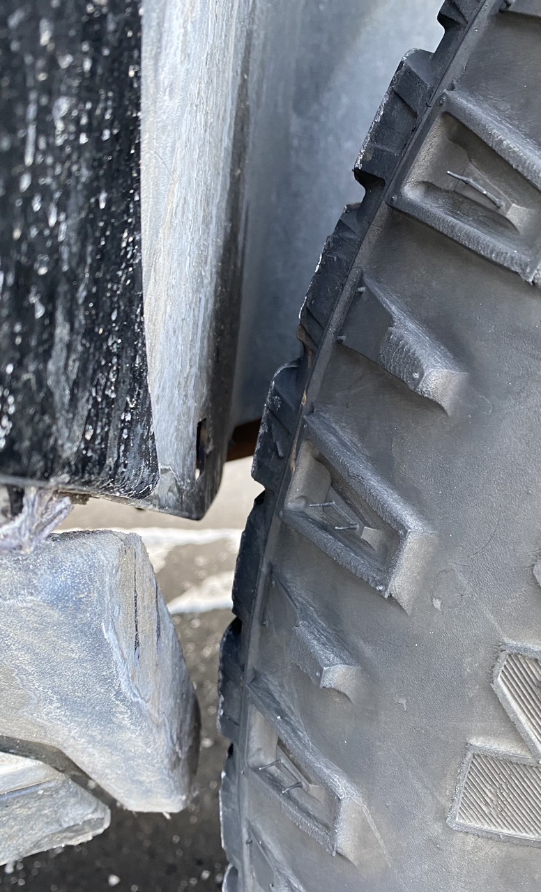

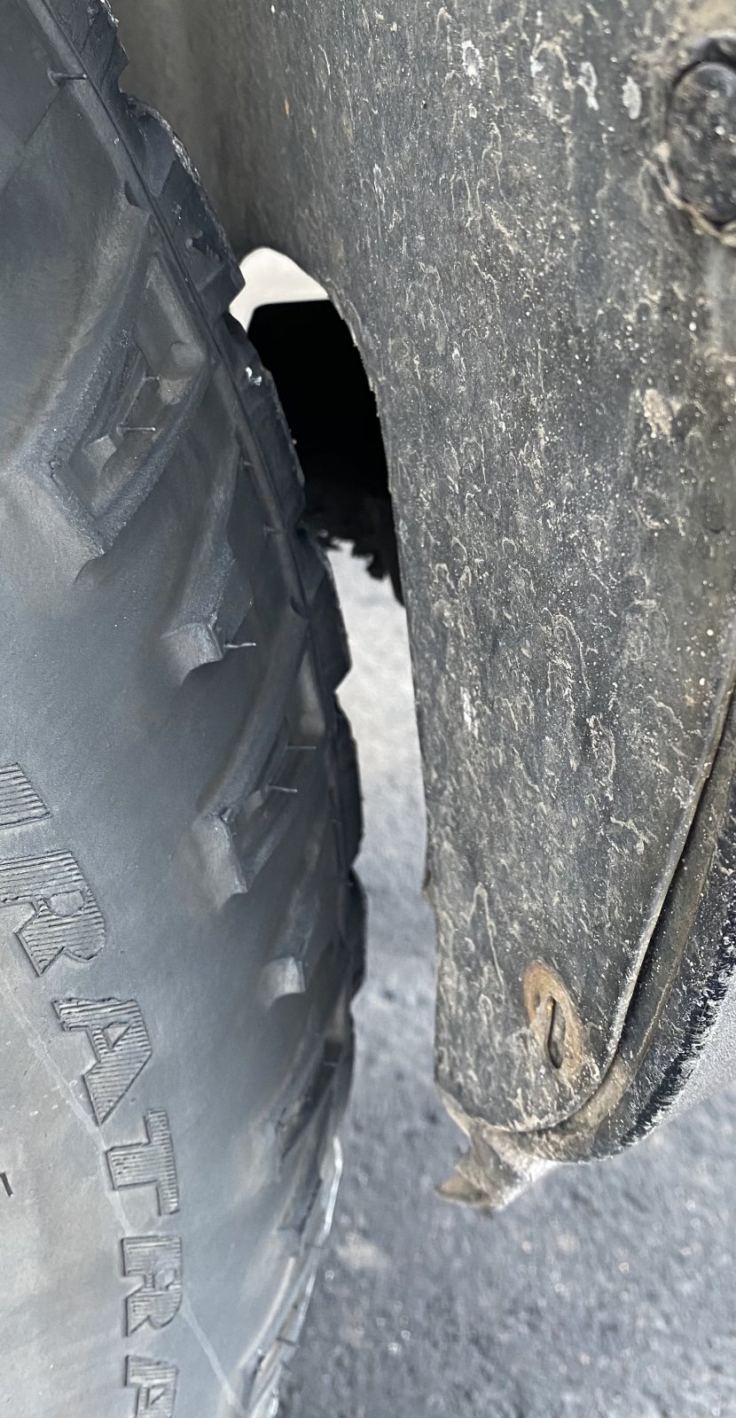

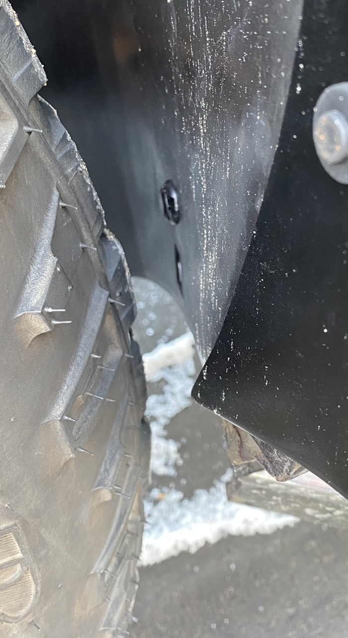

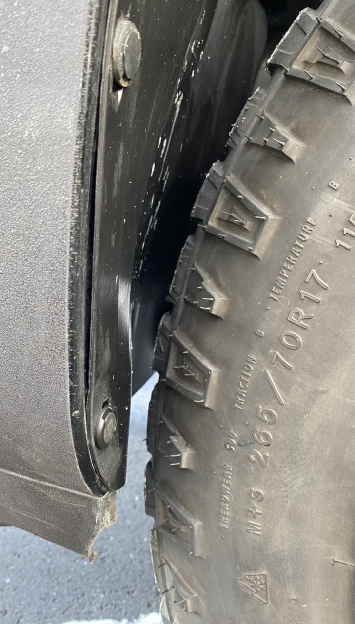

Alrighty...here are some before and after pics of the NorCal fender mod...
BEFORE (the dark mark on liner is from tire when I have the suspension articulated and turning)
AFTER (Plenty of room now especially after trimming running board):

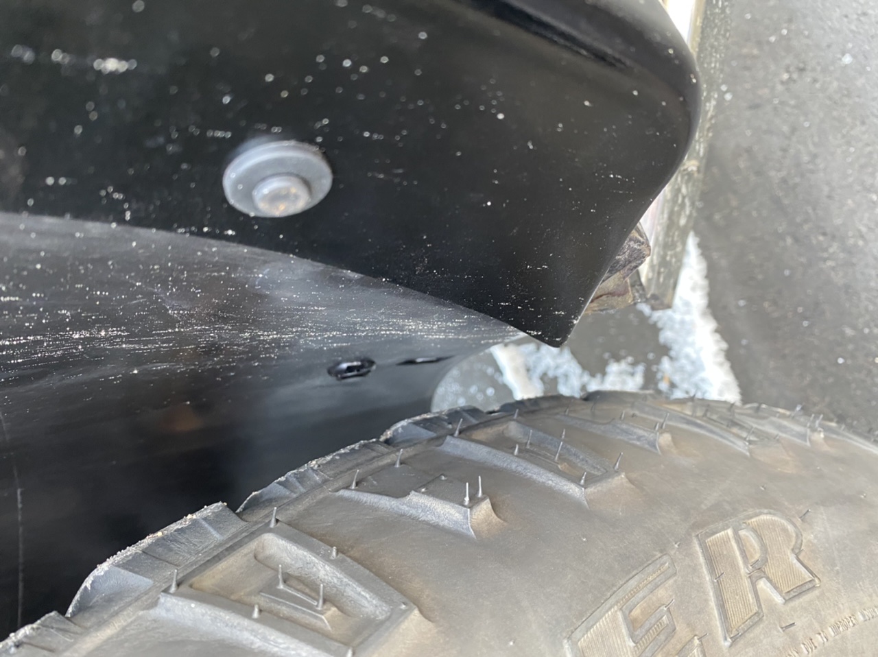

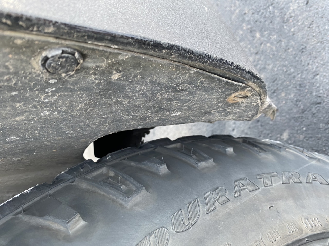

Here is the front....
BEFORE (I simply cut a hole):
AFTER (Ordered new liners after reading a post on here to simply heat it to remold it): 6486A3BF-D21C-4752-88E4-461ABB45498D.jpeg 89CAFFF9-B0A7-40D0-A43F-20F0FBD0A226.jpeg

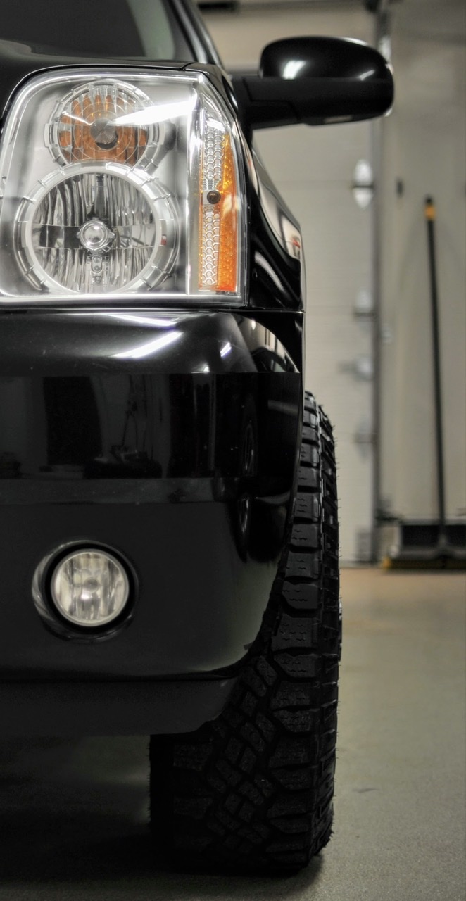

Tire has plenty of clearance now.
Previous picture looks like it would hit, but just the angle of camera as there’s plenty of space!
45,014
Nice! This is on my to-do list one day. It needs to be done before I lower it more.
45,014
What’s your current height? How low ya gonna go?
I don't have my measurements on hand, but it's right at a 3.5" front, 4.5" rear drop. Planning to go to a full 4/5. Currently, it rubs with the wheels at only about 1/2 to 3/4 of their maximum turning angle.
