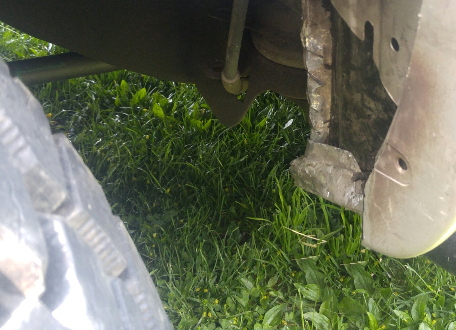

After installing the 1.5" spacers I experienced ALOT more rub with the Cooper 305's,...so heres my mini norcal mod. I watched the YT videos from Custom Offsets and I wouldnt let those guys get within 100 ft of my truck. The hack that they had cutting just plane cut off all the tabs and weld, I took the time to fold them over as to NOT deter from the integrity of the metal and to NOT leave open edges. They basically just cut off all the folds and welds and then painted over it.
I took the time to fold over the tabs and welds.

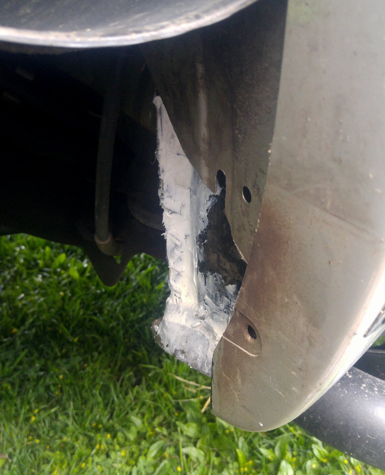

Then I sealed the seams with Marine 3M 4200.

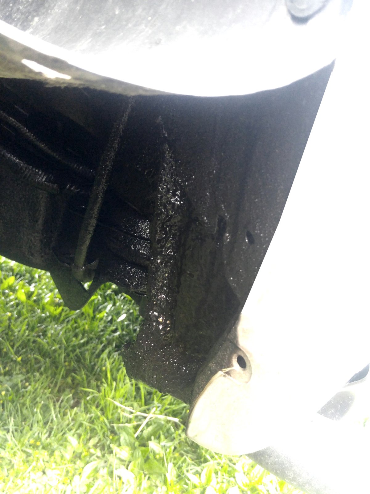

Then sprayed with a heavy coat of Undercoating
Ready for inner fender liner to be put back in place.
