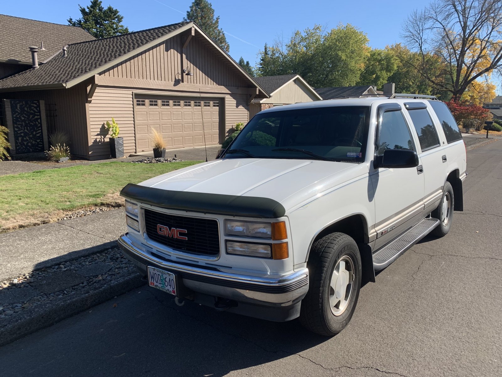

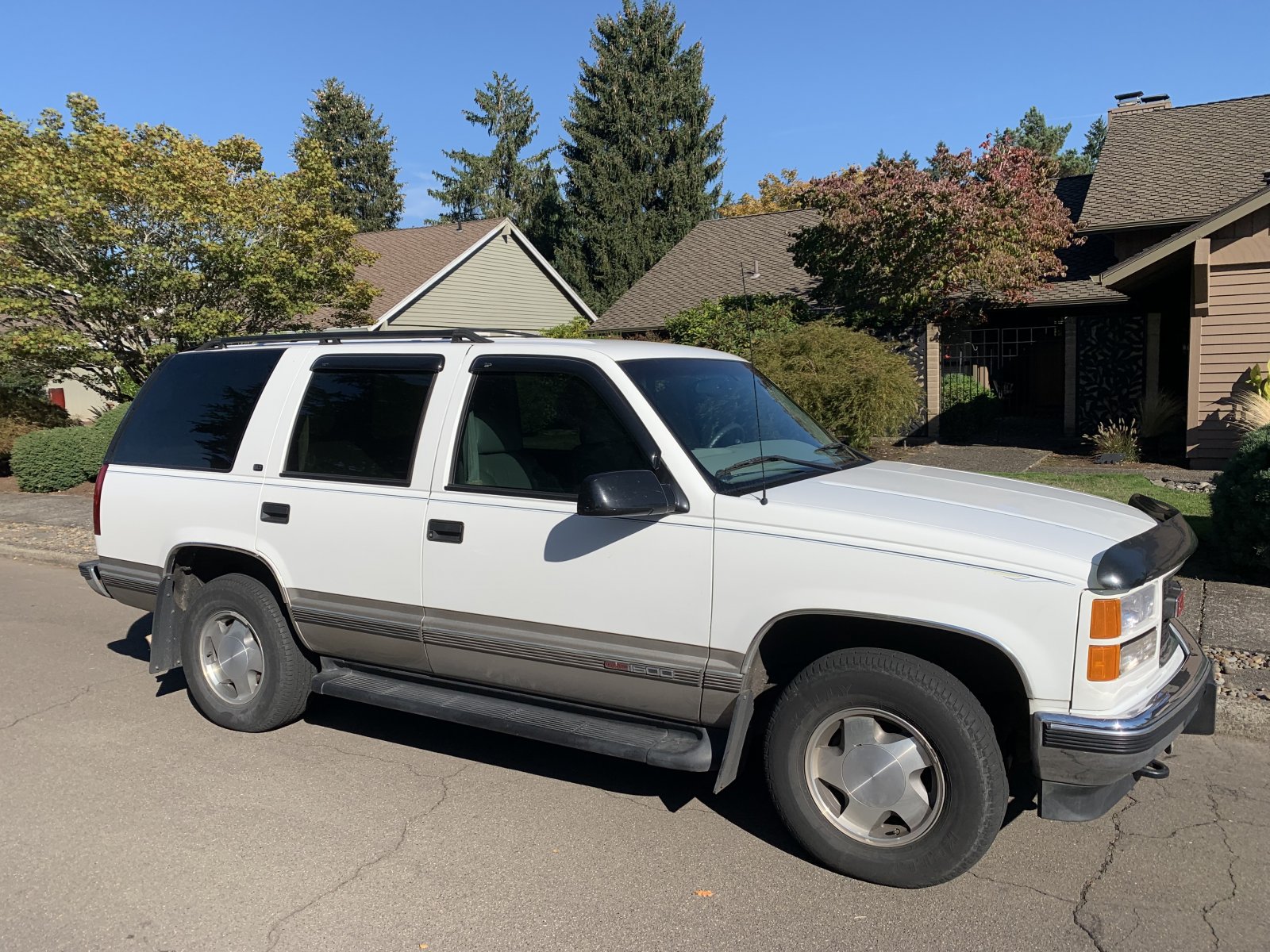

I ended up taking my 1999 Yukon with 65K miled to the dealer and to a local mechanic.
Neither mechanic could hear the sound I was talking about at first.
So I went on test-drives with each of them and pointed out the subtle sound I heard.
I had both of them put it up on the rack and listen with a stethoscope, and they both heard sounds in the transfer case.
Dealer quoted about $4000 to repair with new parts (although some parts are no longer produced).
The independant mechanic said he only heard the transfer case noise in 4WD.
He said it could be from the tires, which are worn, or perhaps valve lifter noise.
He advised no repair at this time but monitor the sound, since I do not drive it in 4WD.
My plan is to get new tires first and see what I hear.
Here are some pictures.
