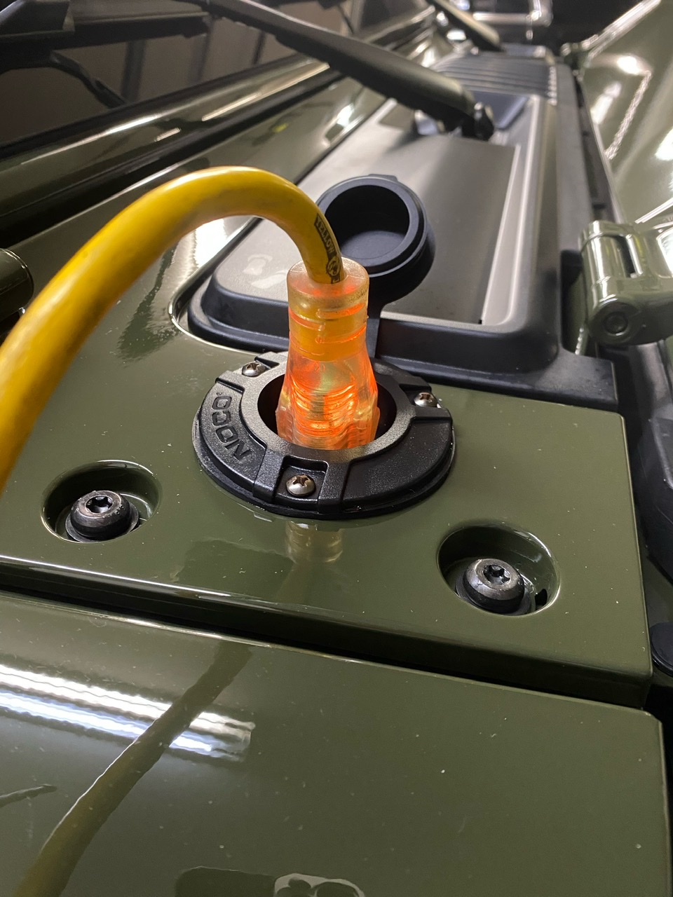

Just wanted to share my recent installation and fitment of the Noco Genius GenPro 10x1 battery tender in my wife’s Yukon. It fits perfectly where the second battery tray is (unless of course you have two batteries ). Be careful with screw length as there is something underneath. I drilled the holes first and felt around with a pick and had to use a shorter screw near the washer reservoir…
There’s just enough cable to reach the battery by going up towards the firewall and across (I wrapped the cable in wire loom and you can follow it up directly on the right side of the master cylinder)…
The Noco GCP1 AC port plug installed nicely in this area with the cables zip tied to other existing cables behind the bumper…
Now…I just need to remember to remove it before pulling out!
Great product, so I did the same to my Jeep…

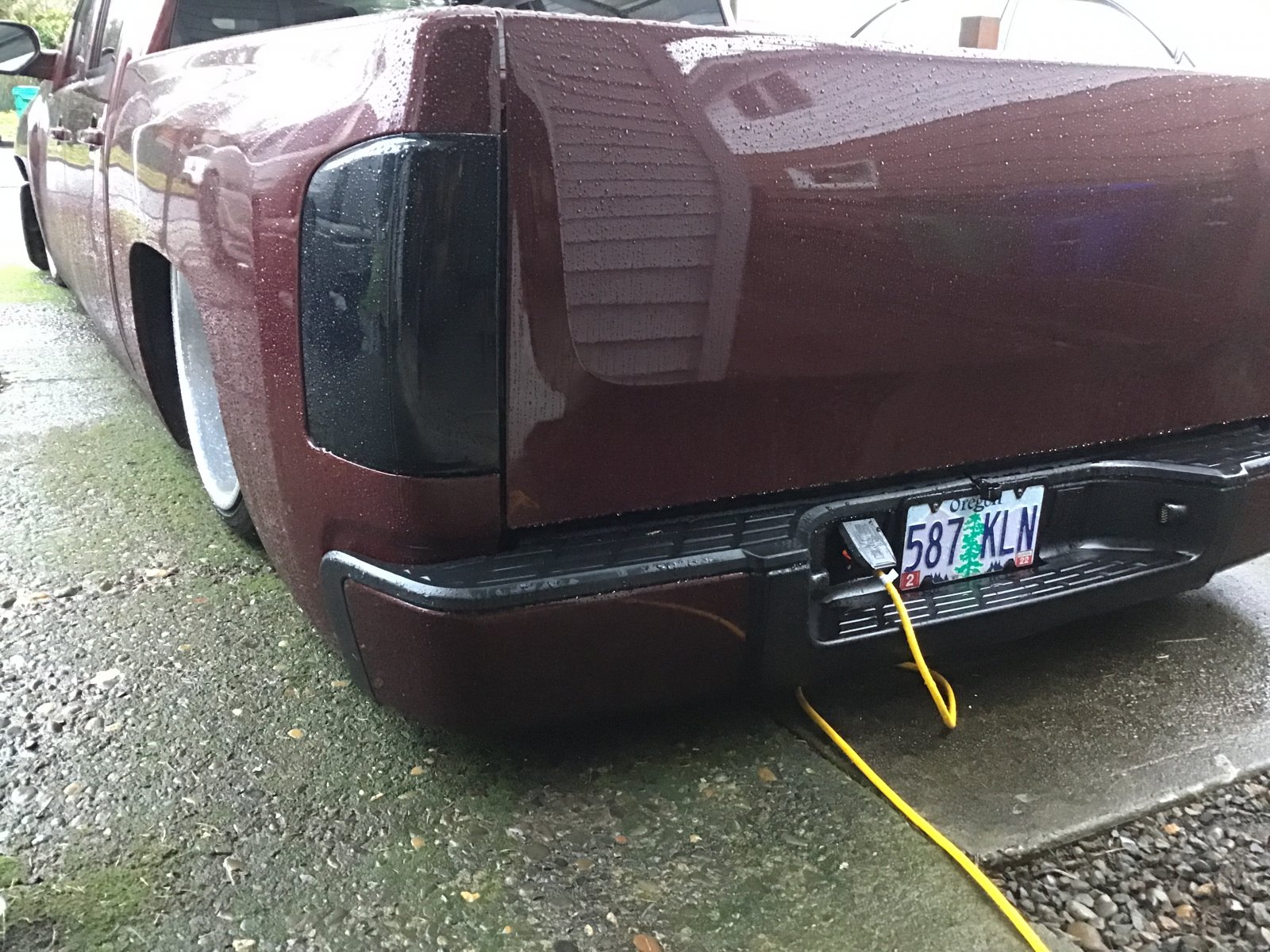

Nice. I have a Noco installed in my 08 Silverado and since it’s not set up for towing, I used the factory trailer light harness to mount the receptacle and ran a wire to the front. I like their charger because I can set it to AGM and it remembers the setting.
