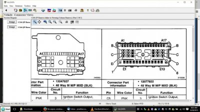

remove cover from bottom of steering column to see the huge harness from column. it runs into a big connector under the dash. it will be the biggest brown wire going to that connector. Cavity D6.
