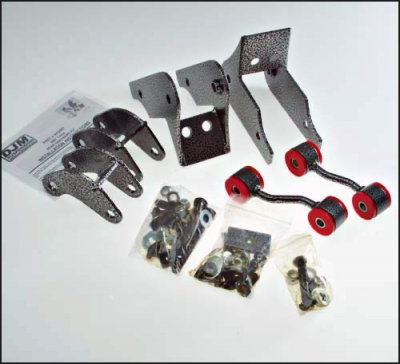

You probably need some offset end links from DJM. They relocate the sway bar towards the passenger side by about an inch so it doesn’t hit on the panhard bar bracket. They’re in this pic of a kit but you don’t need all of this, just the end links. Contact DJM or Tony aka @NORCAL SS . Your truck will handle like shit around the corners without a swaybar, and the bigger the better.

Already have that kit and yes it’s installed properly. Like I said I’m not the first person to run into this problem with a big static drop in the rear

You didn’t mention already relocating the sway bar. Just trying to help. Plenty of people run a 6” rear drop without the sway bar hitting things. Why not just pull it off and see what happens though? That should take you 15 minutes and you can see for yourself.
