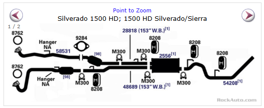

Studying the parts catalog and comparing to the chart...
The Great David Vizard said:
"Once the available flow exceeds about 2.2 cfm per hp, the gains possible by increasing muffler capacity drop to less than 1 percent."
… 2.2 cfm per horsepower …
A 2.75” Single is good for a 310hp engine with zero loss …
A 3.00” Single is good for a 370hp engine with zero loss …
(Why would the numbers for a 3.25" single be absent?)
A 3.50” Single is good for a 503hp engine with zero loss …
A 4.00” Single is good for a 657hp engine with zero loss …
However, each side of a Dual system only needs to flow 1.1cfm per horse, so …
A 2.25” Dual is good for a 457hp engine with zero loss …
A 2.50” Dual is good for a 513hp engine with zero loss …
(Why would the numbers for a 2.75" dual be absent?)
A 3.00” Dual is good for a 812hp engine with zero loss …

Looks like the heavy half GMT800. That is the 1/2 ton that came with 6.0L had dual exhaust going back into a single muffler. This is what I called Gibson about and they said they didn't have anything like that.
I have the section of this exhaust in my attic. I could only immediately in front of the muffler back. When the junkyard pulled the motor they cut it there and I couldn't get the rest of it. I pulled it off a 2004 Escalade... I think only one year had this exhaust. Not sure why they dropped it?
Anybody fiddled with it?

Don't know how big those pipes are, but I'd bet their bends are not terribly restrictive.
Also I'd be hesitant (but not summarily opposed) to modernize the exhaust, for fear of moving the cats closer to the engine
Forced to guess, GM's pipes are SLIGHTLY undersized, but the 2-into-1 muffler is where the most power can be released.
In other words, instead of replacing the entire exhaust system, just improve the muffler & tailpipe(s?).
Or, consider the 8.1L 2500 exhaust system?

@exp500 I was curious about that. My C5 Corvette has a cross over pipe while the new corvette looks like it has the chamber mentioned in David Vizard's video (he mentioned them using his concept).
As for our trucks, I kind of wondered if there was something inside the muffler acting a bit like a cross over. Even on the dual exhaust it comes back to a single muffler.
Another thing that I notice cannot be good, is the volume on the passenger side bank (down pipe to collector) is much larger to cross to the passenger side frame rail. They didn't do anything to balance out the volume and I'm not sure why (maybe the harmonics are still tuned ~ wavelength works?). I'd have thought they'd have enlarged the cross over a bit to balance the flow idk?

In the 70's and 80's there was alot about the crossover pipe effect on scavenging.
Proper size and placement was difficult especially on 4x4's.
My C5 Corvette has a crossover pipe while the new corvette looks like it has the chamber mentioned in David Vizard's video (he mentioned them using his concept).
As for our trucks, I kind of wondered if there was something inside the muffler acting a bit like a crossover. Even on the dual exhaust it comes back to a single muffler.
LT1 Caprice enthusiasts took note that the Ford Crown Victoria started using an h-pipe crossover, and started experimenting with h- & x-pipe crossovers,
although there are obvious limitations as to where the crossover can be placed to leave enough room for driveshaft droop.
The Holden Caprice basically uses a 2-in,2-out oval body muffler AS A CROSSOVER (that can neither be called an h- or x-pipe).
Another thing that I notice cannot be good, is the volume on the passenger side bank (downpipe to collector) is much larger to cross to the passenger side frame rail.
If both pipes are of the same internal diameter / 'cross section', the longer pipe will sing a lower note when air flows through it compared to the shorter one,
but neither has an inherent flow RATE advantage (without harmonics tuning somewhere else).

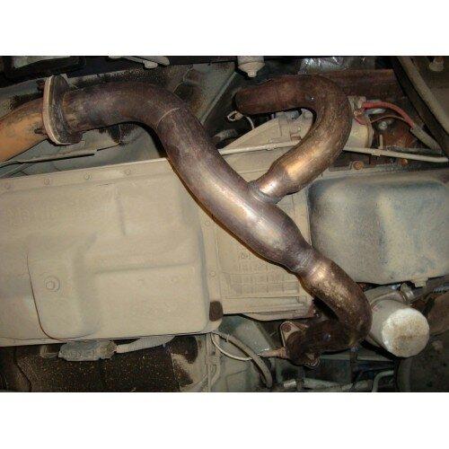

Want to be baffled by engineering masterpieces? Ford v10 exhaust in the super duty trucks.... View attachment 466711off of the manifolds 2.5 inches, reduced to 2 inches, before entering a 3 inch pipe going back to the rest of the exhaust.
Looks like somebody tried it! I was curious, looks hard to make even for the factory. What year super duty is that off of? I looked up a 2005 F-250 and didn't see that cross pipe. Dang that's wild!
My GUESS: improve low-RpM power at the expense of / to discourage or prevent high-RpM use?
Maybe?
