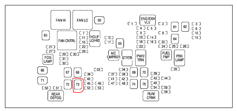

No fans running AT ALL.
I havent checked the rear AC. (What does it mean if it is and/or isn't?)
And I havrnt checked the fuses (you dont by any chance know which one(s) it might be? I'm at work (and was on break at the time sweating my @ss off)
Underhood fuse block, check J-case fuse #73. And download the owner's manual from GM's web site.
