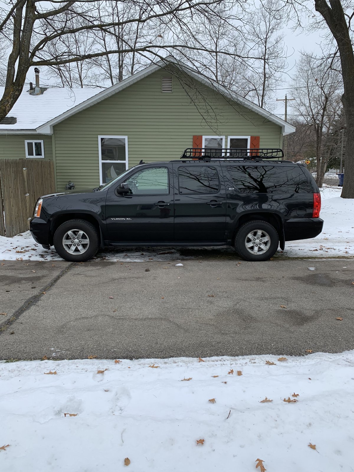

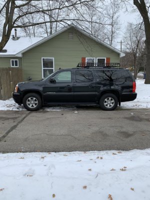

43278066-78C2-408C-BFD4-01E5DC7198BB.jpeg 7694FFBF-6A45-4F59-9E90-6C50282BC9B0.jpeg

Pretty sure my suspension is pretty plane jane.
Yes, same as mine, nice and simple!
However, you said that you bought this to tow with and she has 3.08 gears according to the RPO Sheet (GU4). How much weight do you plan to pull? These gears and the lack of the Enhanced Cooling Package limit your Yukon to a 5000 pound towing limit.
Back to the rear suspension. I think the bags in the springs are all you're going to need, if that. Roof rack looks good and mud flaps are on my "to do" list, they'll help save the paint with these AT tires.
