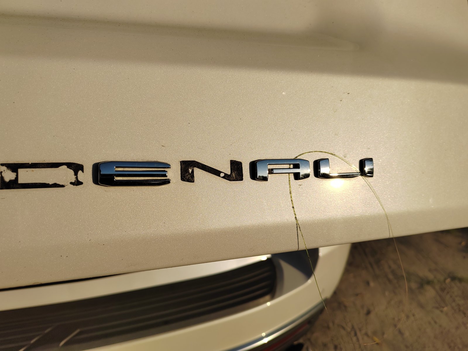

Fishing line and a heat gun go along ways to remove emblems. Just don't get too close with the heat so you don't cook things. A little goes a long way.

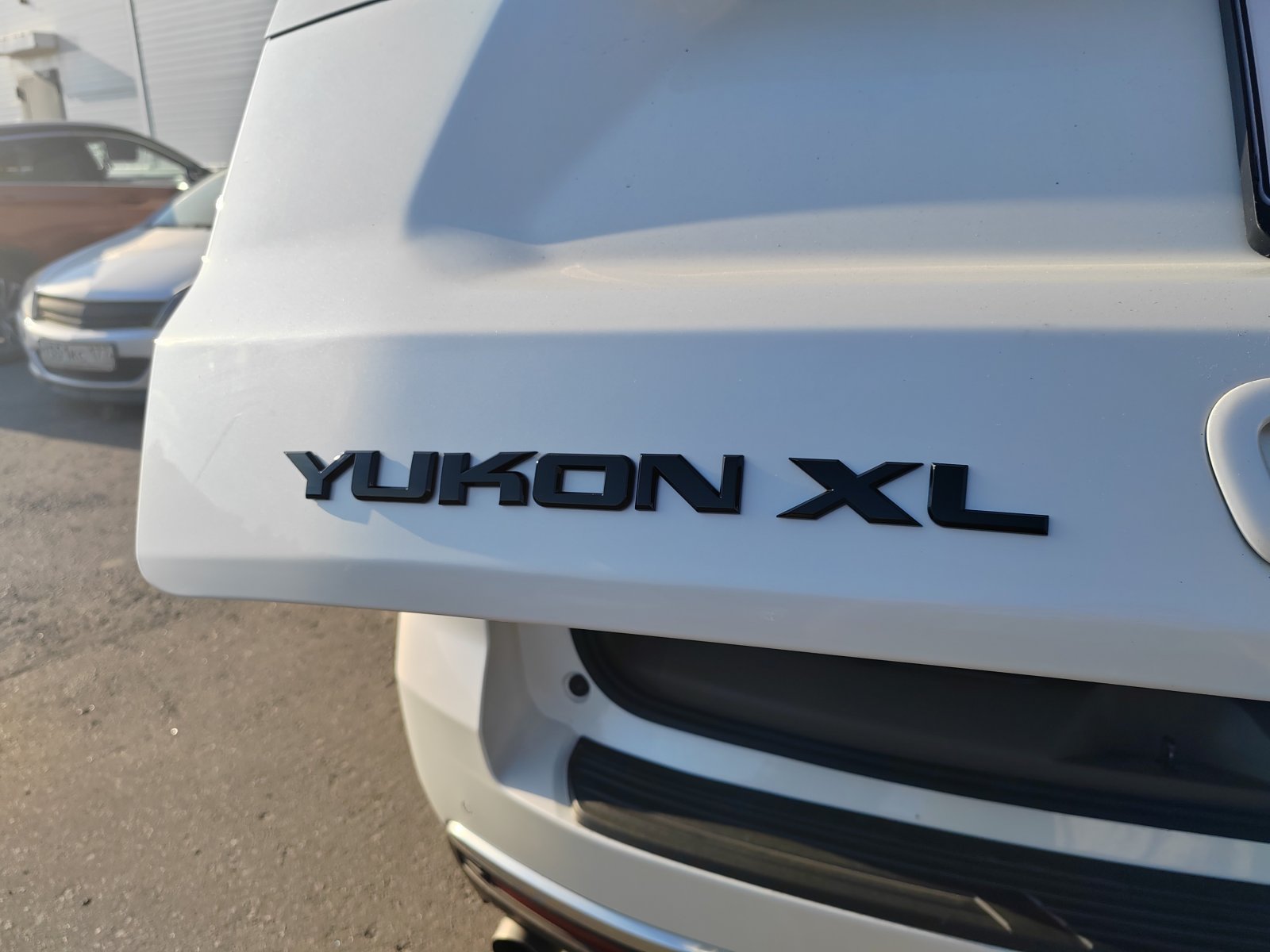

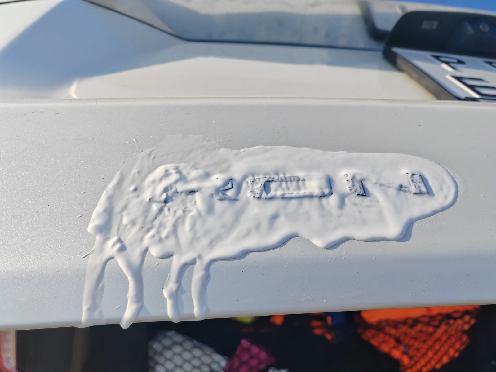

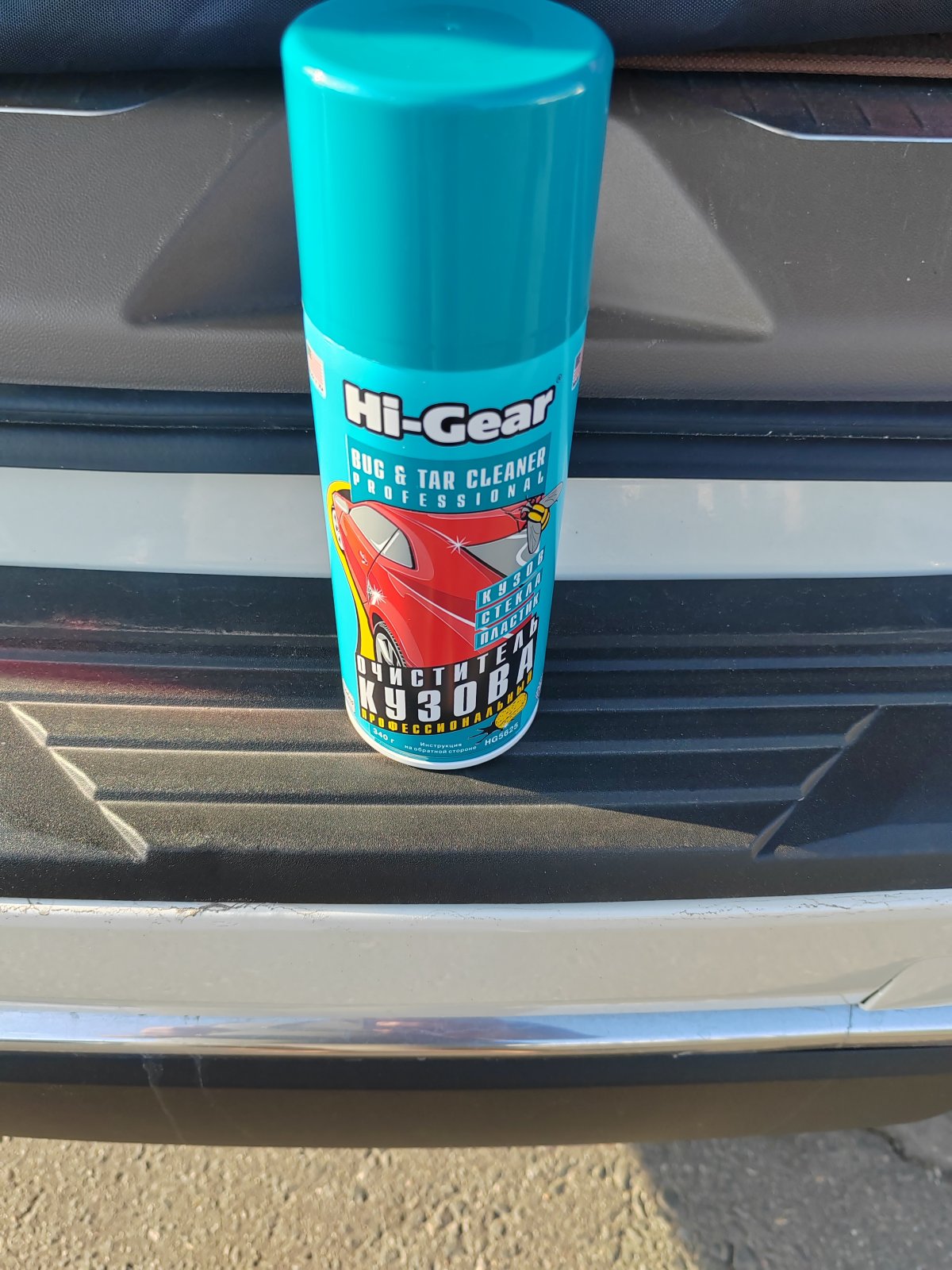

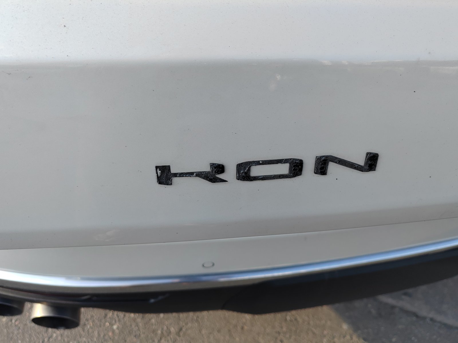

I changed all the emblems on the back to black. Can be changed easily with a fishing line and body cleaner
