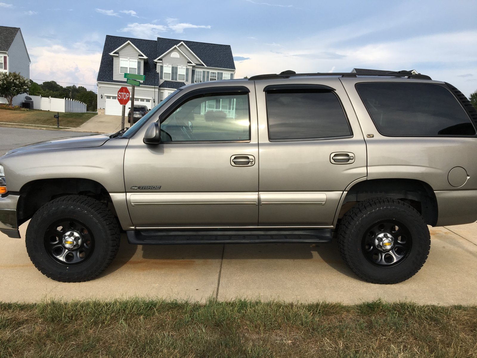

Nearly a year ago I put on Bilstein 5100's, Z71 springs with 2" lift blocks, and aftermarket torsion keys, in addition to replacing the upper control arms and lower ball joints. I also bought a set of steelies from a GMC, but couldn't justify spending the $$$ on new tires until I absolutely needed them, so I rode around with it jacked up on the stock alloys and 245/75-16 tires.
Last week I finally ordered the tires - Falken Wildpeak AT3 in 285/70-17, painted the wheels, and got them installed along with an alignment. After all the suspension work last year I got it aligned at Mr Tire (never going there again) but they must not have tightened the upper mounts enough because I eventually got negative camber on both front wheels real bad. Now with the new wheels, tires, and proper alignment, she rides like a dream.
I found a set of bowtie center cap stickers on eBay, but I can't decide if I should leave the GMC ones on there. I kind of like the look of the black center with red letters, but the silver Chevy ones have some pop to them.
Tell me what you think:
GMC:
Chevy:

Thanks all. I just stuck the Chevy emblems on with tape for the pic. I’ll probably go ahead and put them on for good....when I feel like doing it. More importantly, when it comes to aesthetics anyway, I really need to paint my rusty ass calipers.
