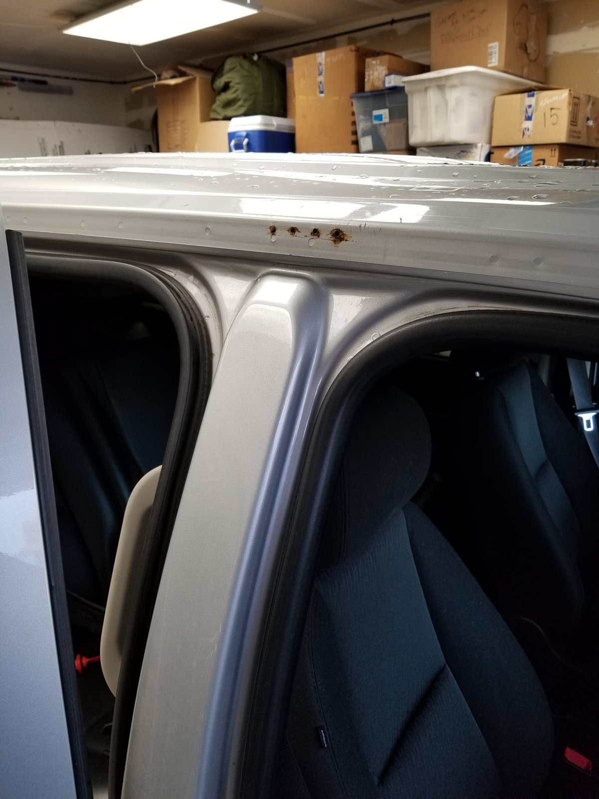

Found some hidden holes in my roof today that can't be seen until the drip moulding is removed. Hopefully this helps someone track down a leak.
Looks like a light bar was mounted here.

Thanks for posting @LanceD I have the same on my '14 PPV so I just cleaned them up and taped over with Gorilla Tape. Truck's black so it looks quite 'OEM'. :favorites37:

Oh yea I forgot to tell you about them holes. I just filled mine with clear RTV, sorry. Thanks Lance for showing this, of course, them holes were there for roof light bar, Now would be a great, time to add a led light bar for some off road use. or just to look cool, cuz the switch and wiring is already in the roof/upper console.

Thanks for posting Lance, I'm going to go check to see if mine has these.
I have noticed moisture on my floors but could not pin point where it was coming from.
